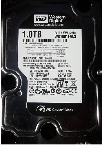

Hi there, should be any problem with replacing the head stack for Western Digital 1TB?
(head stack re alignment?)
My drive model- WD1001FALS 20_june_2008. Just purchased a similar HDD
(same model 08_july_2008) in order to take the head stack from.
thanks for any info.

Thanks for the warning. I still thinking of DIY. Therefore I bought a similar drives in order to test the alignment issue. I used this link http://hddguru.com/articles/2006.02.17- ... k-Q-and-A/. I aware to the fact that this is a very serious thing to do (it's my hard drive). Does any one have an experience dealing with such a drive?
thanks.

hilk wrote:
With all the respect, are you all refer only to the alignment issue?
No. this case is difficult for anyone without proper tools and experience. The alignment complicates things further, but is not the primary reason it will not work.
hilk wrote:
Has some of you have an experience (even a bad one) with this specific drive?
Yes, I have had both good and bad experiences, even with the right tools equipment and skills which is why you, with minimal experience and tools, should attempt it.
hilk wrote:
as far as I concerned, you need a clean room in case that you are intending to use this drive for long time, but for recovery purposes you have to have a clean environment. I going to trash this drive after opening and recovery.
Before you try anything you should do the following lookup the distance between the media surface and the recording head when in operation, then find out how small this is in comparison to dust, debris, hair etc, then consider the consequences of any contamination, even if you are planning on trashing the disk.
If you want your data back, then DIY simply isnt an option.

hilk wrote:
Thanks anyway Hddguy, I appreciate your concern and things you wrote , I will be happy for any technical tips. G'day.
This drive is a beast.
It is a challenge for perfectly skilled pros as well.
Trust me, you have no chance.
Only open your drive, if you are allready accepted, your data is lost forever, and you want to have fun with it....
If your data is valuable, seek for professional help. (you need good luck on this one too, because not all the dr companies can recover this drive!)
If you want, i can help, but not remotely....
