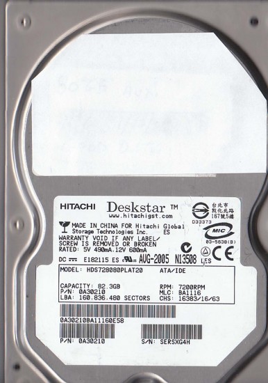

I have a Hitachi Deskstar 80 gb ATA hard drive that is physically damaged in that 2 or more of the pin contacts are broken, I suspect there is useful data stored. I have tried to make repairs without success and my question is if I were to buy another HDD of the same make and model could I swap the PCB so that it could be accessed?

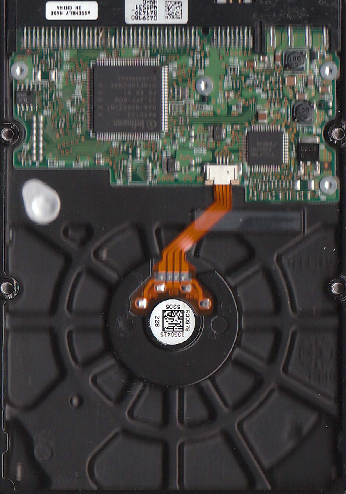

A straight board swap won't work. You need to transfer the NVRAM, or its contents, to the donor PCB.
If you upload a photo, one of us will identify the component for you.

NVRAM swap *AND* match rom version (match first two lines of the sticker on the ata connector)

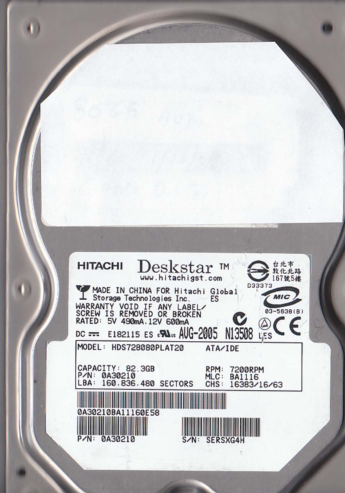

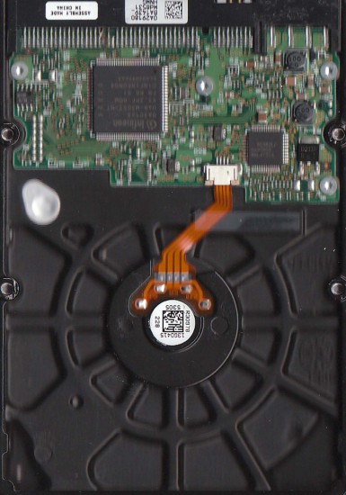

It looks like the chance of finding an exact match is pretty remote maybe my best option is to find a data recovery expert, any suggestions there? Attached are pictures.
Thanks for all, Bob

I would cut the conductors for the damaged pins from your IDE cable, and then hardwire them to your PCB. Should be very easy for someone with soldering experience.

The simple solution is to replace the broken pins if that is the only damage.
