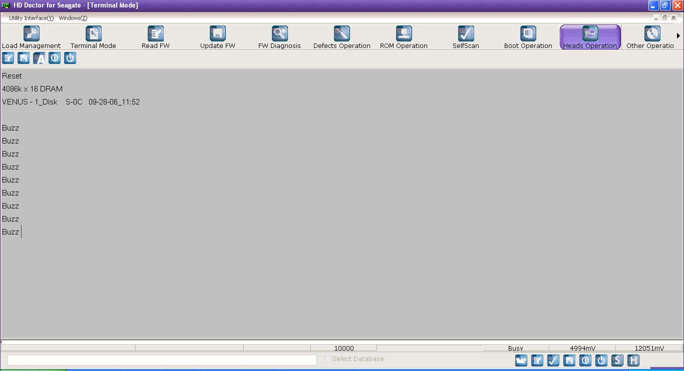

i need help to solve this error
thx

No Clicks?

no clicks

motor or stiction probably. 'BUZZ' is seen during spindle start
