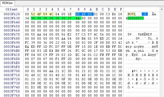

Hello guys I need help in with a compatible ata module (0011) for a wd2500aajs-75m0a0.
Thanks!

You need to be much more specific.
What actual version of mod 11 do you need?
I.e. to be compatible with which version ROM?

pcimage is right we need the version ...
if you can't check SA modules check ROM file at module 4F as in the picture (the green)

Firmware version is 000100CS.
Thanks!
