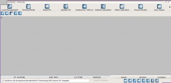

hi everybody
I have this case Barracuda 7200.11 ST31500341AS when connected to HDD doctor and power on it make a few clicks and stop spinning and wrongly show ready status also wrong Model, firmware and LBA see Picture
and in terminal mode I cannot access any command
I short the pcb with tweezers but nothing
maybe some buddy has change PCB or ROM Chip?
any suggestion ??
thanks

Bad heads

Spildit wrote:
+ 1 for Bad heads.
At any rate i think that it should output terminal LOG if PCB/ROM were ok ...
I well swap heads and tell you what happing
thx
