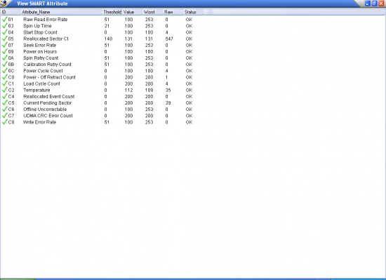

WD2500AAJB-00WGA0
DCM: HHRCNTJMAN
PCB:2060-701494-001

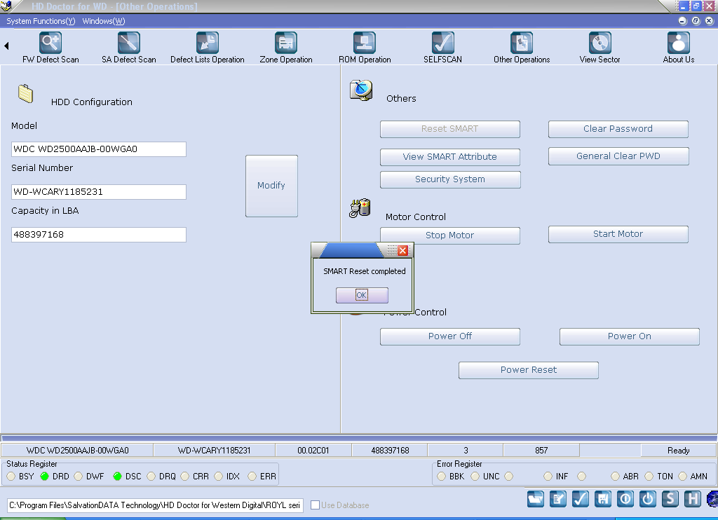

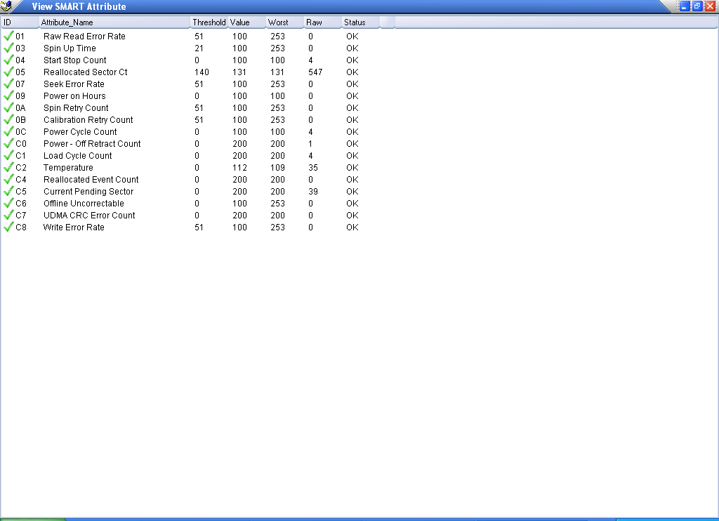

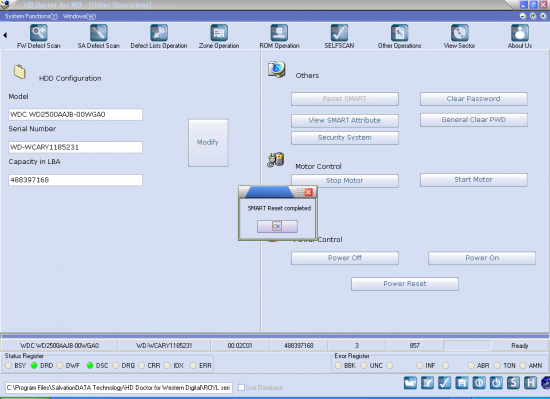

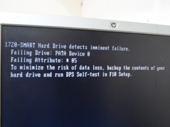

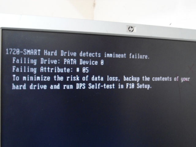

I have SMART ERROR in hdd.
I have completed the SMART ERROR REMOVAL PROCESS using HD DOCTOR FOR WD (as shown in figure).
But the problem remain same.
What i do to remove this error.

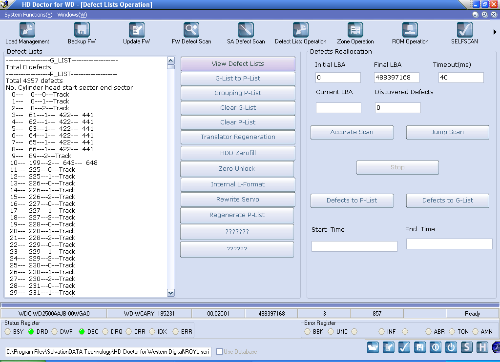

How is your G list ?

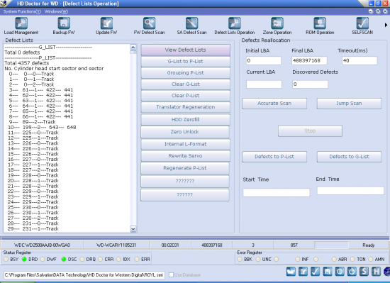

CHECK THIS ONE
