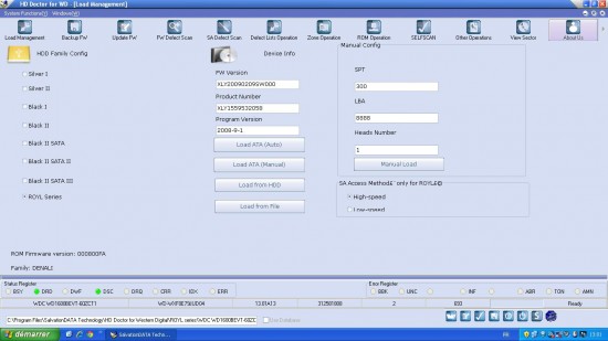

I have to unlock a WD hdd shown in image1

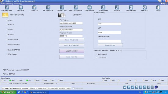

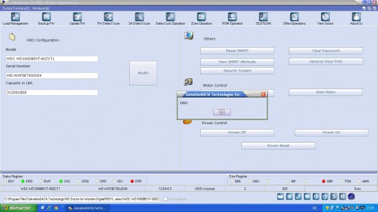

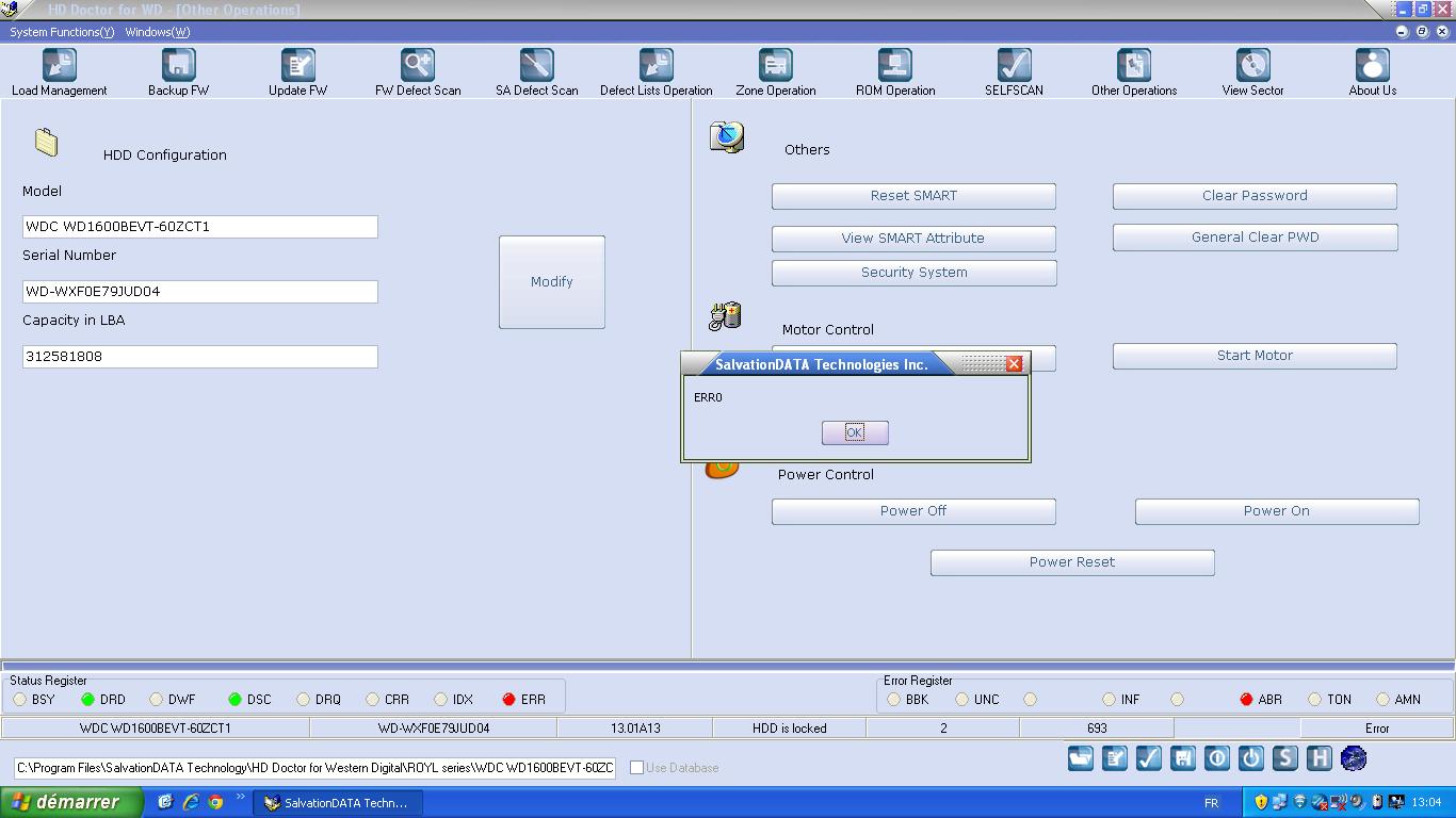

the general clear pswd button return an error message like image 3

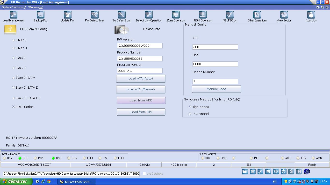

i use clear password button and its unlocked like image2
but when i power off and on the hdd remains unlocked

wd doctor can't unlock this drive

I don't know if your model is one of those that disables SA access when a password is set, but if it is, then one possible way to gain access is to use a compatible PCB with the wrong adaptives, or flash the existing PCB with a non-native ROM image. Then you will be able to gain access to the SA in low speed mode.
