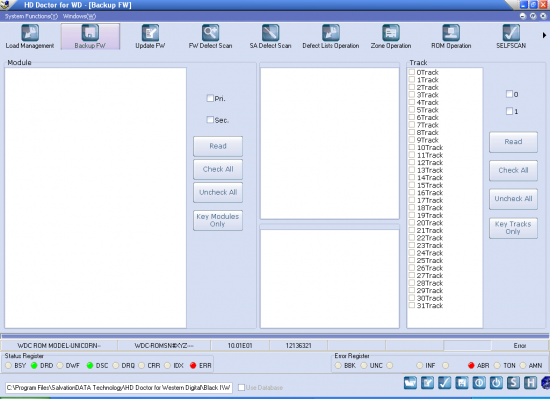

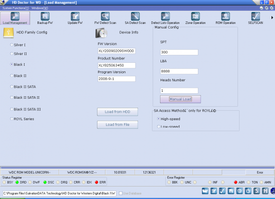

dear friend
MDL:WD800JD=00MSA1
DCM:HSBANTJCA
PCB:2060-701335-005
wd hard disk clicking wrong serial number
how can i solve this problem.

It is loading into kernel mode. To fix, it will be based on the cause of the issue:
1. PCB is the cause - reprogram replacement PCB with ROM
2. Translator - fix the translator
3. Heads - replace the heads
4. Surface damage in SA - try a smart hot swap
As you are asking the question, I have to assume that you don't have the facilities, equipment or experience to deal with these issues. So, you are better off outsourcing to a lab who is able and willing to do the work for you at a discounted price. Most labs give 10-20% re-seller discounts.
