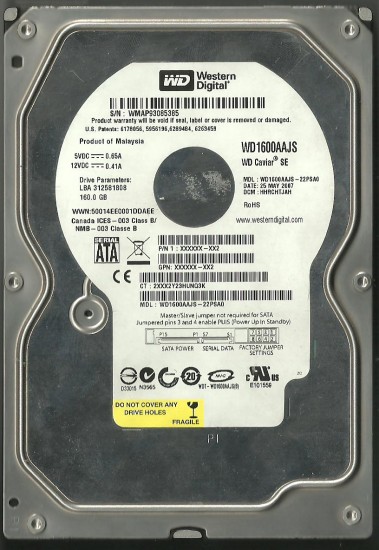

July 1st, 2012, 6:21
Hi
I need firmware for this drive :
WD1600AAJS-22PSA0
fw ver: 05.06H05
there is picture as well:
thx

September 5th, 2013, 13:46
I need for SD dear.
According to client info, he ran HDD Regenerator to the drive for 2 days.
Now the drive is not detecting.
I see the drive comes READY in doctor, Error while LOAD FROM HDD.
I need to have resource to load from file, then will clear g-list (i think G-list is overflown because of HDD Regenerator)

You can convert the FW to SD.
Re: Firmware Needed WD1600AAJS-22PSA0
September 6th, 2013, 12:41
pclab wrote:You can convert the FW to SD.
modules can be converted but the RES (loader?)?
I need res to get access to SA.
