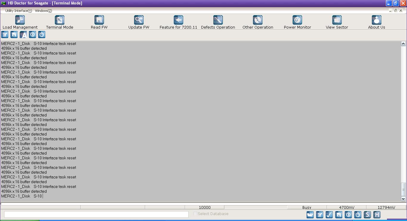

Hi
I want to repair the lba 0 as shown in the salvationdata procedure,
I spin down, remove twezeer and spin up ok
but when i want to reset smart oups i receive the LED: 000000CC error
how to solve?
In Some cases of repair, i have a spin up error efter removing tweezers, what does means?
Thank you

It s a ST9120820AS fw 8.04
thank you
 Post subject: Re: ST lba 0 error
PostPosted: July 11th, 2013, 15:40
It just keeps repeating that?
Try new PCB. (Transfer rom)
PostPosted: July 25th, 2013, 1:34
Posts: 1079
Location: canada
had same error and issue turned out to be a headstack fail.
replace headstack and works fine now
if swapping the rom over then that your issue for sure
