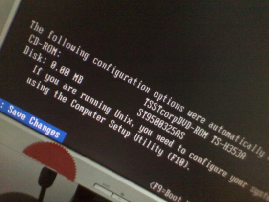

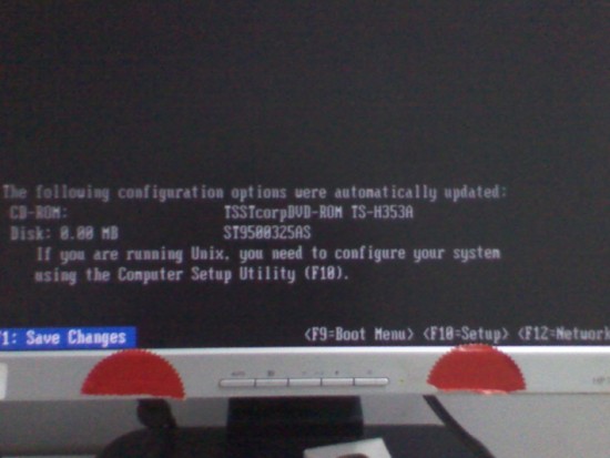

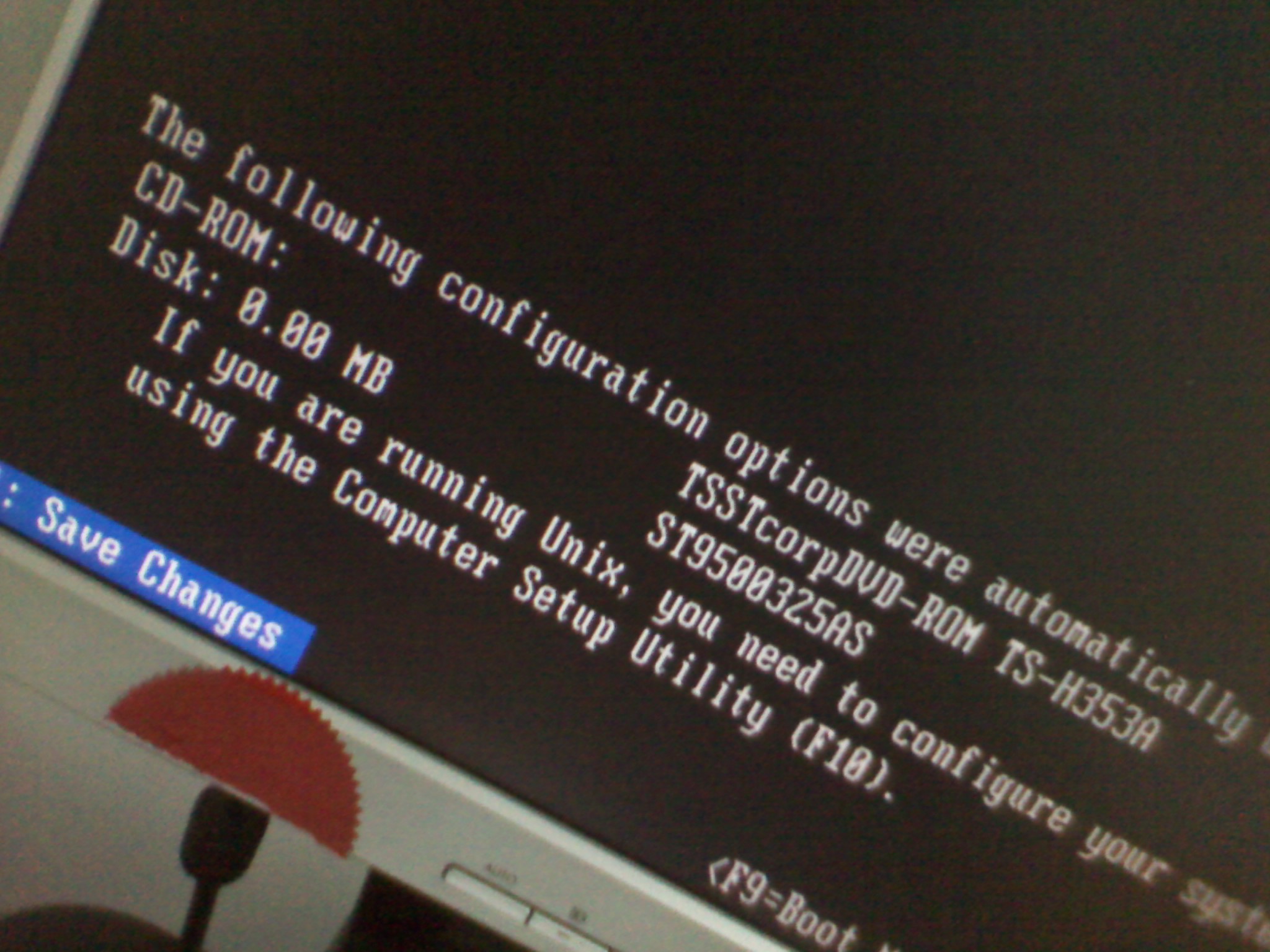

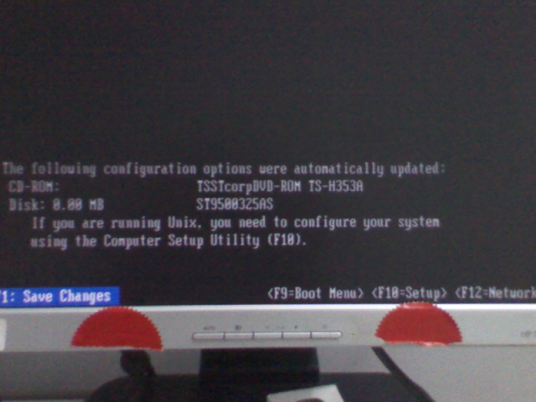

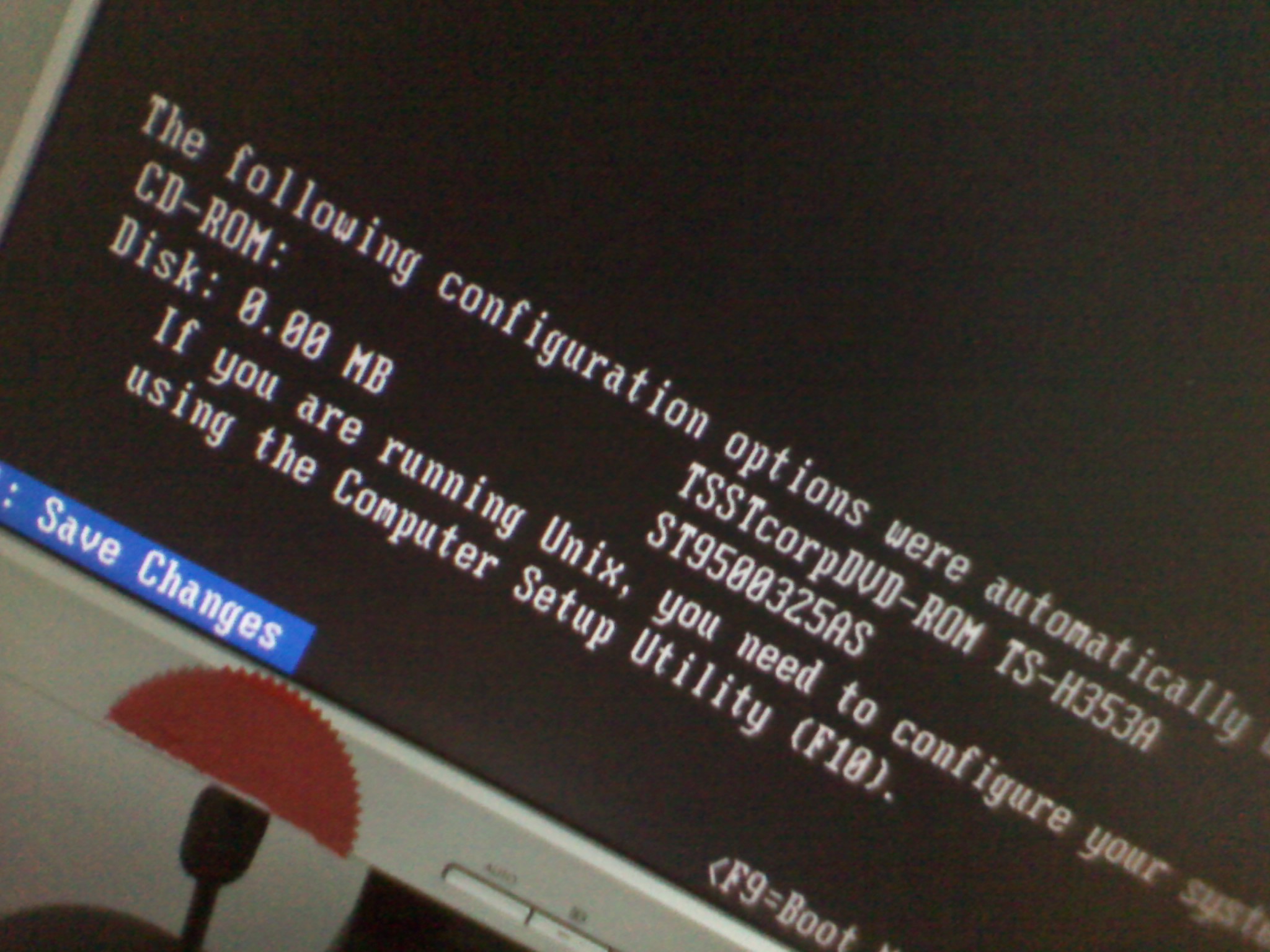

during booting up of the computer is when i see that message

My hdd is detected 0MB
File comment: PICTURE1
File comment: PICTURE 2
File comment: PICTURE 3

AFAICT, when a drive reports a capacity of 0 LBAs, this usually indicates an internal problem, possibly a firmware fault. That's assuming that the drive hasn't powered up in standby.
I would start with the WD drive(s) and attempt to dump their resources (ROM and SA firmware) using a tool such as the demo version of SeDiv.
http://sediv2008.narod.ru/Easy3.9Passwo ... 567890.rar
In the case of the Seagate, I would connect to the drive's serial diagnostic port and examine the output. You would need a TTL adapter. The HDD Oracle forum has several examples.
