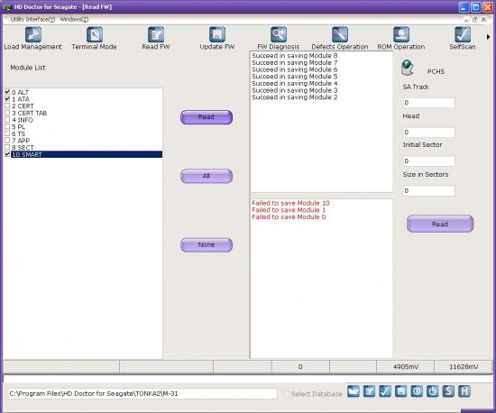

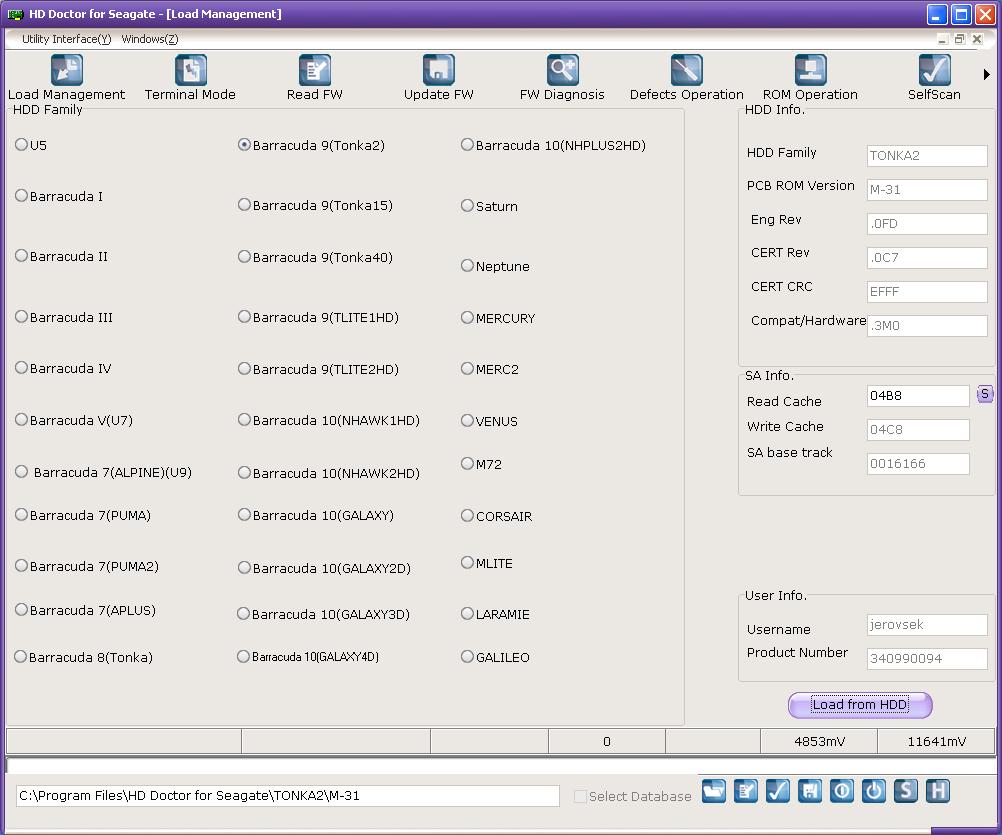

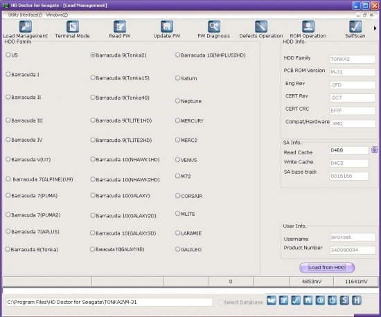

who to fix this drive to be ready for datarecovery.
Drive is without status (BUSY, ERROR or READY)
File comment: load from HDD

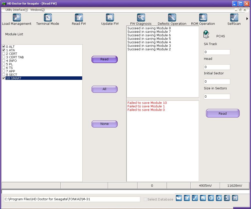

File comment: read FW

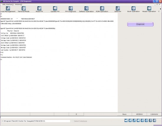

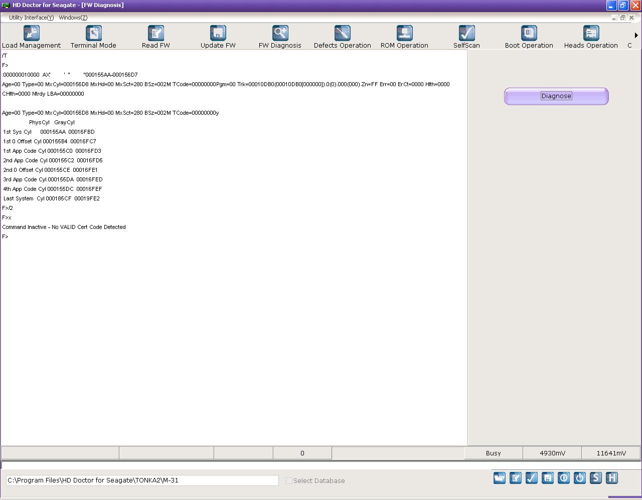

File comment: fw diagnosis

I see that you can't reach T level, it stays on F level.
Are you sure the pcb is a native one?

PCB is native.
I replace heads from donor drive to patient.
In terminal if I pres ctrl+Z I can get T level.
Interface task reset
1024k x 16 SDRAM
TONKA2 - 1_Disk M-31 03-22-06 10:53
Buzz - Head Mask FFFF - Head Mask FFFF - Switch to full int.
Spin Ready
(P)PATA Reset
T>Age=50 Type=3F MxCyl=2127E MxHd=0 MxSct=000 BSz=002M TCode=03000000 ThermFlts=0000
T>Pgm=00 Trk=00000(16166:00[16FBD]).0(0).000(000) Zn=0 Err=00 ErCt=0000 Hlth=0018 CHlth=0000 Ready LBA=00000323
T>((VALID Cert Disk Code Detected - Revision # .0C7
T>y
PhysCyl GrayCyl
1st Sys Cyl 00016166 00016FBD
1st 0 Offset Cyl 00016170 00016FC7
1st App Code Cyl 0001617C 00016FD3
2nd App Code Cyl 0001617E 00016FD5
2nd 0 Offset Cyl 0001618A 00016FE1
3rd App Code Cyl 00016196 00016FED
4th App Code Cyl 00016198 00016FEF
1st Adaptive Cyl 0001619A 00016FF1
1st UsrDfect Cyl 0001619C 00016FF3
1st Alt Pool Cyl 000161A4 00016FFB
2nd UsrDfect Cyl 000161C2 00017019
1st CertCode Cyl 000161CA 00017021
1st IntfCode Cyl 000161CE 00017025
1st Intf Sys Cyl 000161D2 00017029
1st Cert Log Cyl 00016202 00017059
1st Decay Cyl 0001626E 000170C5
1st SPLASH Cyl 00016288 000170DF
Last System Cyl 00016293 000170EA
T>V1
User Slip Defect List
Num Entries = 01F5 Checksum = E79C
Hd 0 Span
00000.0.000 000
000B4.0.000 5AC
00241.0.4E2 006
00242.0.4E2 006

hmmm sorry then, i really don't know, i'm not a pro!
I see that some mods are not readable, maybe drive has bad sectors on SA ?
Smart is one of those bad mods, you could try to reset it with N1 command and see if that will fix mod 10, but it might be dangerous if SA ha bad sectors.
It's better to wait some pro suggestion
