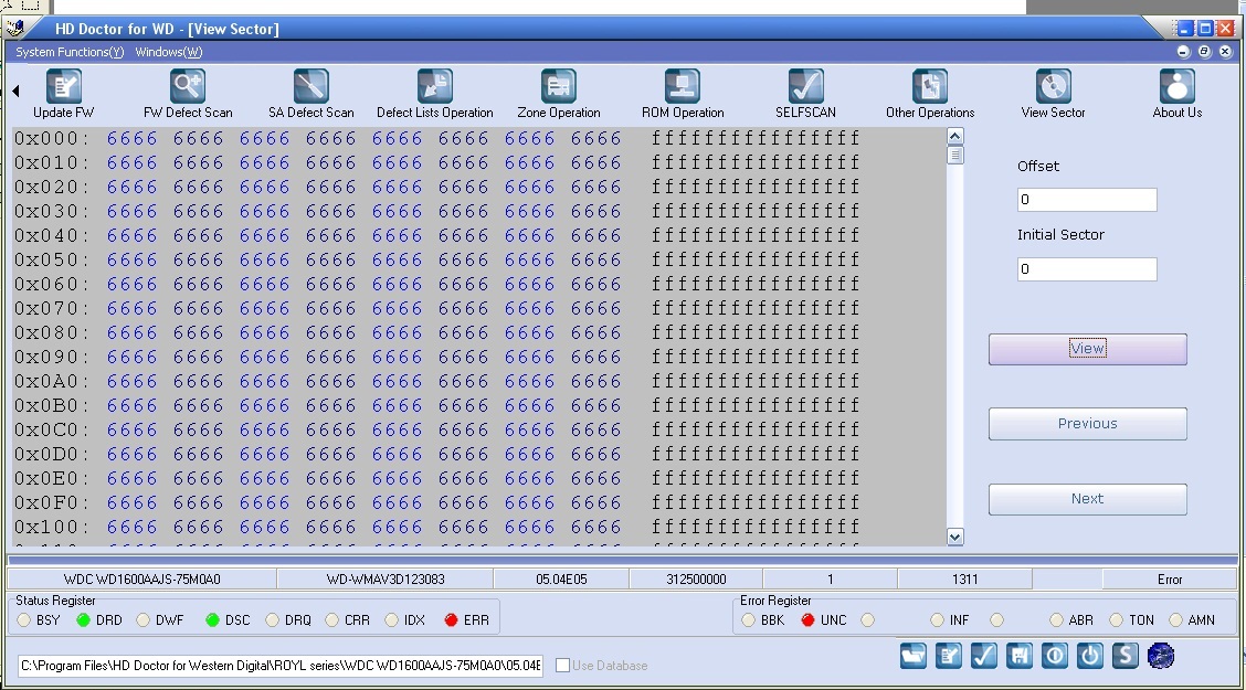

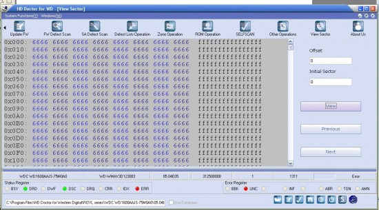

Hi
I got wd 1600aajs-75mqa0 data not show.
What i did : I checked all moduls are ok and translator regenaration ok (completed).
View sector see pic.
Pls your advice to access the data .

Read ROM and write it back,
hope it will help

I genarated the ROM from modules .
Head test id ok.
Any advice ?

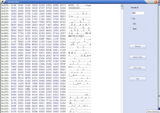

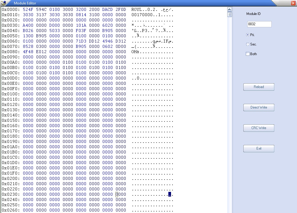

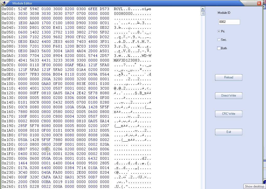

can you post MOD 02 and 32 here ?
Data Recovery Pakistan
 Post subject: Re: wd 1600aajs-75mqa0 data not show
PostPosted: June 11th, 2015, 4:29
Joined: December 27th, 2008, 5:02
Posts: 162
Mod 2& 32

i'm sorry to tell you, but when someone ask to upload some file/s you don't upload them as a screen shot you upload them as a file

Verry sorry miss anderstand.Pls find the attachment files.
