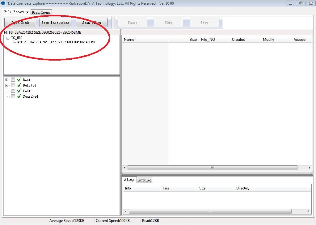

i'm doing some experiments with datacompass tool and i'm stuck on a strange issue.
I knew that the size limit of datacompass is 2TB but if i connect any drives bigger than 500gb i can see only a drive recognized as 465GB also from windows administration tools, it seems a driver limitation.
Any ideas?

What i still don't understand is this :
livetheenergy wrote:
(...)also from windows administration tools (...)
Is this some sort of option inside Data Compass or is this related to mounting the drive using data compass ? Because if it's related to plug the drive to windows OS and only see that size even on 1 or 2 TB drives then it's not normal at all.
Hello !
I dont think so.
This one is a 3 TB @ DC.
Regards.

Hi guys, i was away, there are some quirks with the datacompass tool. I've tried more drives with DC, these are 1TB or 2TB but DC sees only the first 465 (or 500GB).
If i use a standard usb bridge i can mount the drive correctly and i can see the partition correctly, with DC i cannot see more than 500GB and i don't see the partition.
I'm trying to figure out why this happen.

I've DC, But it Works fine upto 2TB HDD.

I test also on 2TB drive and it Works OK with version 10
press total LBA button and check if it show corresct LBA
