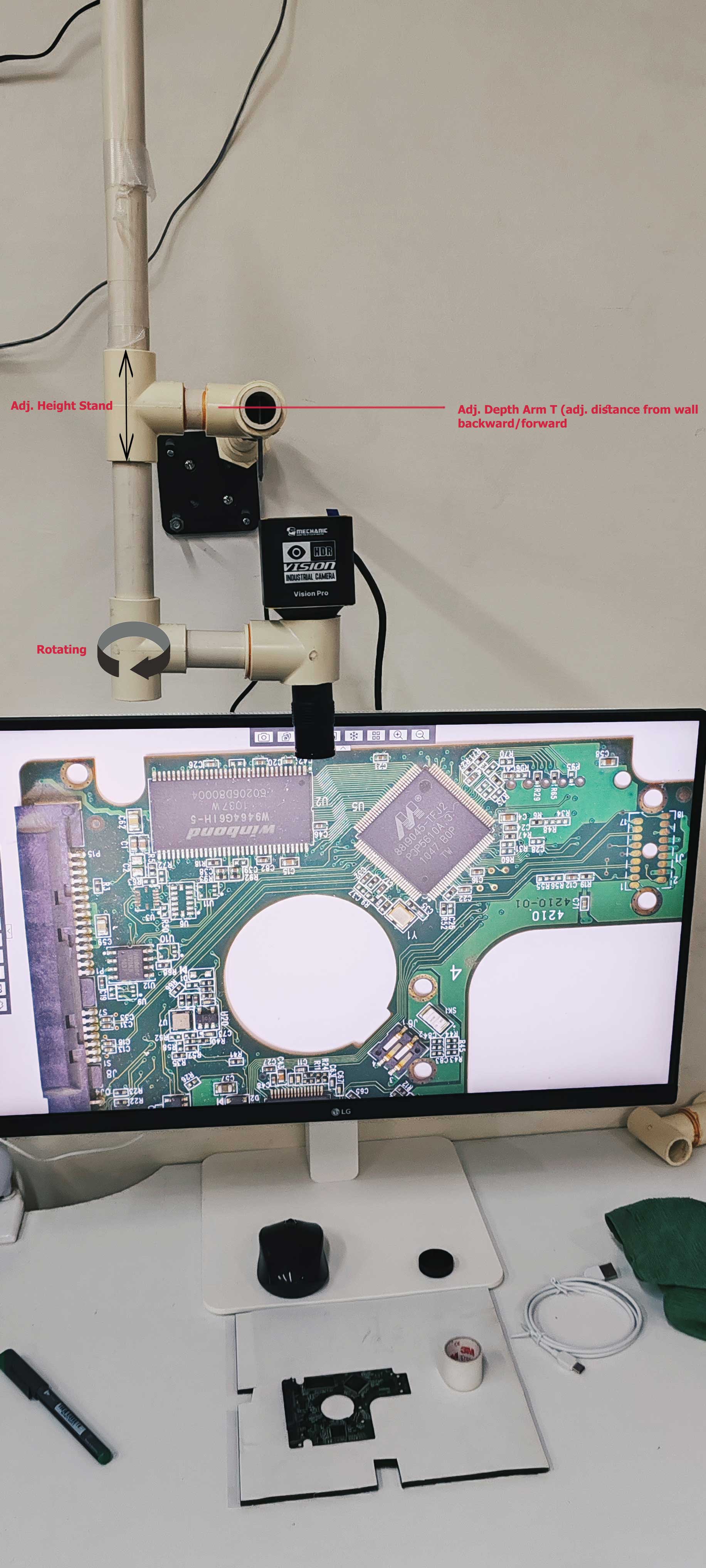

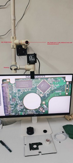

 Post subject: My adjustable microscope stand
PostPosted: Yesterday, 3:49
Posts: 2829
Hello guys...
I would like to share this with you here. maybe one-day you will use it :wink:
to make it much easier, i used this Online builder to make mine https://make.craftyamigo.com/
very simple and costs maybe 15$ and works better than those ready made.
:thankyou:
Note: in order to fix the Adj. Height properly you can use small screw to hold it
MicroscopeStand.jpg [ 427.41 KiB | Viewed 79 times ]
