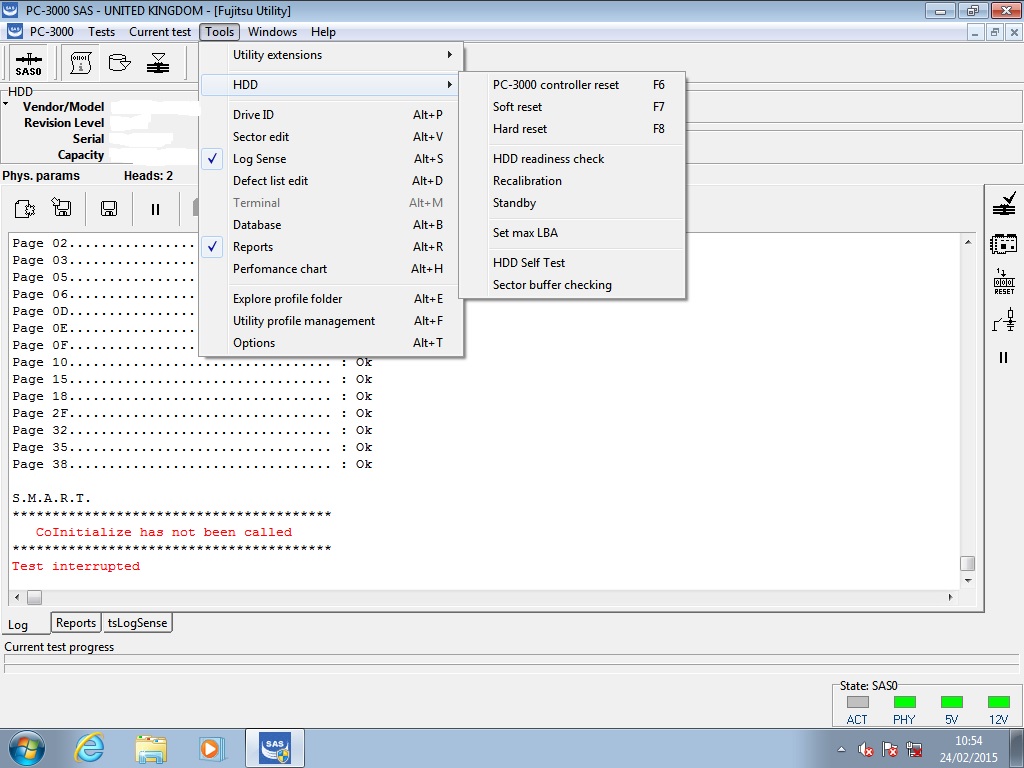

While I use PC-3000 every single day, I must say I've never actually used the SCSI version. You are actually the first person I've talked with who even owns one. It seems that the need doesn't arise all that often to do FW repairs on them beyond a quick translator regeneration on the Seagates (which can be done in plscsi).
Do you see any features related to running a self scan for some models ? I'd assume that usually would clear the G-list list before scanning.

I have seen that function but i haven't used it yet, i have just been trying to get a feel of the software before really trying anything....I am not in work just now but i will give it a try when i return.....there is a function when "formating" to select the extended parameters one of which is to "clear the G-List" but it seems whenever i do this the drive fails about 2 minutes into the test....I am not sure why this happens.....thanks for your reply and i appreciate the advice....i will let you know how i get on......Brian

Thanks for the reply Having looked over the software there is a function within the tools "HDD Self Test" i have attached a screen dump of it.....would this be the function you are meaning ?
