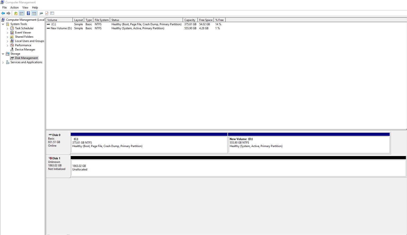

My hard disk is showing unallocated with the capacity in the disk management . and to initialise the disk a pop up shows in virtual disk manager that it is cyclic redundancy error
how to fix this??
and recover my data

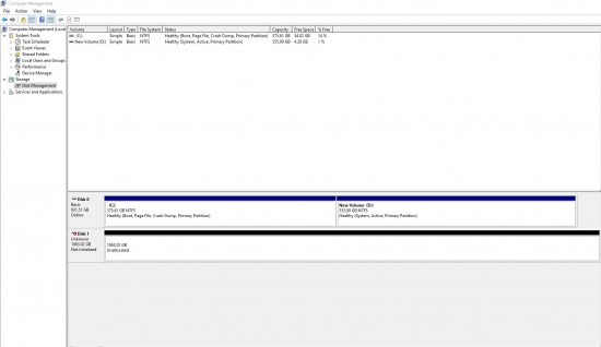

how to fix this??
and recover my data

Make a sector-by-sector image with something like HDDSuperTool and then use something like UFS or DMDE to recover your data.
If data is important, contact member Amarbir.
