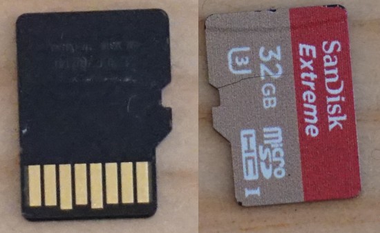

I there I have a cracked Microsd flash to recover. I am in spain but that would not be hard to ship.
It is not urgent. It might be photos I have lost or photos I have backed up. So not very high value data, looking for a recovery price accordingly.
Card is a Sandisk extreme 32Gb the crack is visible on the printed side, on the other side it looks like a small bend.
Contact me here or my forum nick on gmail.

If it is cracked, 99% its not recoverable unless you are VERY lucky. If it is recoverable, then the cost would be 500+ EURO. So if the data is not important. Move on.

Show here photos of card - both sides.

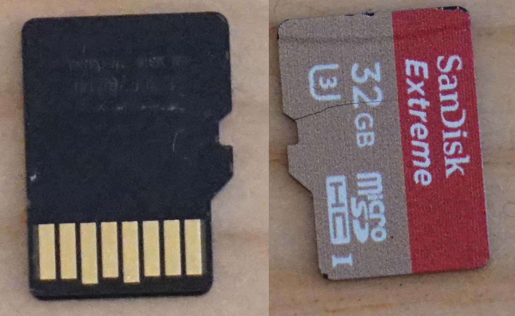

Let me know if I should try to get more focus on the back side.
Front side is showing what I see.
File comment: Both side.

IMHO no chance for recovery.

That video just has some scratched traces, didnt see it was actually cracked. a cracked card is no go if the crack is through the NAND

I was not sure how far from the center was the Nand going.
Anyway I have sent it to Rossman and then I gave them permission to "recycle" it...
