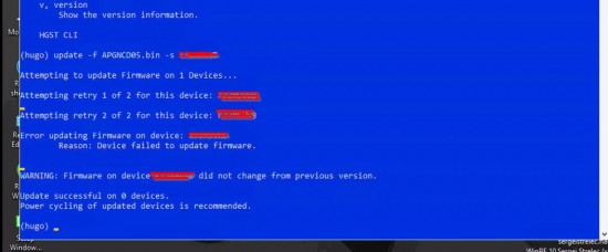

i have got 6 pieces of the X477_HAKPE04TA07 (4TB SAS HDD HGST aka HUS726040AL5214).
i tried to plug itinto my HPE Proliant G8 but he didn't recognice the drives, so i started researching and find the possibility to reflash the drives with the "generic" firmware so far as well. So i downloaded hugo and the firmware APGNCD05 for the drive an tried my best,
but i got every the same error message.
has anyone an idea or know some one who can help me here?
many thanks :D
