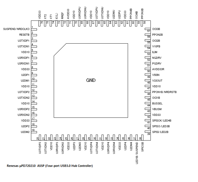

My first though is that is might be a Renesas MCU (by some google tricks).
Now I found a datasheet for a Renesas usb hub and I think they used this usb hub ic.
(19 pins each side make 76 total)
also clock pins, SPI rom connected and other components connected to the IC make this a possible candidate that they used.
I dont own this device and only used the earlier posted image as a reverence. Dont take my word on this, and all on own risk.
http://www.crypton.com.hk/key%20info%20in%20web%20site/Renesas%20Specs/uPD720210.pdf link to datasheet that looks like the internal one I got from renesas itself.

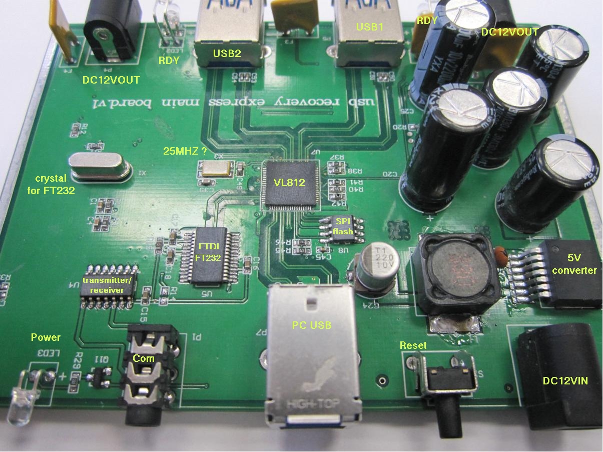

PostPosted: January 18th, 2016, 17:14
Posts: 17091
U8 = serial SPI flash memory.
U7 = VIA VL812 USB 3.0 Hub Controller:
http://www.via-ic.com/upvid/2015080109514354.pdf
U5 = FTDI FT232 Single USB 2.0 to Serial UART Converter IC:
http://www.ftdichip.com/Documents/DataS ... FT232R.pdf
U4 connects to the Com(munications) port. It must be a TTL driver/receiver or similar.
The switchmode regulator must be producing 5V which U7 then down-regulates to 3.3V (Vio) and 1.15V (Vcore) via its internal LDO regulators.
The "power control module" on the underside could be using a "free" USB VID/PID. For example, there are USB-relay kits that use an Atmel AVR MCU such as the following:
http://www.atmel.com/images/atmel-2586- ... ummary.pdf
