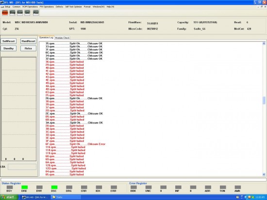

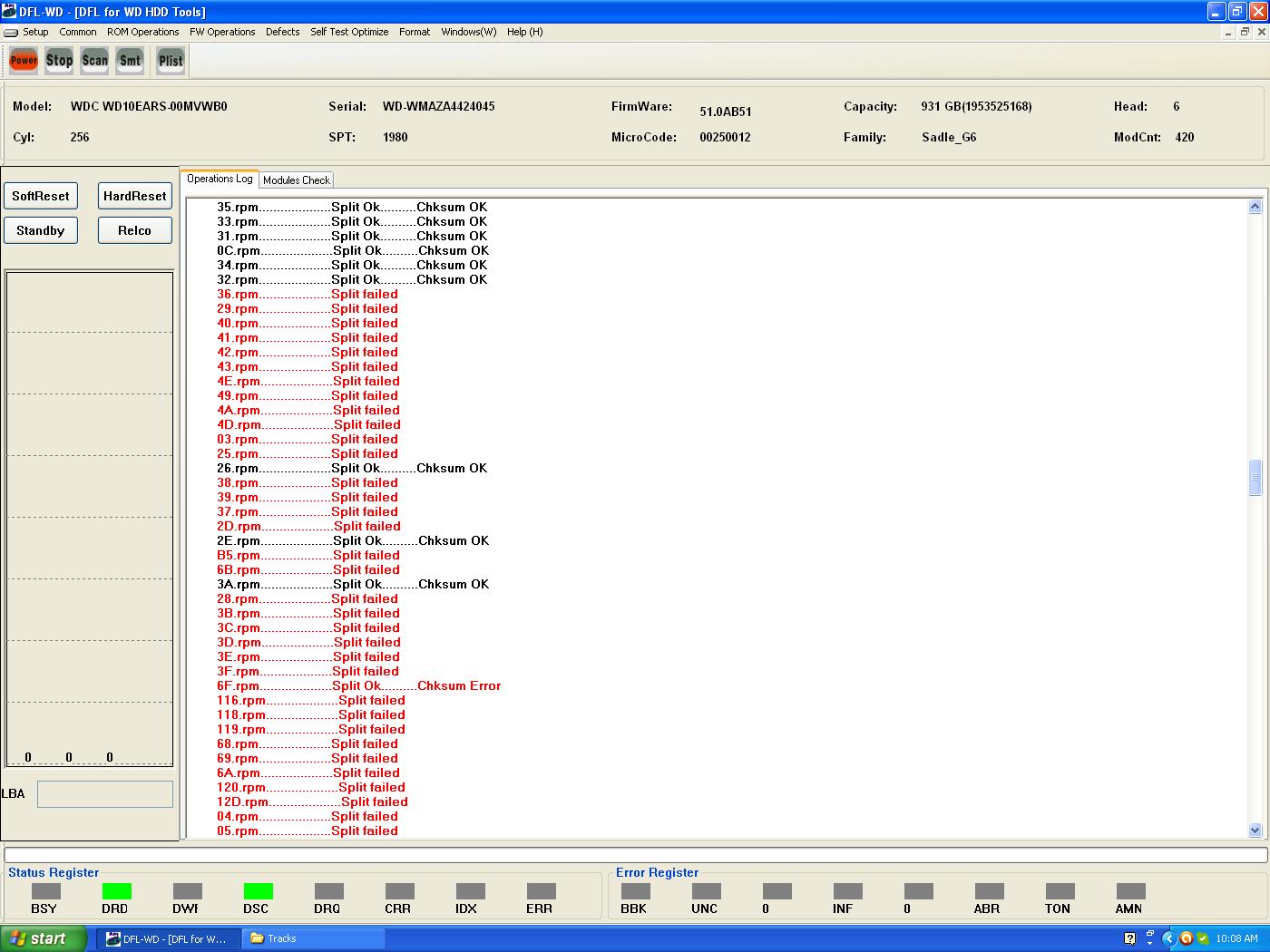

please
in this situation we need donor ?

PostPosted: May 8th, 2013, 16:15
Posts: 1061
Location: Bangladesh
yes, u need it

Hello Salim, as for your cases, you must let us know whether you want to refurbish the hdd or recover data from it?
You can consider change totally the firmware and ROM from the same family, you can check your PCB number and write common fw and ROM and then run selftest for hdd refurbishing.
For data recovery, you can try hot swap and see and manage to regenerate the key data modules as suggested in the DFL forum.

YES SALIM
IF MOST OF FW M MODULES ARE BAD YOU SHOULD USE NEW FW OR REFURBISHING FW FILES TO SOLVE YOUR PROBLEM
OTHERWISE Y WASTE YOUR TIME
