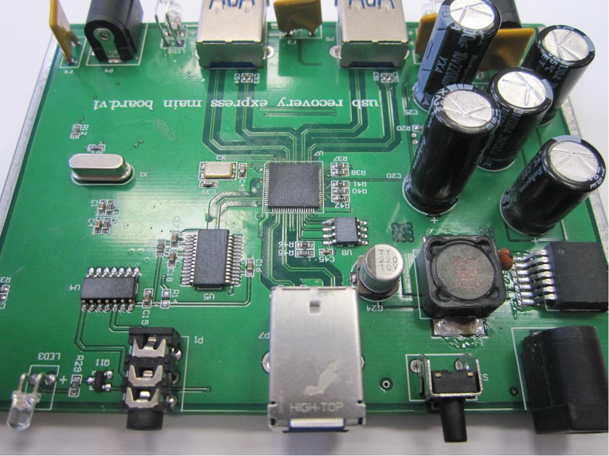

I see a lot of guys waiting for someone to post a feedback on DFL-URE… I’ve bought one right as it came out and I thought I share my thoughts with you.
See picture of DFL-URE board attached. Looks like entire PCB assembly was done by hand… very dirty work. Didn’t even bother to clean remainders of soldering flux. This is for $2k…
As you can see, labels on all chips were wiped off. However, as soon as you connect the tool to Windows, it is identified as VID_2109&PID_2812 (USB 3.0 Hub built on VIA Labs VL812 chip) and Windows loads a standard hub driver for it. So, the main chip of the board really doesn’t have anything custom on it and it’s just a regular USB 3.0 Hub with a standard hub driver.
Browsing further Windows Device Manager you can see how four ports of the hub are used. Two of these ports go straight to two source drive USB connectors. Third port is connected to an onboard USB Serial adapter built on FTDI FT232 UART chip (VID_0403 & PID_6001) and Windows load a standard FTDI driver for it. And the fourth port used by an onboard power control module that is built on an unknown USB chip; Windows don’t recognize its VID/PID and so the user have to manually install a DFL driver for it so that DFL-URE application could power ON/OFF drives via this driver.
Well, not much on the hardware level… All basic stuff worth around $50 in total.
Now about their software. Well, unfortunately, the discovery (again, simply based on Windows Device Manager) was that any USB drive connected to DFL-URE is mounted by Windows with standard USB Mass Storage Device driver…L!!! This means that DFL-URE cannot work with the drives that are not identify by Windows… So all the USB drives not identified by Windows due to bad sectors or firmware issue can not be handled by this tool.
They seem to try to mitigate fact that the tool using standard USB Mass Storage Device driver by intercepting Windows communication to drive and modifying drive ID, so that the drive was showed up in Device Manager as “DFL-URE USBDrive V1.0 USB Device”, but you still can see that Windows simply is using a standard USB Mass Storage Device driver for this drive, e.g. under “Device Manager -> Universal Serial Bus Controllers -> USB Mass Storage Device”.
Also, I am not very sure why they implemented all those firmware repair features in this tool (if it uses standard OS drivers), because pretty much all drives with firmware related problems will not mount on Windows. DFL don’t even trying to hide this fact though and their installation guide says that for drives that have Windows “detection problems” … “users need to change to SATA board” to fix firmware and then put the USB board back to the drive to image it with DFL-URE. Well…???
Yeah, you can still make some firmware repair on some drives over serial terminal, but the use of this is limited and this is also can be done by other non-USB recovery tools.
Anyway, to summarize, from design perspective, DFL-URE is the Windows data recovery software imaging utility that comes with a USB3 hub hardware that can also automatically control power to drive. It could be a good software imaging tool… I don’t know yet, because we didn’t have a chance yet to try many USB drives with problems on it. But, what I want to say is that this product cannot be recognized as “USB Device Recovery Equipment”, as it is declare by DFL. So, personally, I will not value this tool for $2k.
Are you referring to the 7-pin IC to the right of the coil and above the 12V input socket? To me it looks like a switchmode regulator, not a "USB chip". AISI, the coil, IC, and 220uF 10V capacitor constitute a 5V supply. I can't see any chip that looks like it might be involved in power switching. Is there another chip hidden amongst the taller capacitors, or on the underside of the PCB?
Can you measure the resistance between the 12VDCin socket and the two 12VDCout sockets? If the resistance is zero, then this would suggest that the 12V supply is not switched. Could you also measure the resistance between the coil and the 5V pins at the two USB output connectors? Once again this will determine whether the +5V supply is switched.
When you say that "Windows don’t recognize its VID/PID", do you mean that this "USB chip" identifies itself with an unknown VID/PID, or do you mean that this chip doesn't report any VID/PID at all?
BTW, thank you very much for your report, and for the photograph.
Switching transistors underside of PCB.
Chip report some VID/PID, but this VID look not registered. I searched in Internet and nothing… I don’t have this VID/PID numbers with me now, because I am not in work already.
