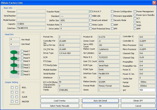

Hello everybody! I have a customer's WD 160GB ATA HDD with clicking noise and not visible in BIOS. On DFL-FRP it powers ON but fails to get details and size. Here is a image of autodetection window and a log file.
............................................... Head Count: 4
............................................... Platter Count: 2 platter(s)
............................................... SPT :500
............................................... ROM Size: 128(KB).
............................................... Sector Size: 512(B).
............................................... Servo FW Ver.: 00.92.
............................................... Ovl_fw Ver.: 20.A8M.
............................................... Failed to obtain the directory details.
............................................... Failed to execute the command.
............................................... Initialization completes.
Firmware Save Path:C:\DFL\STARLING\WD1600JB\unknown\
Modules can not be read. On DFL web site and help videos, there is no such case. The full story about this disk is that electronic was burnt and I've replaced it from donor disk with FW, too. Disk was visible, with no bad sectors. Client took disk and start cloning it on external HDD connected to USB 1.0! After few hours, it crashed and started to click. Now it's not visible. Do I have to replace heads? I can not test heads when disk is not visible in DFL. Any help is welcome, thanks!

...a classic case of going cheap making a job expensive. I recommend that you send the drive to a data recovery professional, if you want any chance to recover the data, assuming that it isn't too late.
 Post subject: Re: WD1600JB-00REA0 FW problem
PostPosted: December 16th, 2014, 14:01
Hi Alex,
You should never allow a customer to clone their own data, always do it for them. Even when the damage is in the PCB there is usually still areas of bad sectors caused by the same incident. That's why you always clone to a good drive first, then extract files to the customers media from the good drive. You never copy files from the repaired drive.
Yes, at this point you'll need to replace the heads to even attempt recovery. However it's possible that the drive now has damage in the service area which may make recovery impossible.
Take this as a lesson learned and be more careful in the future. Doesn't DFL have data extraction features? Why would you allow the customer to do it?

@data-medics, thanks for friendly answer! My client was in hurry, I fixed his disk after working hours, so I had no time to copy even data only, not to mention a disk cloning. I just checked health, it was 100% OK. I don't know if he dropped it after that. So, this is really not my fault, he admits that too.
I can replace the heads, did that many times, but first I'll try all other options. DFL-FRP is a good tool for fixing firmware, and data extraction is not included in this product.
This is a Starling drive. Have you ever swapped heads again to a Starling? They are sensitive to head alignment.

The only way to know that the drive was 100% OK is to test every sector. As you didn't have the time to clone the drive (reading very sector), I sense that you really didn't fully test the drive.
With these drives with bad PCBs, almost every time there is media damage caused by the heads slapping onto the surface each time the PCB fails before the final blow that completely kills the PCB. Sometimes the media damage is minor, other times it is to the point where the heads are damaged too.
This is a tough lesson for you and your client to learn. If you are serious about becoming a data recovery professional, you must start by refusing to cut corners. If a client can't afford the price, let them go to Jimmy Joe's computer shop where they don't care if they lose the client's data.
