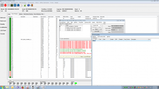

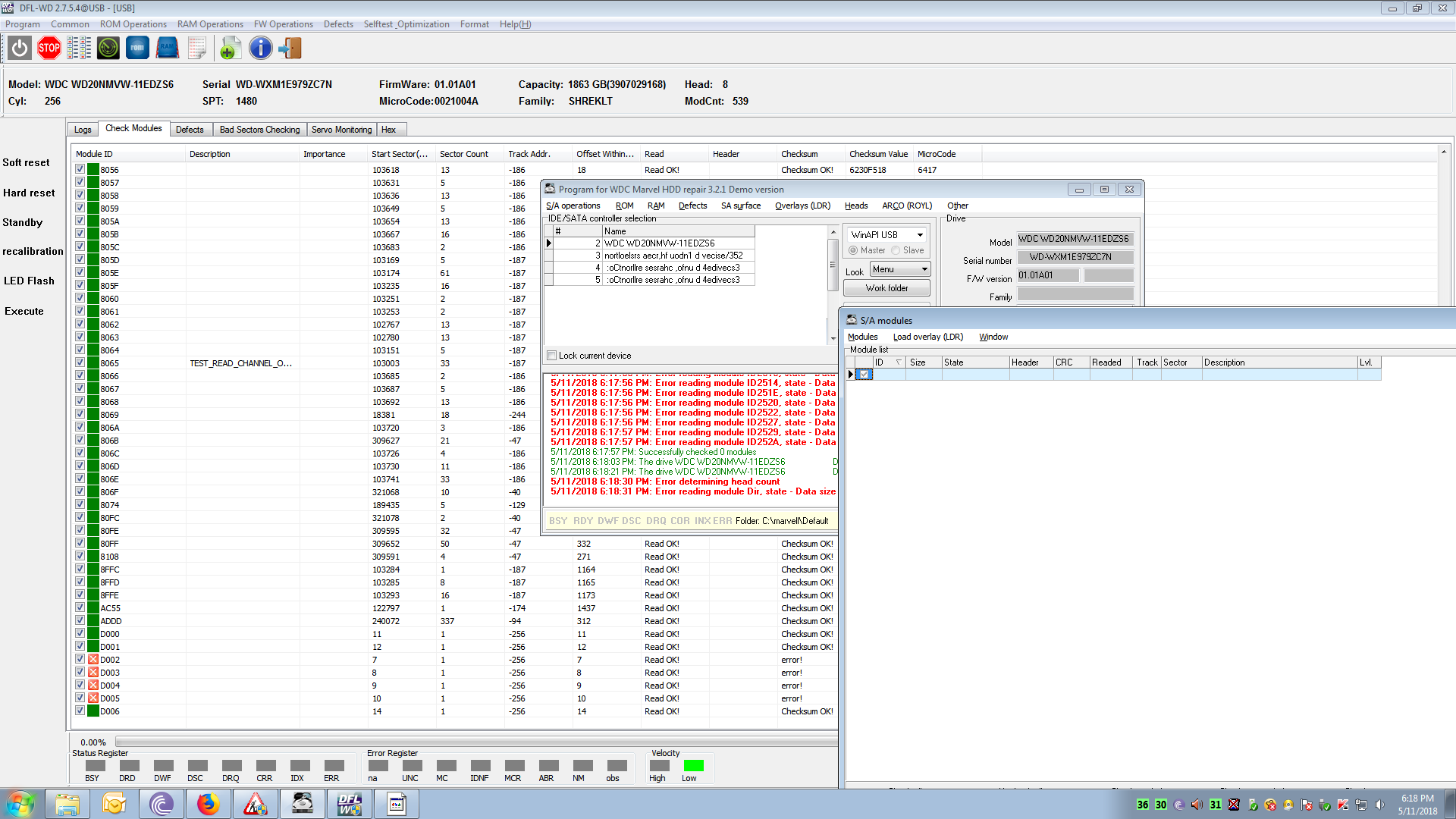

This is marvell and dfl side by side over USB. DFL reads every module as you can see.. ??Marvell??

Spildit wrote:
Just try the free DEMO and check if it can read your modules on that drive without CRC error !!!! If it can something is VERY WRONG with your DFL tool ...
You shouldn't be doing that manipulation in RAM as well to bypass the re-lo problem.
Your DFL most likely doesn't know how to properly read the module directory on modern drives and you are risking to cause huge irreversible damage to those drives if you continue to use it like you are doing.
Check with WDMarvel DEMO or SEDIV DEMO !!! If those can properly read the modules then next step is compare the modules with the ones DFL did read ...
Can you please explain what could be other alternatives. Moving the module on other track is not possible as DFL and marvell (registered) both fail to write the entry table changes in 01 suggesting write failure.
I believe any change done in the RAM SHOULD be temporary. Right?
