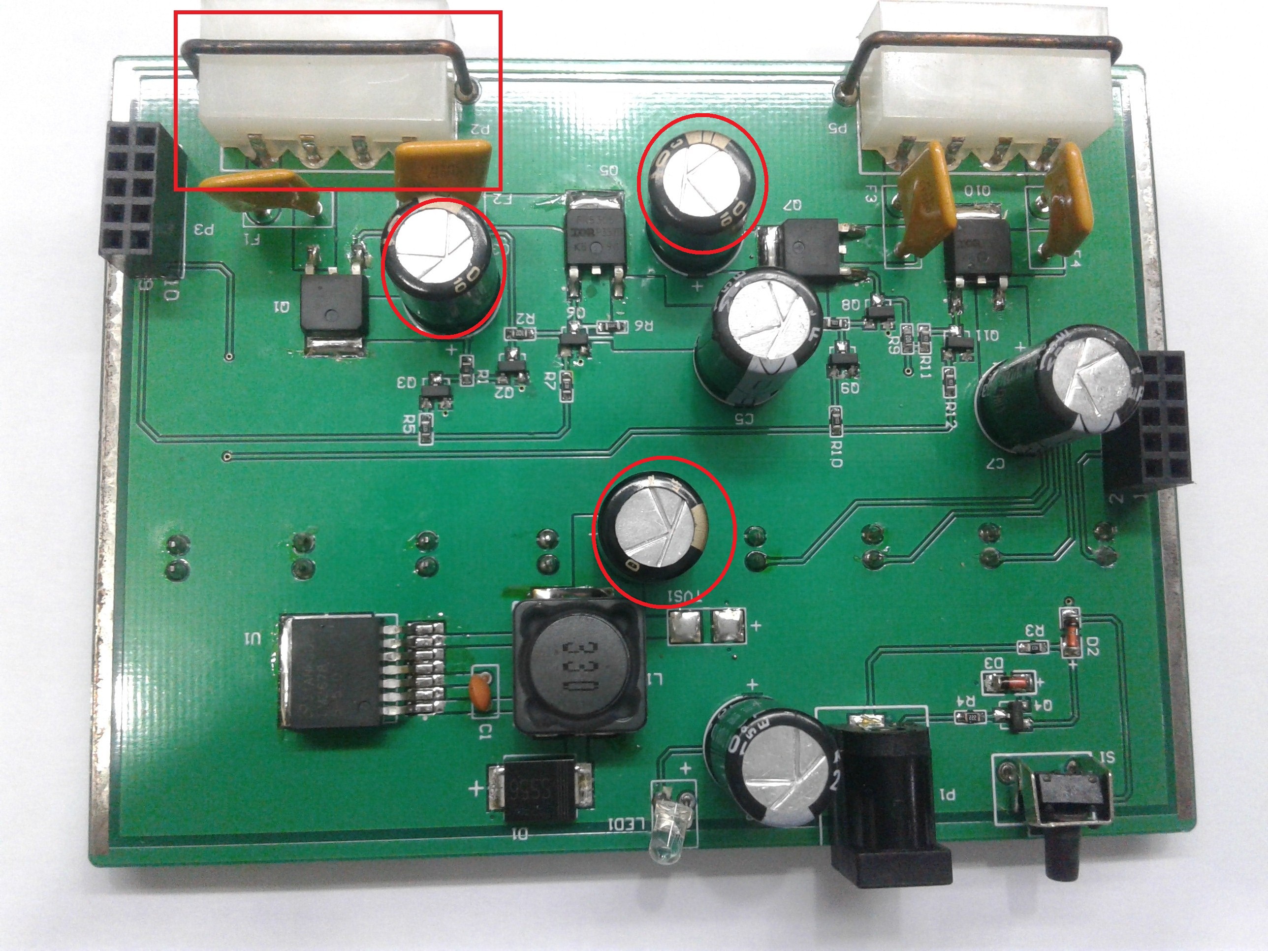

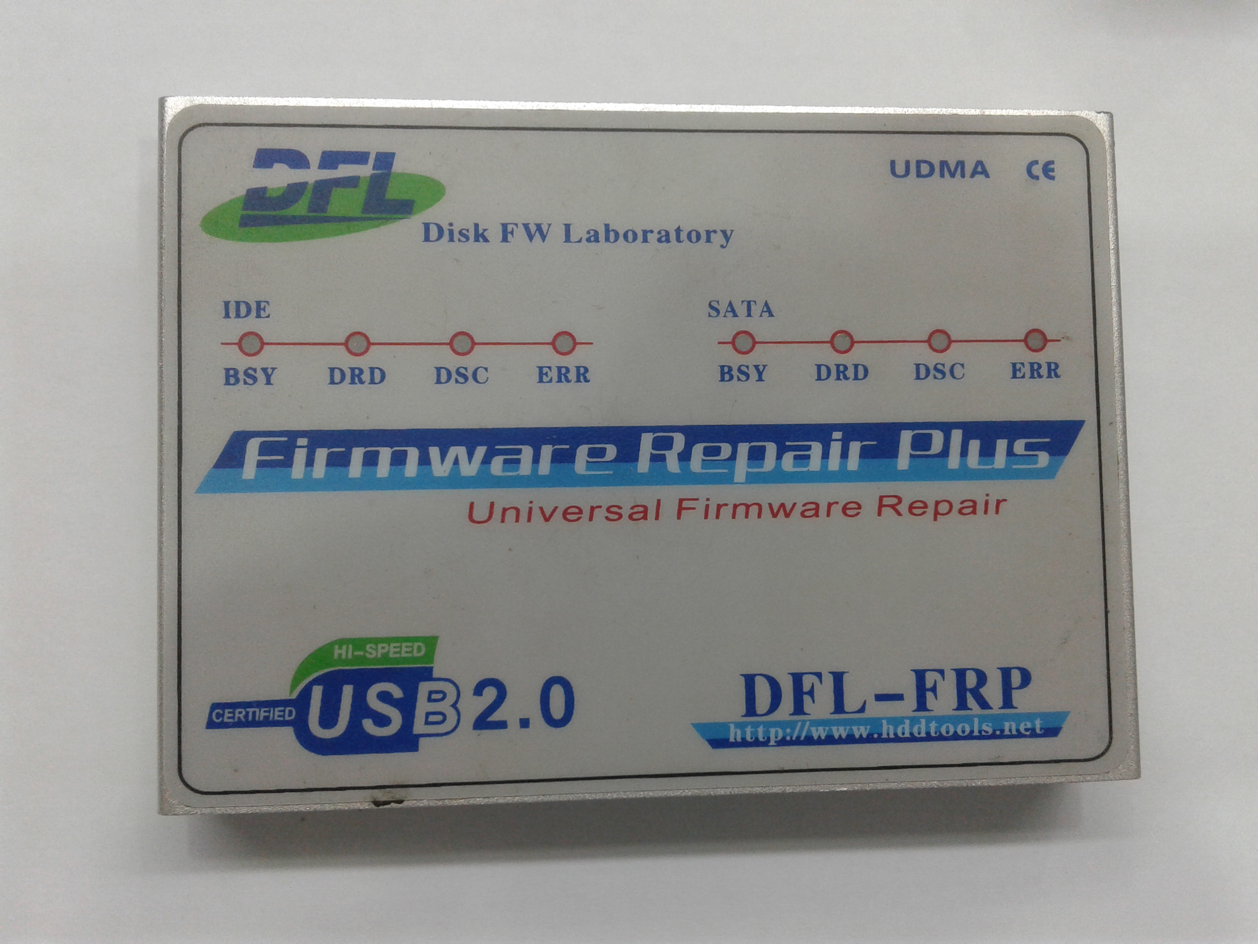

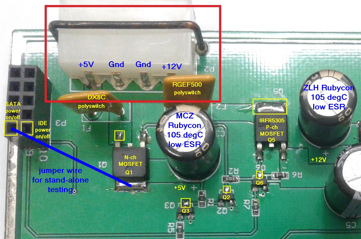

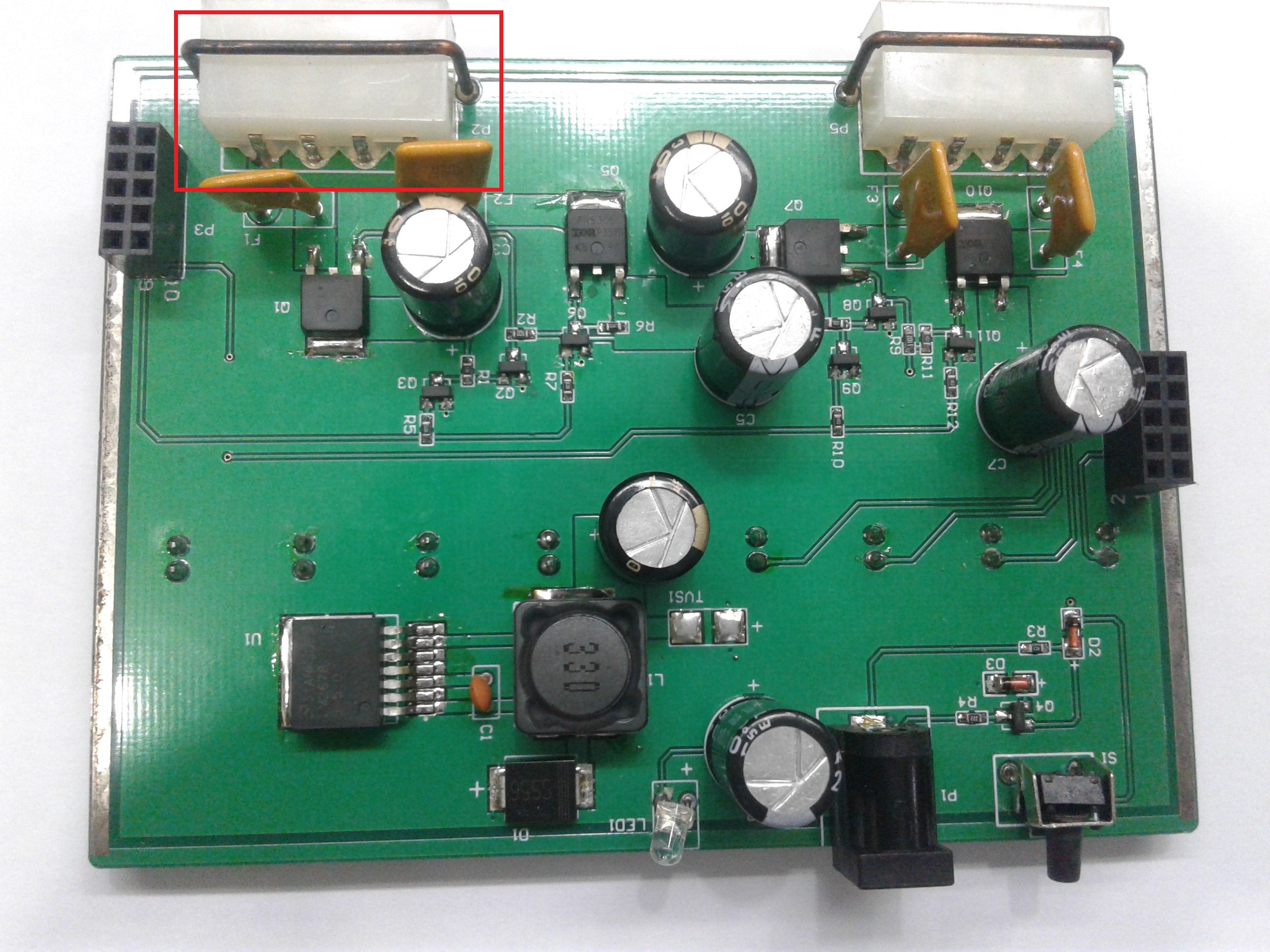

Hi

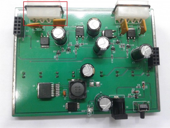

very simple question i have DFL -FRP , not giving power out on SATA port (channal zero )
its very hard to send it back to china,
can someone help me here,

What is write in U1 component ( reference ) ?
Regards.
 Post subject: Re: DFL-FRP PCB REPAIRING
PostPosted: May 11th, 2018, 15:21
Posts: 428
This is LM2678 DC converter National Semiconductors. Author let check F1 and F2.
Then Check Power supply on U1 LM2678.
PostPosted: May 11th, 2018, 18:30
Posts: 17215

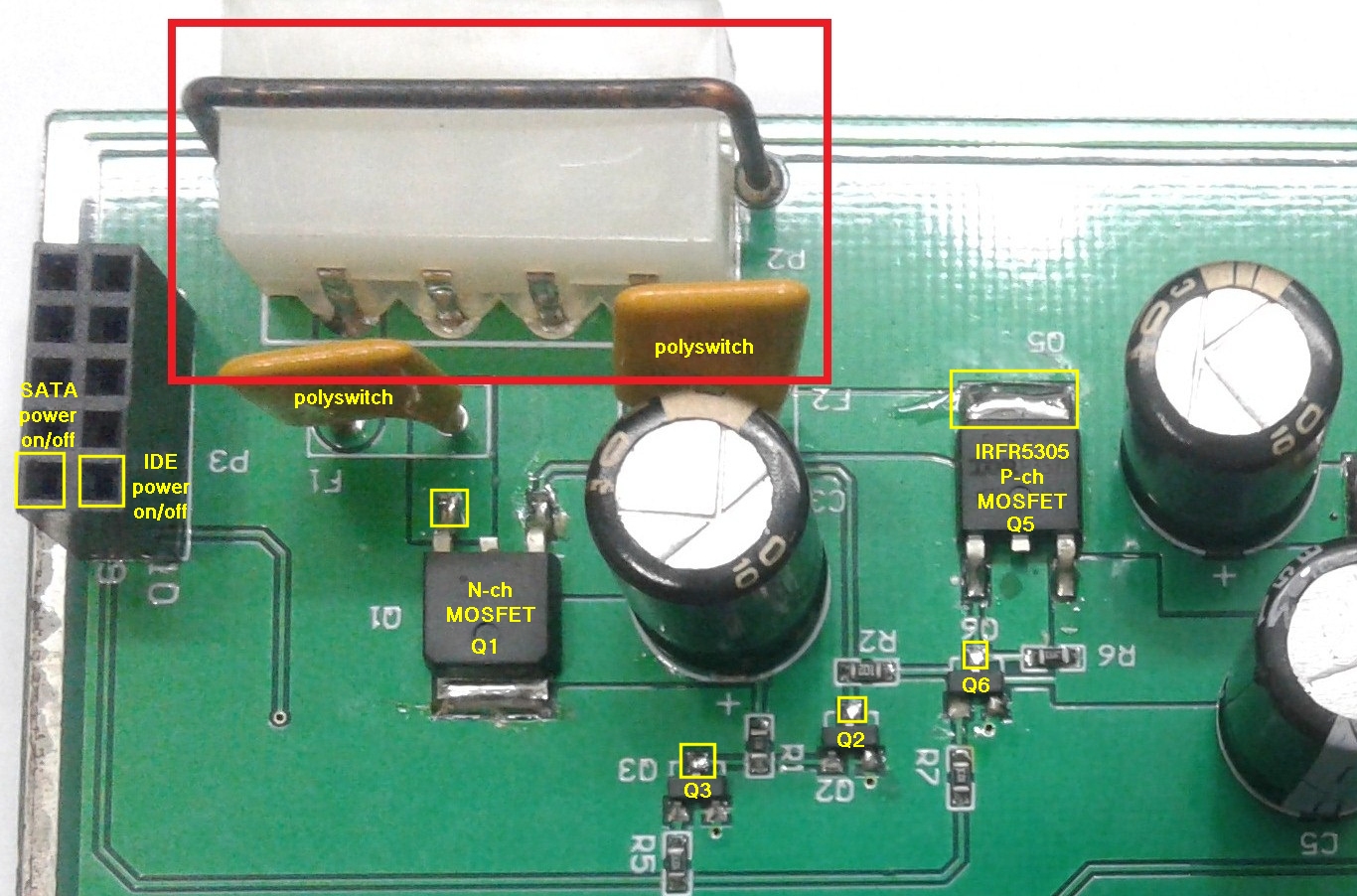

U1 would be the +5V supply. This supply would be common to both the IDE and SATA channels. Also, U1 would be the source for the secondary supplies (for the logic). Therefore, I can't see a problem here.
F1 - F4 appear to be polyswitches or polyfuses (resettable fuses).
I would measure the voltages at those pins that are marked with squares.
Can you tell us the markings on Q1?
IRFR5305, International Rectifier, HEXFET, P-ch, -55V, -31A, RDS(on) = 0.065 ohm, 110W, D-Pak:
https://www.infineon.com/dgdl/irfr5305. ... 324d0820fd
LM2678, Texas Instruments / National Semiconductor, Step-Down switching Regulator, 5A, 8V - 40Vin:
http://www.ti.com/lit/ds/symlink/lm2678.pdf
PostPosted: May 12th, 2018, 4:33
Posts: 17215
                         +12V
               R6/R11 | |      |
                       |  G    | S
                       +----||-+   Q5/Q10
                       |    ||->  IRFR5305
                Q6/Q11 |    ||-+
  SATA/IDE    ___    |/        | D    F2/F4
  power  o---|___|---|         |     _
  on/off             |>        '----o \_/o---o  +12V
  from       R7/R12    |                        output
  logic                |             poly-   o
  PCB                  |            switch   |
                      GND                   GND
                      +5V        +12V           +5V
               R1/R?? | |        | | R2/R9       |
                       |          |              | D
                       +----.     +-----------||-+  Q1/Q7
                       |    |     |         G ||<-
                Q2/Q9  |    |     | Q6/Q8     ||-+
  SATA/IDE    ___    |/     |   |/               | S   F1/F3
  power  o---|___|---|      '---|                |       _
  on/off             |>         |>               '----o_/ \o---o +5V output
  from       R5/R10    |          |
  logic                |          |                   poly-    o
  PCB                  |          |                   switch   |
                      GND        GND                          GND
Logic 1 = power ON
Logic 0 = power OFF

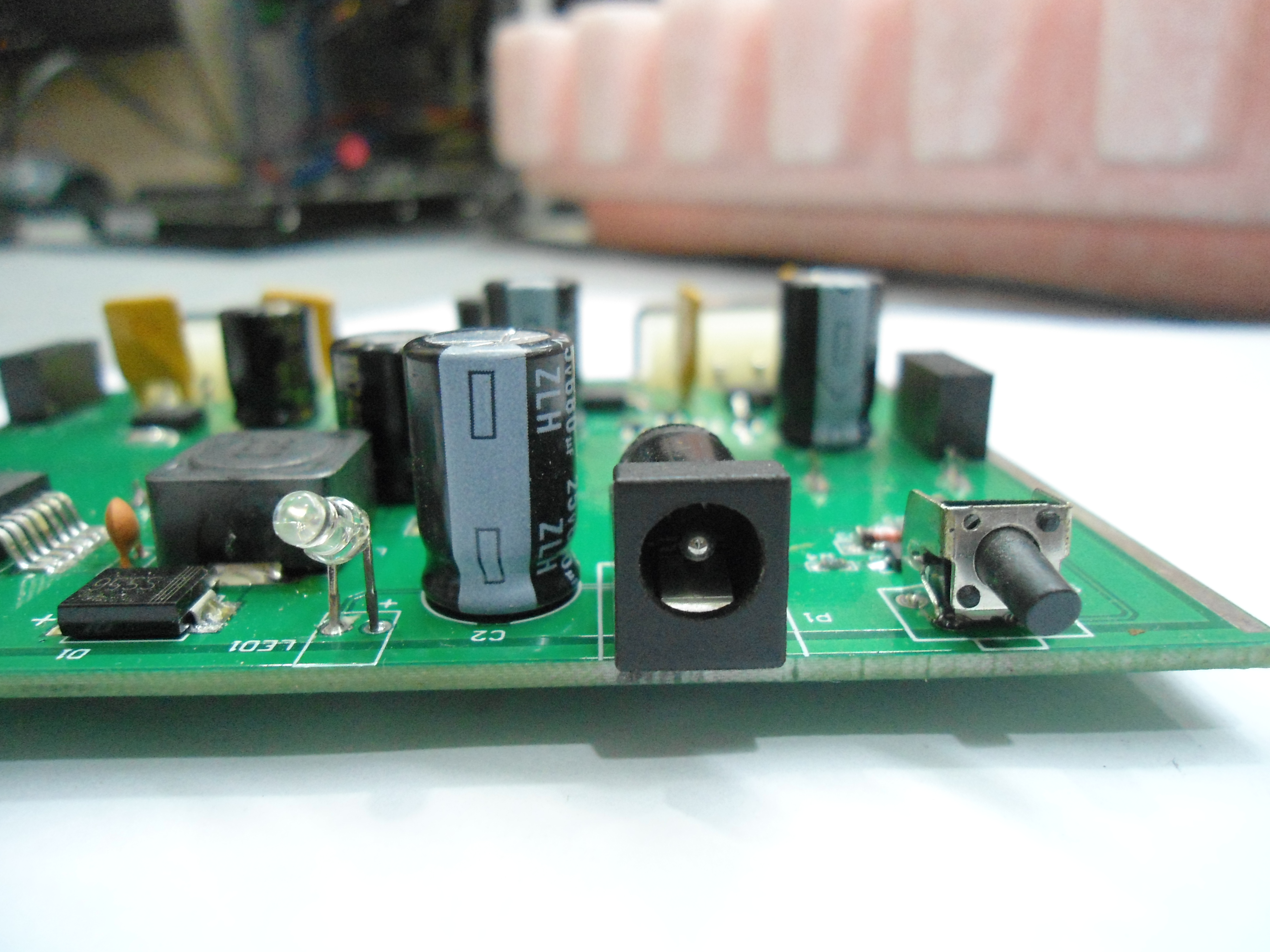

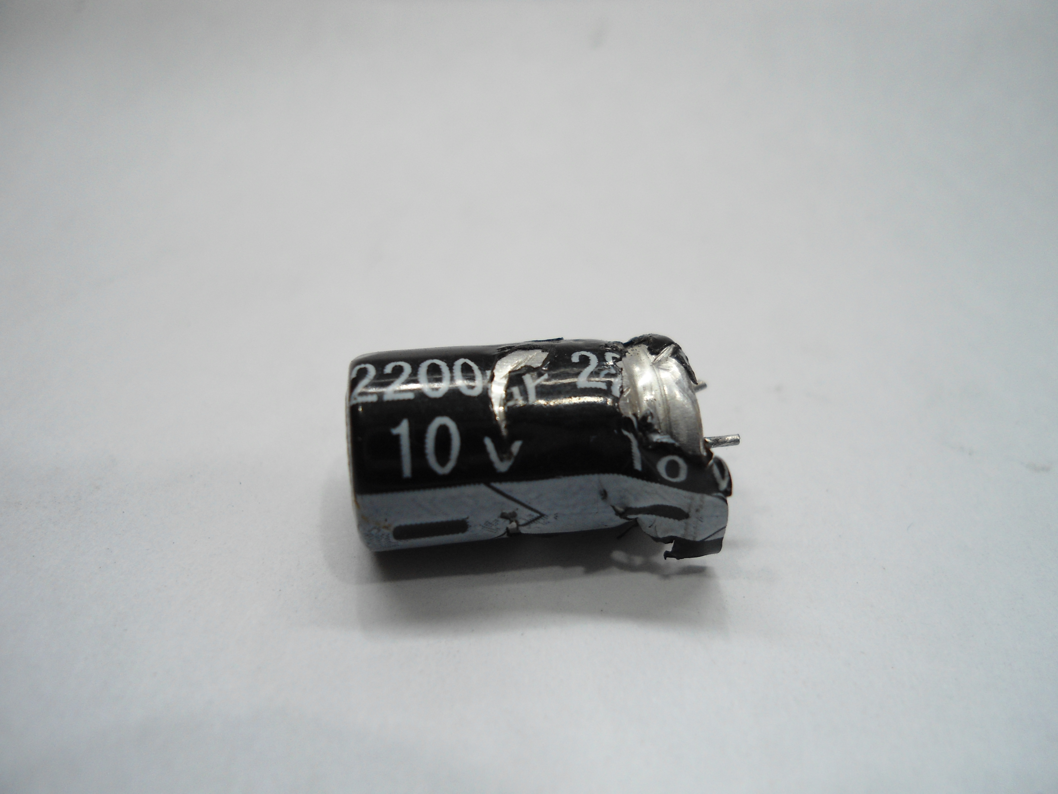

when i opened the box first time i saw 3 capacitor damage. i replace three capacitors , original value was 10v 2200uf,and a replace with 10v 1000uf .but result is same .can it be cause of capacitors .
PostPosted: May 12th, 2018, 10:01
Posts: 17215

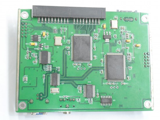

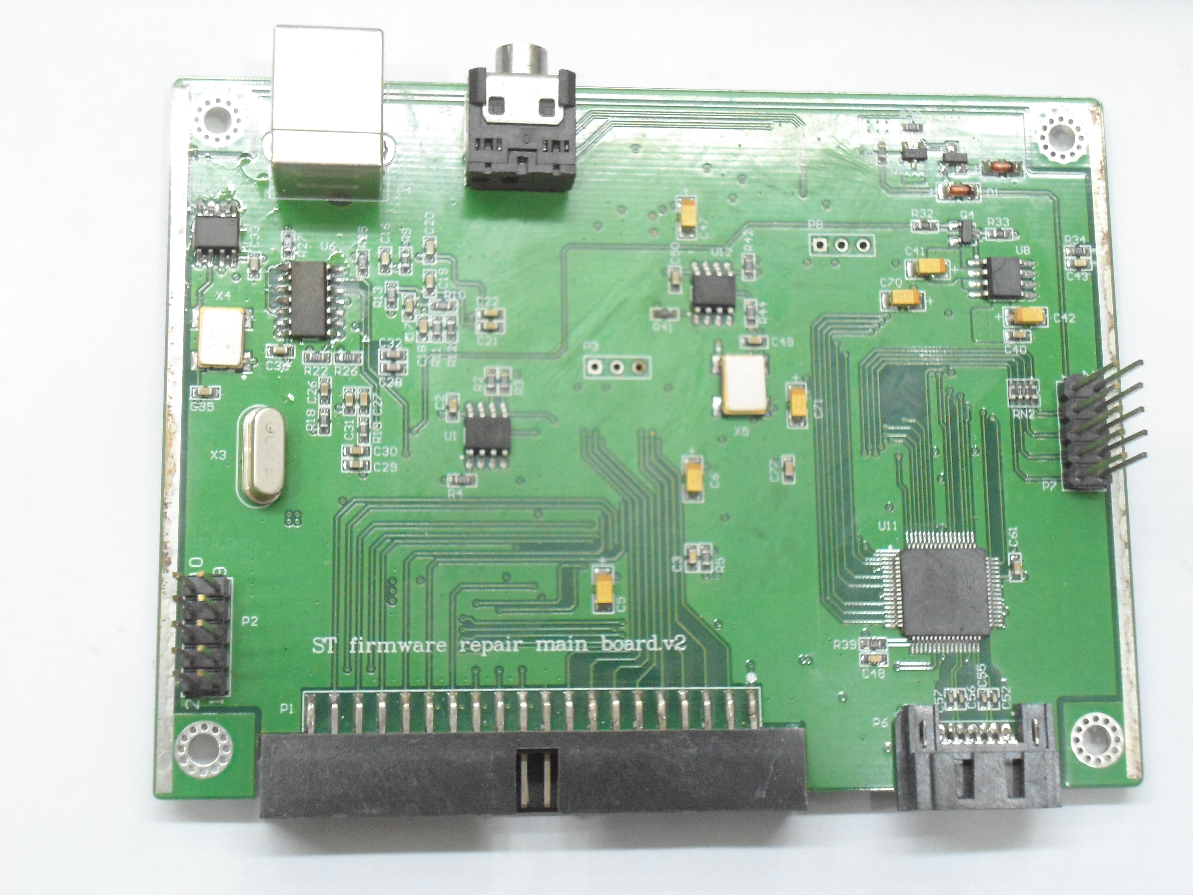

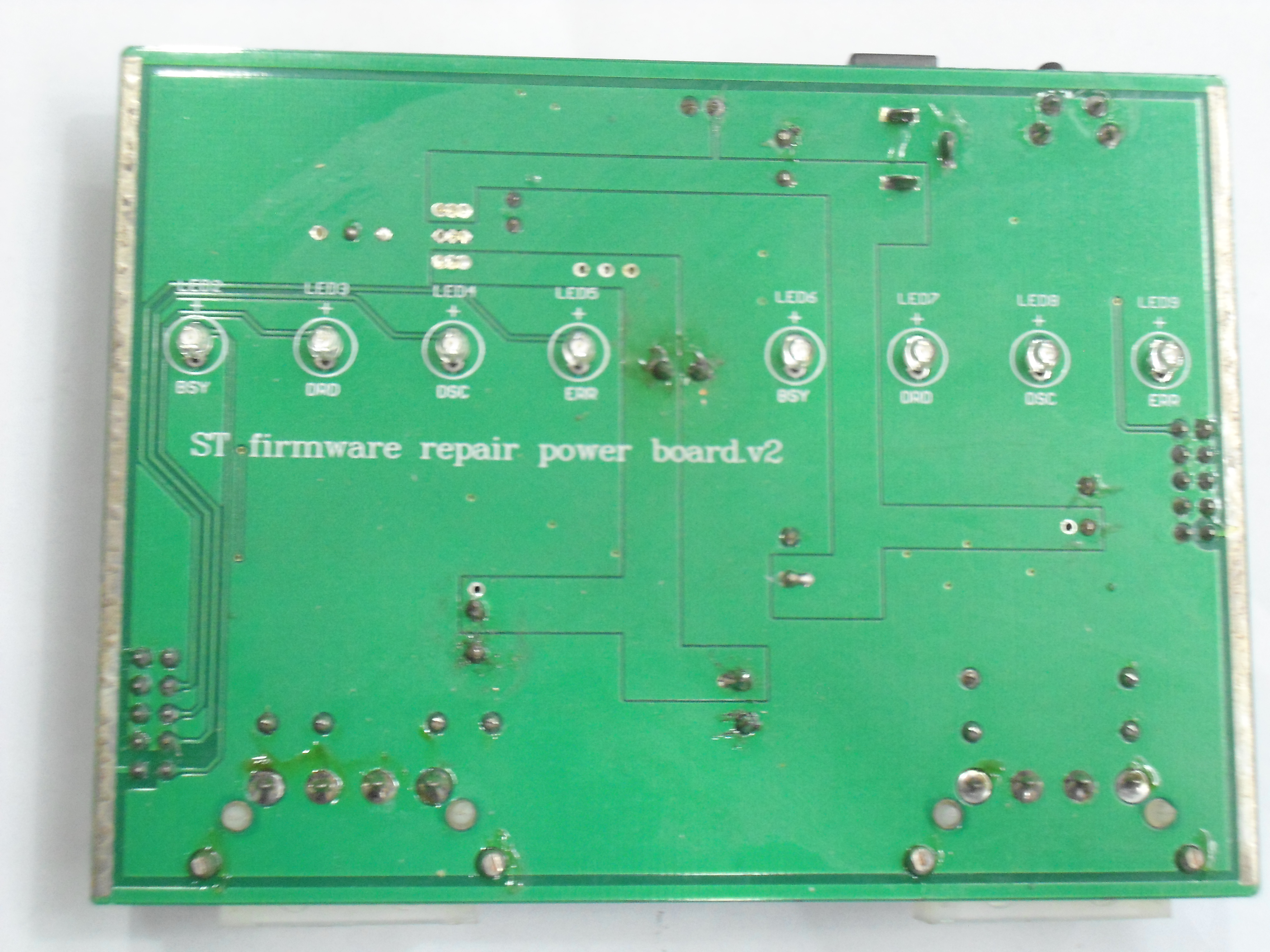

Can you show us the other side of the PCB? Can you also show us both sides of the logic PCB?
Can you tell us all the markings on the original and replacement capacitors? Something doesn't look right ...
Hmm, 1000uf is less than half the capacity of 2200uf, which could be the cause for problems, yes. But it's a bit strange that you do not get any power output. Did you make sure that you mounted them in the right direction?
PostPosted: May 13th, 2018, 14:56
Posts: 17215
The polarity stripes on the caps are consistent with the "+" indicators on the silkscreen.
PostPosted: May 13th, 2018, 15:14
Posts: 17215
I don't think that there is any requirement for capacitors at each of the +5V and +12V outputs. In fact I don't understand their purpose (other tools don't have them). However, the capacitor at the 5V regulator should be a low ESR, 105 degC type.
Moreover, the capacitor at the 12V input appears to be a 10V type, so something could be seriously wrong here.
I'm also waiting to see the logic PCB so that I can determine whether it is safe to connect +5V directly to the on/off control pins (for testing purposes). However, the OP's responses so far would suggest that visual inspection may be the limit of his troubleshooting ability. :-(

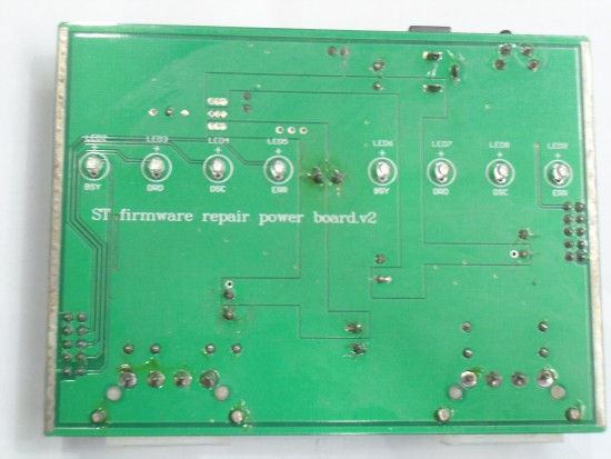

PostPosted: May 14th, 2018, 6:46
Joined: May 6th, 2013, 2:48
Posts: 84
PostPosted: May 14th, 2018, 16:10
Posts: 17215

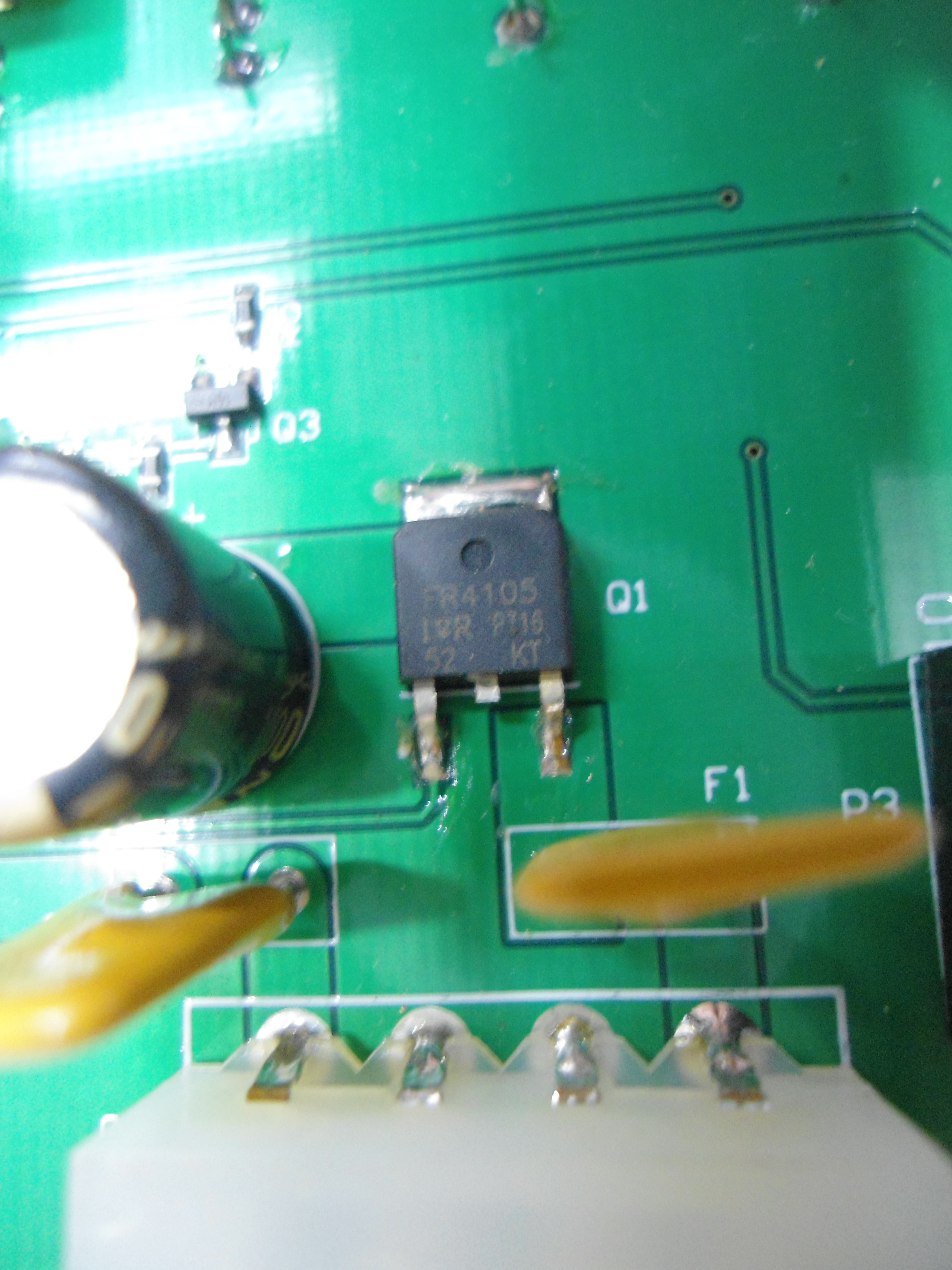

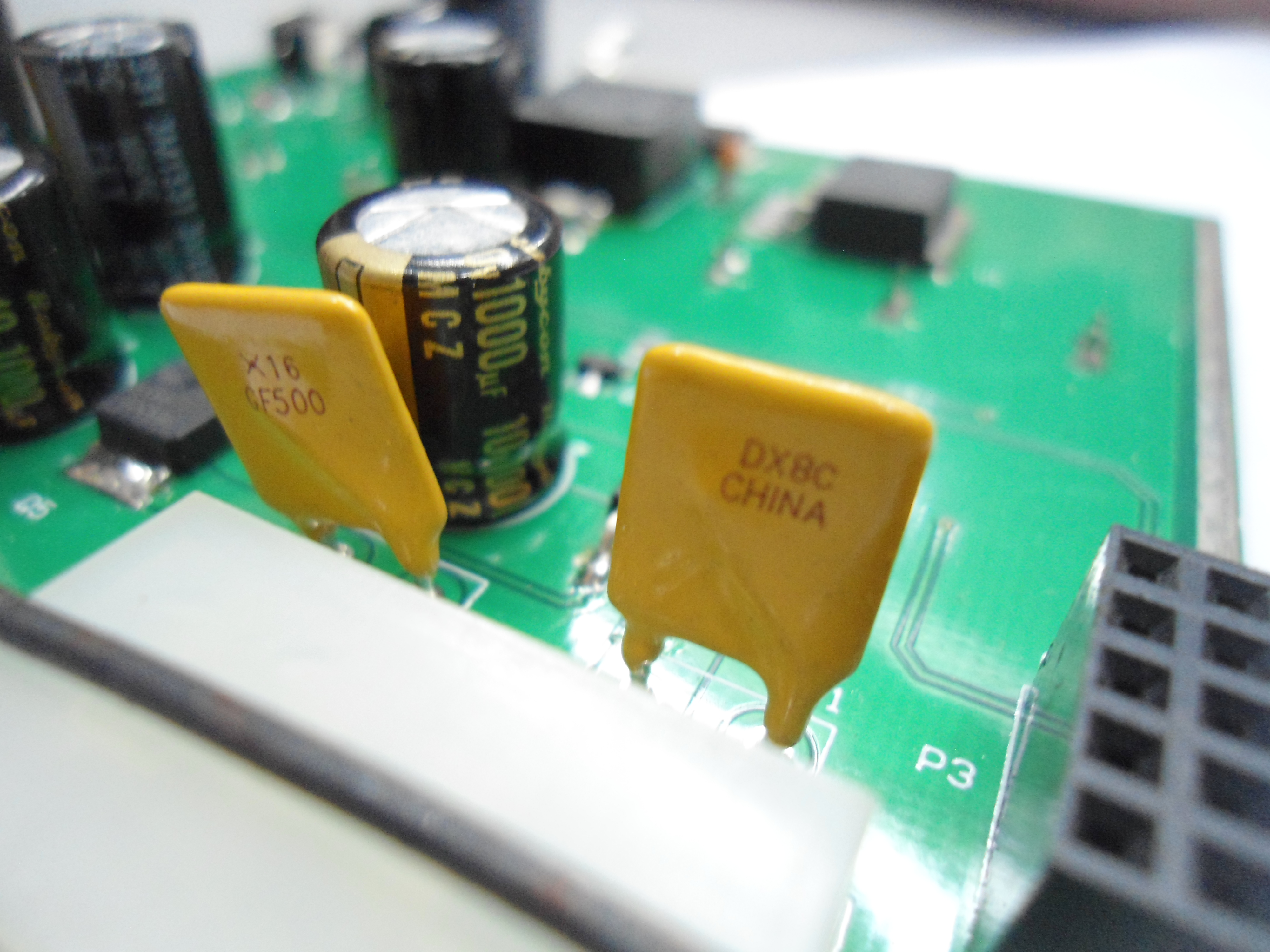

I can't see all the markings on the bad capacitor (can you tell us what they are?), but I'm assuming its a ZLH series Rubycon. If so, then all the caps have good specs, in which case I can only assume that DFL was stung by a bad batch, or maybe even fakes (?).
It would be difficult to measure the test points when the unit is assembled. However, the power board can be tested on its own if a jumper wire is added between the +5V supply and the SATA on/off control pin.
I also can't see the markings on the N-ch MOSFET (Q1). Can you tell us what they are?
BTW, the pushbutton switch looks like it needs replacing.
RGEF500, Littelfuse, PTC Polyswitch, 16V, 5A, marking X16 GF500:
http://m.littelfuse.com/~/media/electronics/product_specifications/resettable_ptcs/littelfuse_ptc_rgef500_product_specification.pdf.pdf
http://m.littelfuse.com/~/media/electronics/datasheets/resettable_ptcs/littelfuse_ptc_rline_catalog_datasheet.pdf.pdf
MCZ series, Rubycon, low ESR, high ripple current, 105 degC, aluminium electrolytic (10V, 1000uF):
http://www1.futureelectronics.com/doc/RUBYCON/6.3MCZ820M8X11.5.pdf
ZLH series, Rubycon, low impedance, 105 degC, aluminium electrolytic (25V, 680uF):
http://www.rubycon.co.jp/en/catalog/e_pdfs/aluminum/e_zlh.pdf

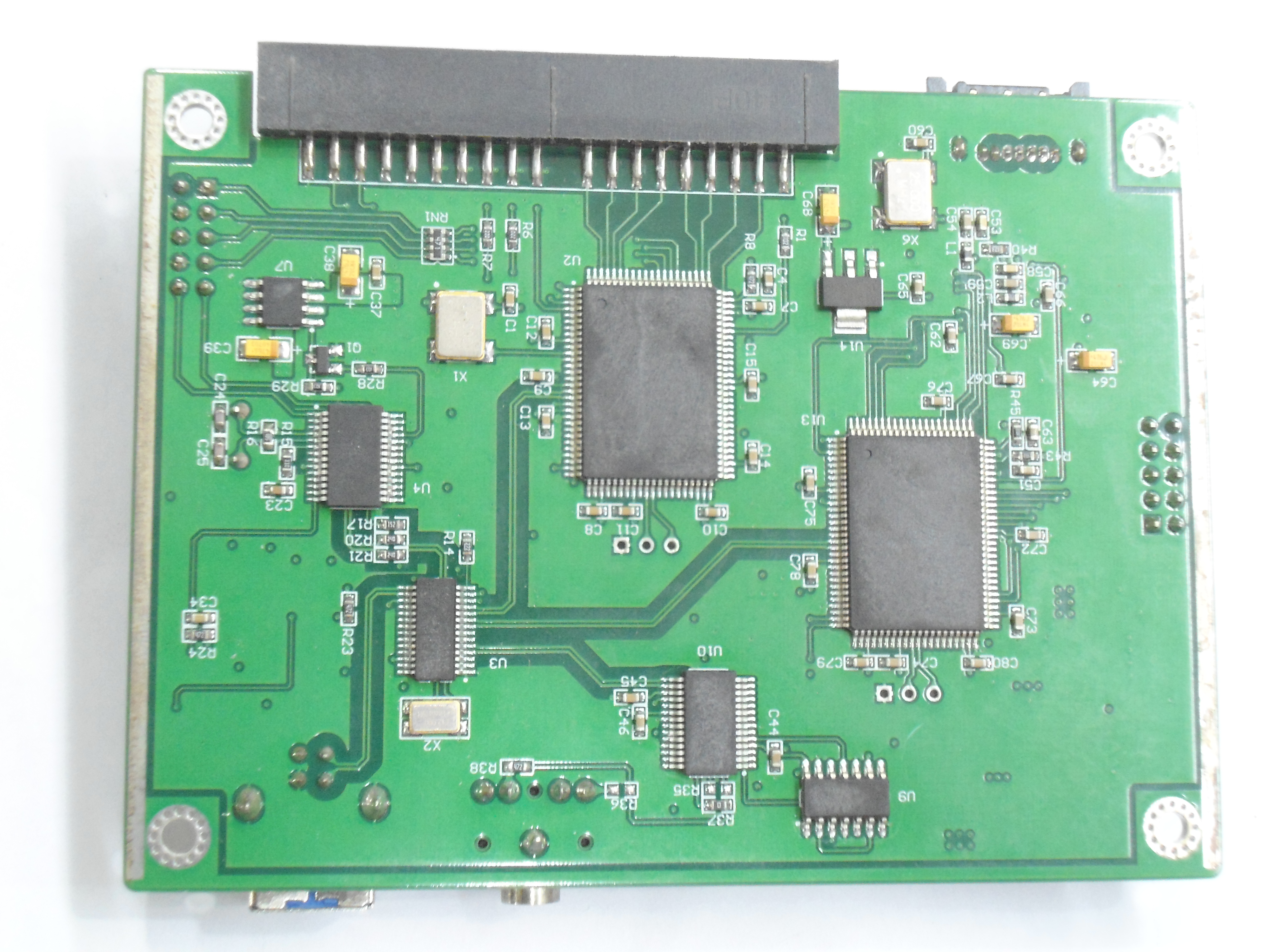

Here are my guesses as to the identities and functions of the ICs on the logic PCB:
    U1/U12 = 24Cxx
    U2/U13 = CY7C68013A
    U3 = XR22404
    U4 = 8-bit microcontroller ?
    U5 = ?
    U6 = ?
    U7/U8 = LDO regulator or load switch ?
    U9 = transceiver ?
    U10 = FT232R
    U11 = 88SA8040 / 88SA8052
    U14 = 3.3V LDO regulator
    X2 = 12MHz
    X6 = 25MHz
