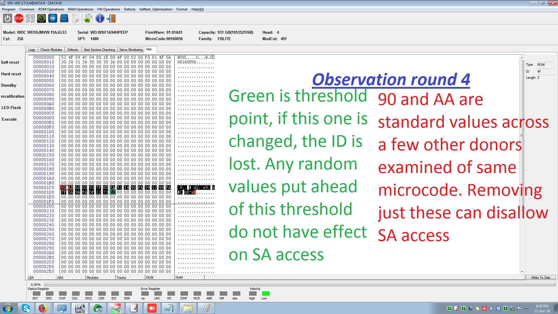

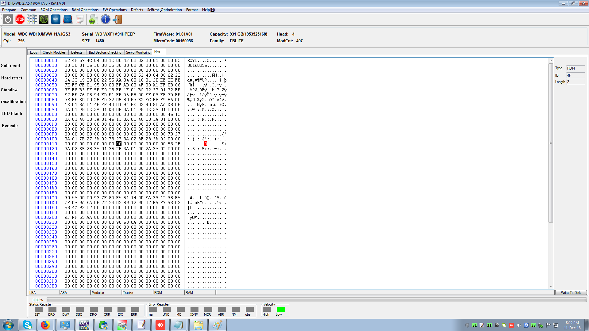

Hello every one,
I was tinkering around a JMVW. Following is the problem definition:-
Problem Definition:-
Take backup of a working Fblite of the entire SA and ROM by every way. Trying to use a donor rom of the same microcode and trying to ID the drive normally
Steps-Round 1
1) Fblite with normal operation was connected and SA+Rom was backed up nicely and zipped to preserve.
2) Donor rom code of same uC was flashed over the existing hdd.
3) Load ATA.
Observation-Round 1:-
Drive spins normally, DRD DSC. The moment after DRD DSC when auto get detailed button is clicked, the drive starts making high frequency scratching like noise (sssssssss)
No capacity and no ID, no mod access.
None of the loaders upload. Shows failed to upload.
Loading 01(original) in RAM and list fails to give SA access as the light status changes from DRD DSC to DRD DSC DRQ.
Steps-Round 2
1)Get DRD DSC, go in kernel so SA is not sought. Bypass SA in ROM by manipulating mod 30 and reboot.
2)Faster DRD DSC, Auto get details.
3)Load ATA.
Observation-Round 2:-
1)DRD DSC status is achieved faster.
2)ATA LOADED nicely..all mods 11 etc etc.
Loaded 01(original) in ram and tried to access SA but same status flags are lit.
Tried to read tracks. No luck..
Steps-Round 3
1)Flash Donor ROM code again to neutralize all changes done previously.
2)One by one patch each and every original rom module to see where the drive IDs.
Observation-Round 3:-
It was Module 4F that is solely required to get access to SA. Drive IDed normally after 4F is put. SA access is independent of every other module (depending unless you wish to bypass 30).
The moment original 4F is patched, there is all christmas but when donor 4F is used, the drive loses its ID.
With original 4F drive is not at all noisy. Non original 4F causes noise in such drives SYMPTOM TO BE NOTED.
Steps-Round 4
1)Get drive to ID normally by using original modules.
2)Analyze original 4F and eliminate blocks of data by zero filling and generating checksum and writing it back to locate important portions which enable the heads to read the data.
Observation-Round 4:-
The required region is located in the displayed offset as highlighted in the pictures.
Now the noises are a little different as each bit is zero filled from right to left one by one and the ID is checked. As it tends to the threshold digit, the SA access becomes a slower process as the adaptive are lost. If the threshold digit is changed, ID is lost.
Conclusion:-:-
The highlighted area in the edited 4F photograph displays the threshold point. Any change made beyond this point has less effect on the SA. Any changes made before this point or at this point can disallow SA access.
Thanks.

Could you upload the BIN file for module 0x4F? ISTM that, rather than deleting bytes at random, we should try to make sense of any groups of data. For example, I can see that there are several sections consisting of 4 records, where each record is associated with a particular head.

I had already started analysing a 4F module (see attachment). ICBW, but these are the groups as I see them.

I don't know what the following data mean. 0x55AA and 0x80AA, 0x90AA appear to be signatures of some kind.

@sin, I would compare your 0x4F modules against those from models with different numbers of heads. That should shed more light on the module's structure.

sin wrote:
Conclusion:-:-
This observations seems contrary to expectations. AIUI, this last section of the module contains the adaptives for the dual stage actuator. :?
https://forum.acelaboratory.com/viewtopic.php?t=9854

sin wrote:
Conclusion:-:-
viewtopic.php?f=1&t=35523
Possible, the conclusion can go wrong. Hence I need more people to try out chopping all the things in 4F but just staying consistent with the last portion and further comment on functionality.
