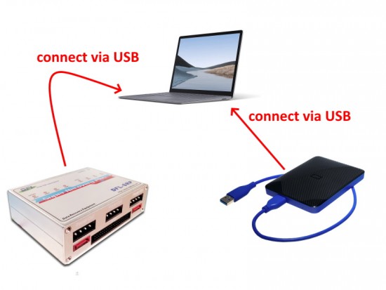

Hello HDD_Jason. Sorry but do you mean that DFL SRP can handle drives not connected directly to it, as long as it is connected via USB to the same PC? Something like this picture?

@bledaone, the message you replied to is 4 years old! However, yes, SRP can work on USB drives connected to a PC that SRP is also connected to -- if the USB drive is detected and doesn't cause Windows to freeze. If it is unstable, it would be best to transfer the USB drive's ROM to a compatible SATA PCB and fix firmware issues and clone the drive. The clone will likely be encrypted but the SRP can usually decrypt it directly.
Yes, because I just researched Deepspar USB Stabilizer and found your post in your blog recently, hehe. This answer clears my doubt, thanks a lot, Larry :)
