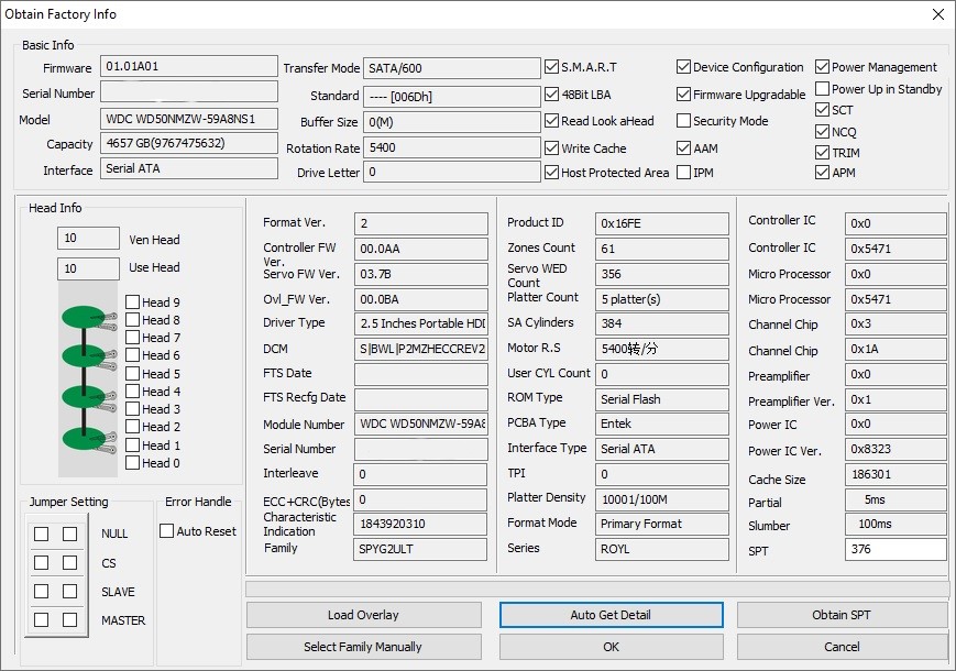

Request Modules WD WD50NMZW-59A8NS1 / WD Black P10 GameDrive
Tested Defective Modules By ID using DFL-PCIe and Dolphin Data Labs Unlock PCB 2060-810035.
Following Modules Failed and Need Backup of them from a Donor Drive in Good Working Conditions.
24, 6F, 123, 123, 124, 125, 126, 189, 190, D002 & D003
Already Backed Up Whole SA & ROM - ROM DATA Before Touch Anything.
