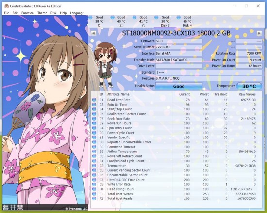

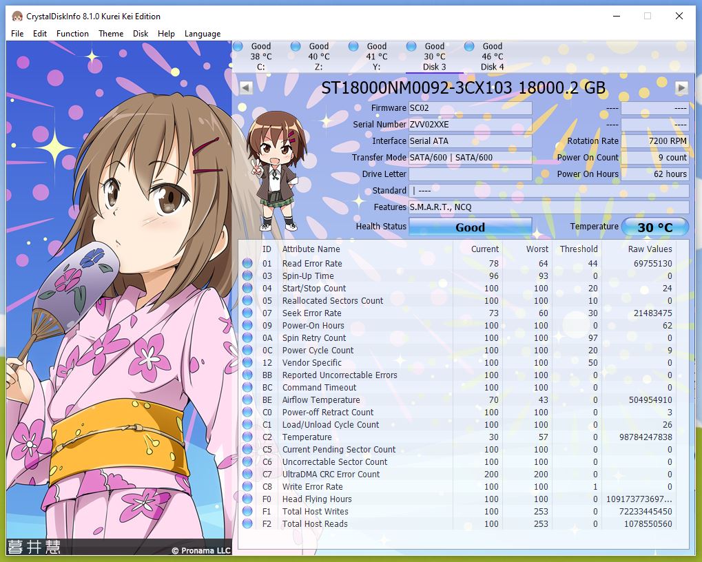

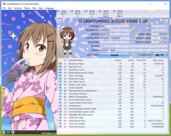

Got two rare dual actuator drives with even more unique SC02 firmware. Now searching for an updated firmware. The only relatable firmware for this model I can find is SN03 which is not compatible.
With some research I found that firmwares starting with SC may come from Lenovo, but I'm still not sure about it, and there is no mention of dual actuator drives from any lenovo docs.
Anyone has any clue about it? Thanks.

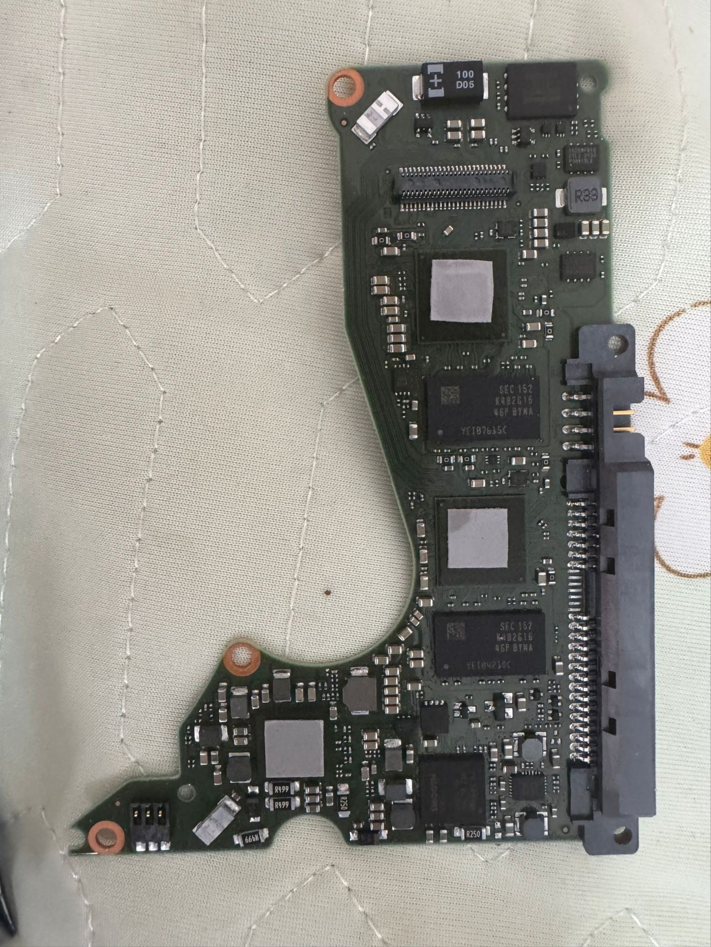

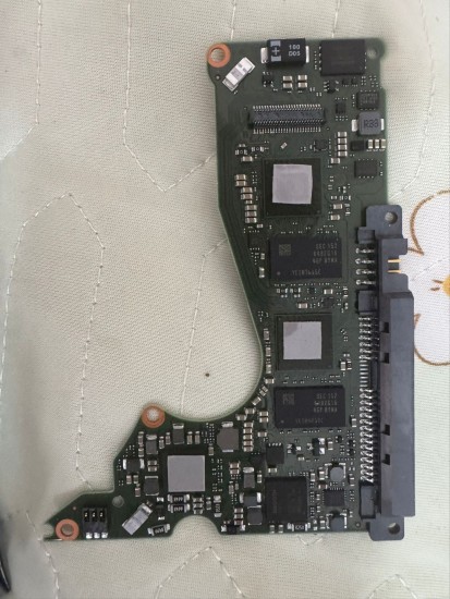

Would you be able to upload photos of the PCB, component side?

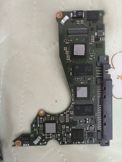

Here.

does this thing show up as two luns on the bus?
it seems like there are 2 complete controllers for each actuator, just as if it was 2 hdds except for the spindle...

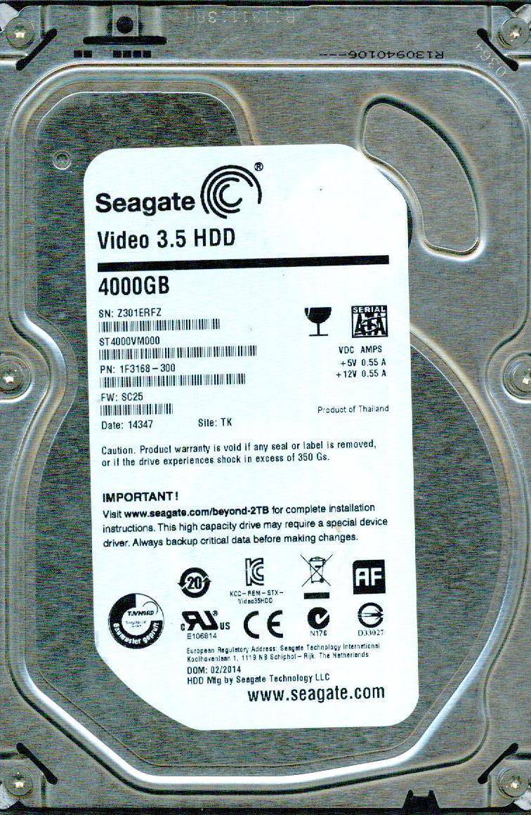

I thought Lenovo firmware versions were LVnn, not SCnn.
Here is an SC25 video drive that has no hint of Lenovo OEM branding:
https://i.ebayimg.com/images/g/lLoAAOSwCtJaRAbg/s-l1600.jpg
