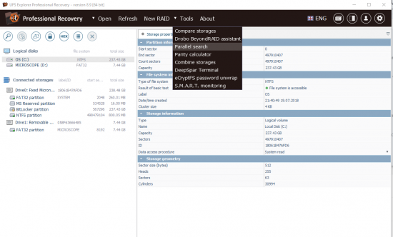

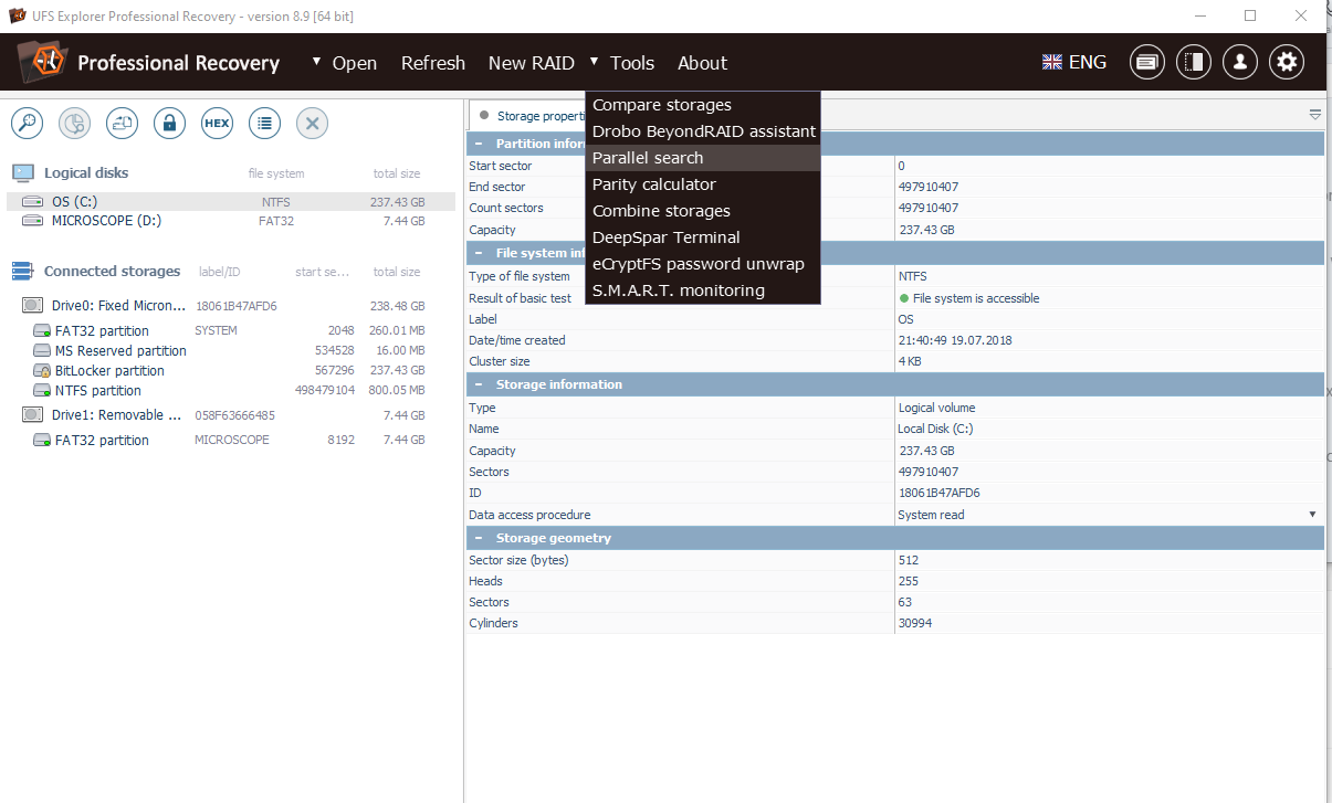

 Post subject: Re: How to find different content of two partitions?
PostPosted: December 15th, 2020, 10:03
UFS explorer has a function too.
