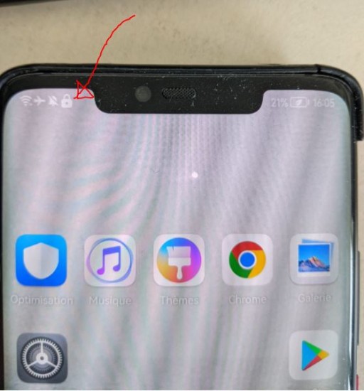

1. Huawei LYA-L29 - Mate 20 Pro - Device is working, booting.. I can enter the secure schema and unlock it but there's another lock that always stay. Customer doesn't know what secure schema he set.. so he can not access most of the app. When connected to PC, device is detected but doesn't allow transfer. This seems to be a specail security implemented by Huawei. When trying to enable USB debugging, it's asking for "secure schema"... customer doesn' know it.. it's not the same as the main one... so I can't access via adb function.

adding a pics of locked Huawei P20 Pro. Maybe I should start another post under forensics
