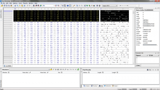

Here one of sample of header:
- Attachments
December 10th, 2017, 10:28
Well, that looks like a legit MOV header... (You can verify this by comparing it with the header of a few valid MOV files.)
Can you provide a bit of a context ? How were those files obtained and what is the likely cause of corruption ? (I assume that those files can't be read with well-known media players, and media analyzers don't show valid video properties.) If they were carved as raw files (i.e. without filesystem informations, if the MFT or equivalent was corrupted/overwritten) on a volume which was highly fragmented [*], then it's going to be very hard if not impossible to recover them even partially (if there's only a valid header and then random data from other files, no magic program can turn that into a readable video). Does that MP4repair.org website show you a promising preview ? If it does, then Grau Video Repair should be able to get approximately the same result.

Were these by any chance recovered by file signature from a camera memory card? Something like a GoPro for example.

@abolibibelot Only mp4repair.org website can show preview and I can download a sample...
@data-medics unfortunately I can not access to source of files like raw image or else

You still didn't say what could be the likely cause of corruption, or how those files were obtained in the first place... Are they truncated at the end, or are there unreadable sectors, or could it be due to fragmentation, or you don't know ? With the hex editor do you see what seems to be video data all the way to the end, or is it interrupted by empty sectors, or text, or recognizable patterns from other file types ? Do you have at least one functional video file obtained the same way ?
With Grau Video Repair you need to provide a sample of a functional video file with the same characteristics (shot with the same device, or created with the same software, using the same parameters – I don't know what happens when the provided sample has different characteristics). Their
guide is quite thorough and straigthforward.
