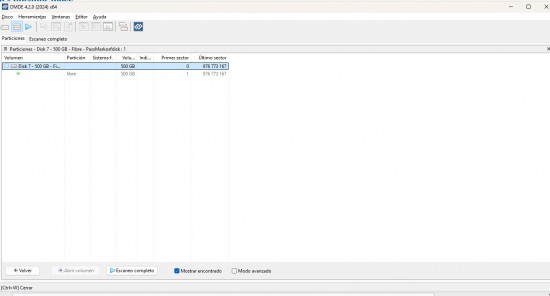

 Post subject: Help please - gpt-mbr mess
PostPosted: Yesterday, 20:19
Joined: Yesterday, 20:16
Location: Bolivia
Hi, please if somebody can help me, i need to recover an mbr partition from a disk that was converted to gpt by mistake, I have tried testdisk, but it doesn´t show me anything, as if it was unpartitioned, any other program or technique I could use?
 Post subject: Re: Help please - gpt-mbr mess
PostPosted: Yesterday, 21:02
Posts: 16977
Show us the Partitions tab in DMDE:
https://dmde.com/
 Post subject: Re: Help please - gpt-mbr mess
PostPosted: Yesterday, 22:07
Joined: Yesterday, 20:16
Location: Bolivia
Show us the Partitions tab in DMDE:
https://dmde.com/
Untitled-2.jpg [ 88.29 KiB | Viewed 31 times ]
 Post subject: Re: Help please - gpt-mbr mess
PostPosted: Today, 13:09
Posts: 16977
What sort of disk is this? Model number? Virtual drive? "Passmarkosfdisk"?
Users browsing this forum: No registered users and 1 guest
