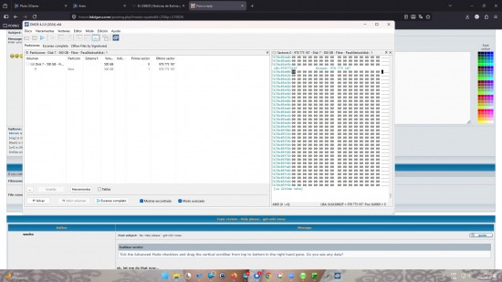

 Post subject: Help please - gpt-mbr mess
PostPosted: June 23rd, 2026, 20:19
Joined: June 23rd, 2026, 20:16
Posts: 7
Location: Bolivia
Hi, please if somebody can help me, i need to recover an mbr partition from a disk that was converted to gpt by mistake, I have tried testdisk, but it doesn´t show me anything, as if it was unpartitioned, any other program or technique I could use?
 Post subject: Re: Help please - gpt-mbr mess
PostPosted: June 23rd, 2026, 21:02
Posts: 16982
Show us the Partitions tab in DMDE:
https://dmde.com/
 Post subject: Re: Help please - gpt-mbr mess
PostPosted: June 23rd, 2026, 22:07
Joined: June 23rd, 2026, 20:16
Posts: 7
Location: Bolivia
Show us the Partitions tab in DMDE:
https://dmde.com/
Untitled-2.jpg [ 88.29 KiB | Viewed 323 times ]
 Post subject: Re: Help please - gpt-mbr mess
PostPosted: Yesterday, 12:52
Joined: June 23rd, 2026, 20:16
Posts: 7
Location: Bolivia
wacho wrote:
Show us the Partitions tab in DMDE:
https://dmde.com/
it didnt find anything :/
 Post subject: Re: Help please - gpt-mbr mess
PostPosted: Yesterday, 13:09
Posts: 16982
What sort of disk is this? Model number? Virtual drive? "Passmarkosfdisk"?
 Post subject: Re: Help please - gpt-mbr mess
PostPosted: Yesterday, 17:16
Joined: June 23rd, 2026, 20:16
Posts: 7
Location: Bolivia
What sort of disk is this? Model number? Virtual drive? "Passmarkosfdisk"?
it was an hitachi, but the pins got all busted so I had to make an image, and I dont remember the model :/
 Post subject: Re: Help please - gpt-mbr mess
PostPosted: Yesterday, 17:39
Posts: 16982
Tick the Advanced Mode checkbox and drag the vertical scrollbar from top to bottom in the right hand pane. Do you see any data?
 Post subject: Re: Help please - gpt-mbr mess
PostPosted: Yesterday, 18:43
Joined: June 23rd, 2026, 20:16
Posts: 7
Location: Bolivia
Tick the Advanced Mode checkbox and drag the vertical scrollbar from top to bottom in the right hand pane. Do you see any data?
ok, let me do that now...
 Post subject: Re: Help please - gpt-mbr mess
PostPosted: Yesterday, 19:39
Joined: June 23rd, 2026, 20:16
Posts: 7
Location: Bolivia
Tick the Advanced Mode checkbox and drag the vertical scrollbar from top to bottom in the right hand pane. Do you see any data?
none :/
Untitled-1.jpg [ 589.02 KiB | Viewed 215 times ]
 Post subject: Re: Help please - gpt-mbr mess
PostPosted: Yesterday, 20:31
Posts: 16982
If the disk was converted to GPT, then why is there no GPT metadata?
 Post subject: Re: Help please - gpt-mbr mess
PostPosted: Yesterday, 20:53
Joined: June 23rd, 2026, 20:16
Posts: 7
Location: Bolivia
If the disk was converted to GPT, then why is there no GPT metadata?
thats what I´m asking, no gpt or mbr, is there a way to recover old data from there?
 Post subject: Re: Help please - gpt-mbr mess
PostPosted: Today, 9:31
Posts: 16982
How can you expect to recover anything from an image full of zeros? Even if your drive was TRIM-ed after formatting, it should still have a file system. Your story makes no sense.
