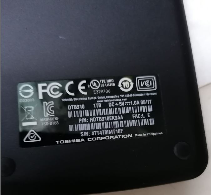

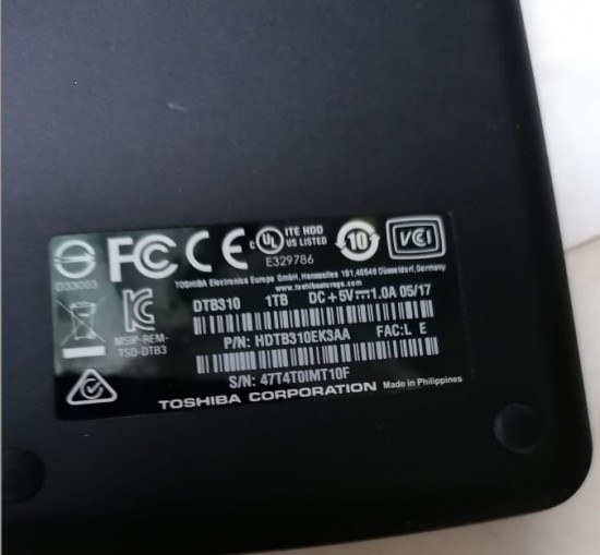

Here is the backside of the external case of the hdd

Backside of the plastic enclosure is less meaningful than the specs on the drive's cover.
"A" in the model means ATA(SATA), while "U" in the model means USB, like you have in your case.
So, if the rest of the numbers are virtually the same, then the drives are likely compatible.
You have all the information you need for DIY, so it is a matter of putting the plan together and executing.
Though the mechanical work is probably the least problematic. The cloning process will likely give you more headaches.
For DIY home, recommend HDDSuperClone, so you will have to put the Linux hat on for that, too, which will require yet another storage drive for cloning destination, and then a 3rd drive to store the recovered files on once scanning with data recovery software.
Before carrying on with the mechanical practice on the donor drive, familiarize yourself on the donor drive using HDDSuperClone. Why? Because, you don't want to learn that while using your friend's damaged drive. On a damage drive, time is of the essence before the reading heads may die again. So you learn utilizing the software on the donor, as it is stable and easier to work with.
As previously mentioned in the post before, practice is key for everything.
Most people underestimate the process difficulty and screw up badly, wasting time, money on parts and so on.
Good luck.
Yes, but the thing is, that the hdd "MQ04UBF100" is in an extermal case. I think, you can`t buy this drive like a nonexternal. The chance, that you get the drive I need when I buy the external drive with the SN or model number is higher than yo search for a nonexternal - or what do you think?
What do you mean? If the drive is "MQ04AF100", is it compatible?? If the disk is S-ATA or USB is equal in realtion to the r/w headers, right?

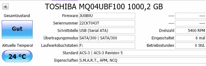

I have ap question, I have an external Drive which ist the same model. How can I read out drive revision etc? With which Tool?
 Post subject: Re: HDD doesn`t work
PostPosted: June 24th, 2022, 19:40
In your case, drive revision is not relevant in parts compatibility.
Toshibas are pretty forgiving when it comes to mechanical compatibility.

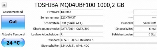

Here is the photo
