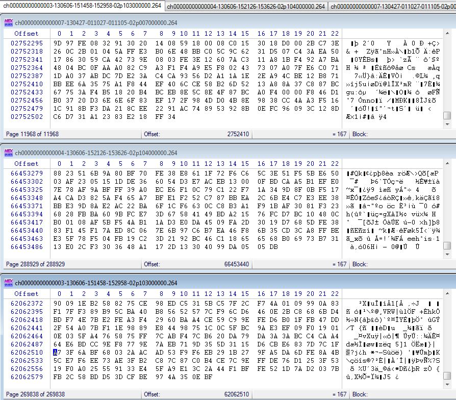

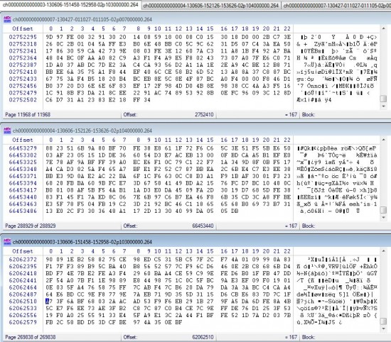

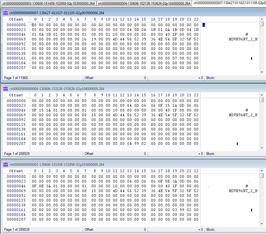

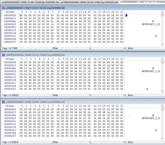

Hi to All,
I have DVR model 7604ED-NA, made in Chine. On HDD there is 3gb Linux partition and rest of the drive is RAW space with video data.
I do a test, format the drive and do a 10-15 min video and take the dive out and image it. Now I want to recover videos that are on the drive before format. I was using R-Studio and UFS Explorer without success.
In attachment I include print screen from 3 videos that I download from DVR box on local HDD, first one is beginning of HEX and second is end on files.
Can some one help me with guidance how to continue?
Thanks in advance.

because its linux the format is going to be mkv or H. 264
this is more likely going to be split up diffrent size video files
go to the manufactory website and find the specs for your dvr
this will show you what format is supported.
R-Studio should had work as it does work with linux
