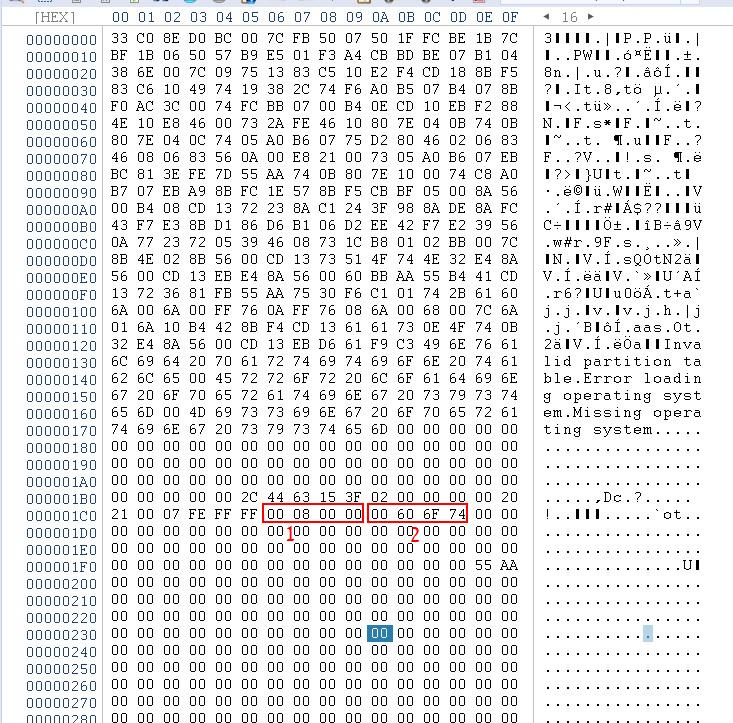

OK. I finally figured out how to use different disk editing tools to find and distinguish between the Master Boot Record and the Volume Boot Record. I have included a screen shot of a MBR for my Windows 8 laptop. I went to the very bottom of the sector to where the partition table is. I can't find the "80" that is supposed to be there for a bootable partition. Can someone please show me where the partition hex code is located for this partition table?
Thanks, Jonathan

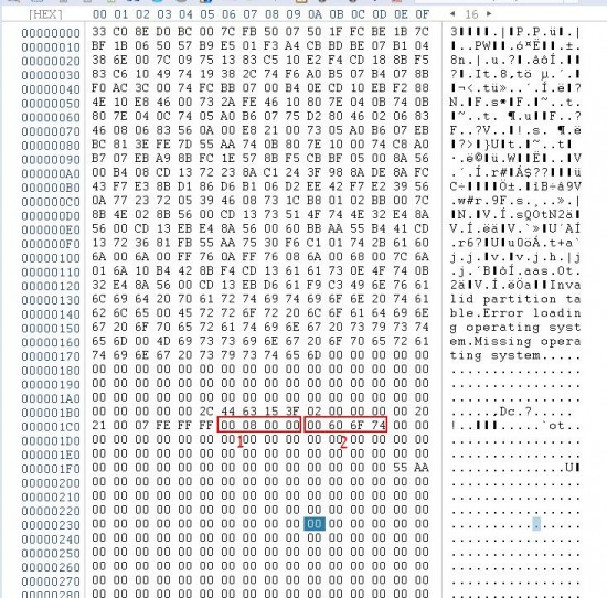

partition begins @ sector 2048 (1)
partition length 1953456128 sectors (2)
 Post subject: Re: Windows 8 MBR Partition Information
PostPosted: July 30th, 2015, 16:31
Posts: 17330
0x746F6000 = 1 953 456 128
That's the size of the partition, not the end sector.
http://thestarman.pcministry.com/asm/mbr/PartTables.htm
agreed
