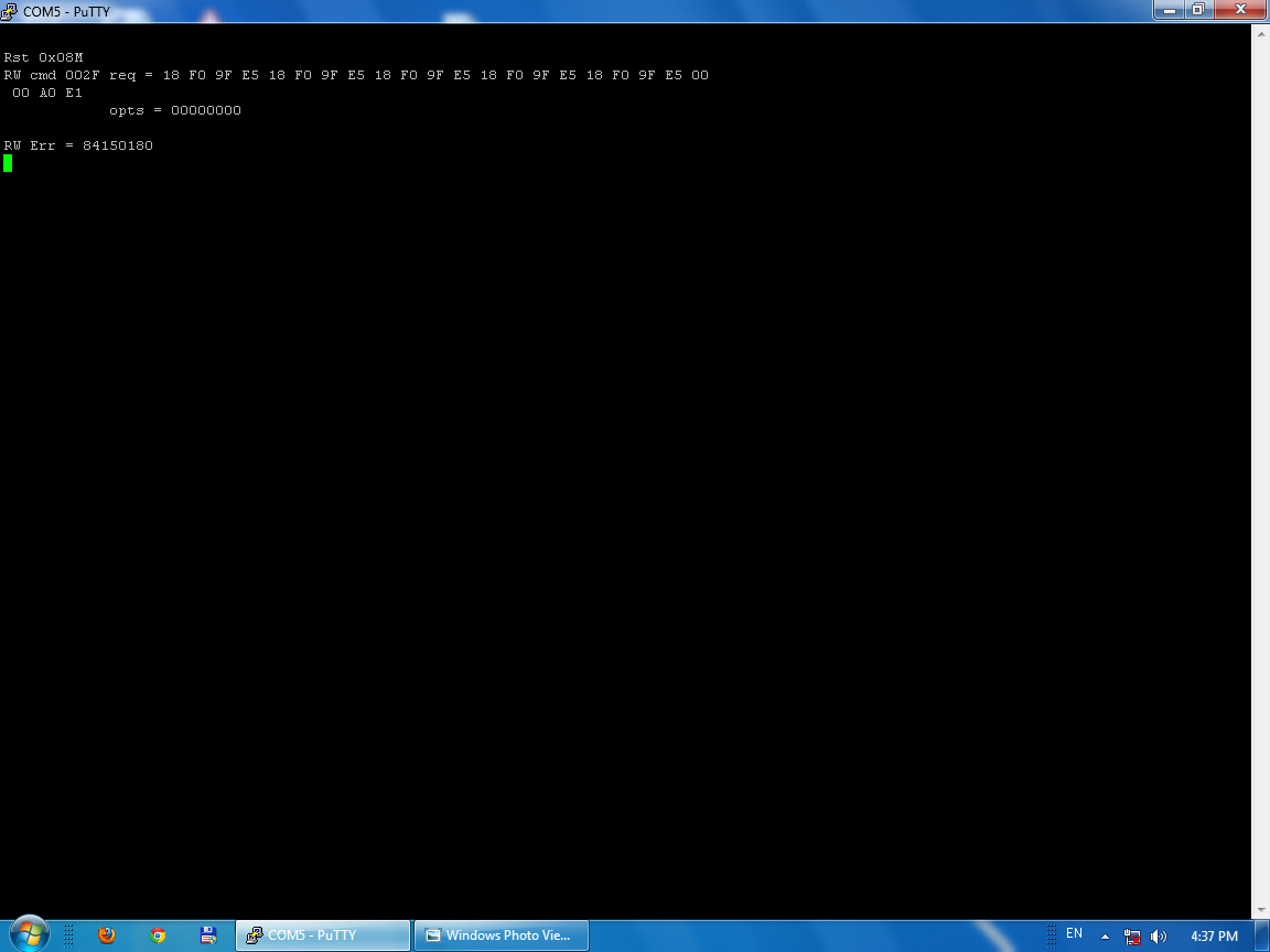

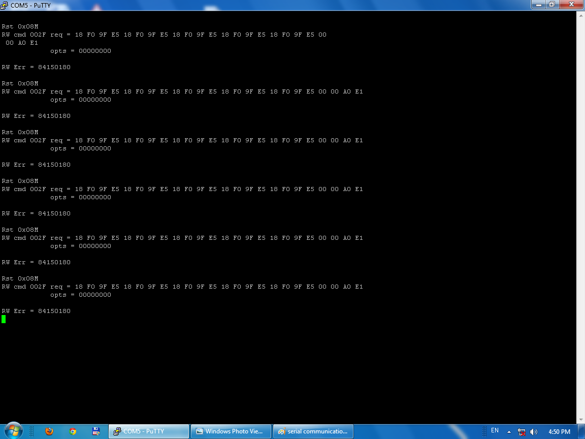

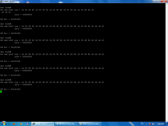

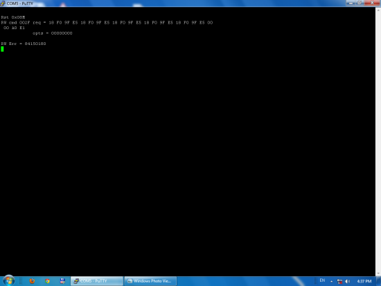

Usb to ttl adapter works. The result is in the attached file. Firstly, I must tell you some background. When I turn on power supply, the drive spins for a while then stops spinning. After that I cannot communicate via terminal program(putty) any more.
Thanks.

 Post subject: Re: seagate momentus terminal configuration
PostPosted: December 11th, 2013, 19:06
Posts: 3977
You cant communicate... Does this mean that Control+R does not give Online Mode, and Control+Z does not give F3 T> prompt(if it is an F3 drive)?
yes, right.

Spildit wrote:
Terminal is working as it should.
Drive is damaged as expected.
Do you need the data from the drive or what are you trying to do ?
I need the data from it. Is it possible? If yes, how? Thanks.

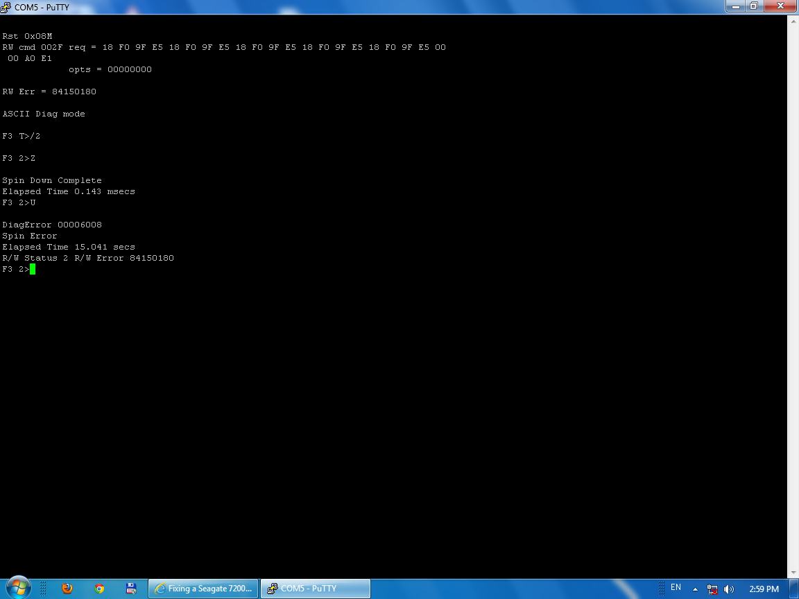

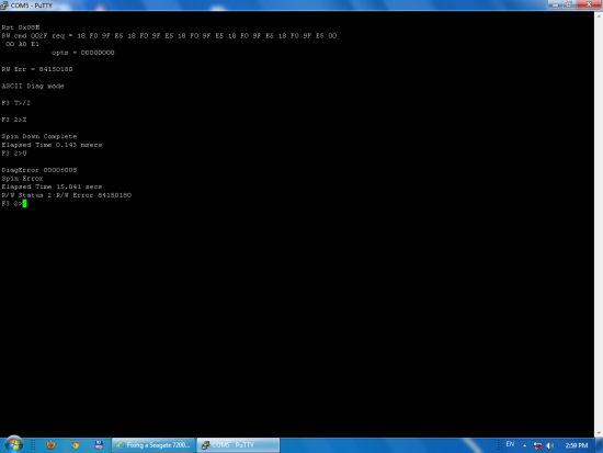

last time, I did something wrong so, i cannot issue any command. Now, I know and I try it again. The result is as follow:
what is your comment?
PostPosted: December 15th, 2013, 17:31
Bad heads.
