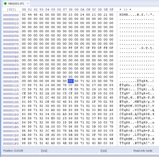

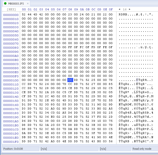

Here's the file:
https://www.dropbox.com/s/a0tycw1d6jlu7fn/MB00003.IFS
also attaching the screenshot showing its very beginning.
"71 52" seems to be a delimiter of sorts, because it appears constantly throughout the whole "timestamps" section.
There seems to be some data present, starting from 0xA100 - again bytes separated by delimiters.
The interesting things start from 0x10801B. First, we have the plain-text "Flags" - and then, a lot of data which seems not to be confined between delimiters. Could this be the video stream?
File comment: Content view

Thanks for your help, guys! Here goes a small update:
I've managed to find h264 data, can be identified by 0x000001 67 - NAL sequence delimiter. FFmpeg plays the streams, the problem is - they're all mixed up. If I carve the h264 part from the .IFS file and try to play the stream - the ffmpeg will decode frames, but the 8 video channels will alternate consecutively - apparently the DVR simply dumps all the video inputs into one .IFS file, fills it, then moves on to the next IFS etc.. Considering that a 2TB HDD keeps ~16000 of these, manual search for a particular stream seems an arduous task.
Is there anything that could help in identifying the timestamps/channels and/or could automate the h264 extraction process?
HaQue, I managed to find your post about the Australian guy, am I right? You provided his webpage IIRC. Will try to contact him as you suggested.
 Post subject: Re: DVR HDD - file carving
PostPosted: November 28th, 2013, 18:57
Posts: 17368
Without regard to any known structures, these are the patterns that appear to be present throughout the file.
Offset(h) 00   02   04   06   08   0A   0C   0E
00000000  5244 4D42 0000 0000 2300 2400 2100 2200  RDMB....#.$.!.".

0000A140  58000A01 60001E01 68003501 70004A01  X...`...h.5.p.J.
0000A150  78005F01 80007411 8800BB01 9000C901  x._.€.t.ˆ.»...É.
0000A160  9800D701 A000E501 A800F401 B0000402  ˜.×. .å.¨.ô.°...
0000A170  B8001302 C0002102 C8002F02 D0003A02  ¸...À.!.È./.Ð.:.
0000A180  D8004902 E0005902 E8006B02 F0007A02  Ø.I.à.Y.è.k.ð.z.
0000A190  F8008A02 00019712 0801DF02 1001EE02  ø.Š...—...ß...î.
0000A1A0  1801FC02 20010A03 28011903 30012503  ..ü. ...(...0.%.
0000A1B0  38013703 40014603 48015403 50016303  8.7.@.F.H.T.P.c.
0000A1C0  58017303 60018303 68019603 7001A603  X.s.`.ƒ.h.–.p.¦.
0000A1D0  7801B703 8001C413 88010A04 90011804  x.·.€.Ä.ˆ.......
0000A1E0  98012804 A0013B04 A8014B04 B0015804  ˜.(. .;.¨.K.°.X.
0000A1F0  B8016904 C0017504 C8018304 D0019004  ¸.i.À.u.È.ƒ.Ð...
00107F00  00 3C 04 00 20 11 00 02 01 00 00 00 60 01 00 00  .<.. .......`...
00107F10  00 00 00 00 08 00 18 00 10 00 2C 00 18 00 41 00  ..........,...A.
00107F20  20 00 56 00 28 00 65 10 30 00 B1 00 38 00 C0 00   .V.(.e.0.±.8.À.
00107F30  40 00 CE 00 48 00 E5 00 50 00 FA 00 58 00 13 01  @.Î.H.å.P.ú.X...
00107F40  60 00 2B 01 68 00 3A 01 70 00 46 01 78 00 55 01  `.+.h.:.p.F.x.U.
00107F50  80 00 64 01 88 00 79 01 90 00 91 01 98 00 A9 01  €.d.ˆ.y...‘.˜.©.
00107F60  A0 00 BE 01 A8 00 CC 11 B0 00 16 02 B8 00 23 02   .¾.¨.Ì.°...¸.#.
00107F70  C0 00 30 02 C8 00 44 02 D0 00 57 02 D8 00 6C 02  À.0.È.D.Ð.W.Ø.l.
00107F80  E0 00 7E 02 E8 00 8E 02 F0 00 9D 02 F8 00 A9 02  à.~.è.Ž.ð...ø.©.
00107F90  00 01 B8 02 08 01 CE 02 10 01 E1 02 18 01 F6 02  ..¸...Î...á...ö.
00107FA0  20 01 0D 03 28 01 1B 13 30 01 66 03 38 01 74 03   ...(...0.f.8.t.
00107FB0  40 01 84 03 48 01 9B 03 50 01 B2 03 58 01 C6 03  @.„.H.›.P.².X.Æ.
00107FC0  60 01 DC 03 68 01 EC 03 70 01 FC 03 78 01 0A 04  `.Ü.h.ì.p.ü.x...
00107FD0  80 01 18 04 88 01 2D 04 90 01 40 04 98 01 54 04  €...ˆ.-...@.˜.T.
00107FE0  A0 01 69 04 A8 01 79 14 B0 01 C0 04 B8 01 CF 04   .i.¨.y.°.À.¸.Ï.
00107FF0  C0 01 DE 04 C8 01 F3 04 D0 01 08 05 D8 01 20 05  À.Þ.È.ó.Ð...Ø. .
00108000  0202 0000 0000 0000 037D 1120 CCDD 7152  .........}. ÌÝqR
00108010  D83E 5F00 0000 0000 7920 0946 6C61 6773  Ø>_.....y .Flags
00108020  0202 0101 8204 0000 017D 1120 CCDD 7152  ....‚....}. ÌÝqR
00108030  D83E 5F00 0000 0000 0000 0001 6742 801E  Ø>_.........gB€.
00108040  F40B 04A2 0000 0001 68DE 3C80 0000 0001  ô..¢....hÞ<€....
00108490  3BD9 969B F1EC FF7E 0180 6415 DDDD DDDD  ;Ù–›ñìÿ~.€d.ÝÝÝÝ
001084A0  C3A3 2DE4 5F80 61D3 EE21 C103 8DB7 2D20  ã-ä_€aÓî!Á..·-
001084B0  CA35 BA3E D08E 8F05 D699 F7EF FFFF EEF7  Ê5º>ÐŽ..Ö™÷ïÿÿî÷
001084C0  0202 0101 0D01 0000 0085 1120 CCDD 7152  .........…. ÌÝqR
001084D0  D88E 905A 0000 0000 0000 0001 619A 2506  ØŽ.Z........aš%.
001084E0  FD74 FFFE 0ABC 15D0 D6FF FFFF FD5F FFFA  ýtÿþ.¼.ÐÖÿÿÿý_ÿú
001084F0  BFFE AFF5 7FA3 3F5E F55A 93D6 BA3B 5756  ¿þ¯õ.£?^õZ“Öº;WV
00108500  FAB3 EBD5 D7BE AFF5 FFD5 FEAF F57F ABF3  ú³ëÕ×¾¯õÿÕþ¯õ.«ó
001085C0  EB7F ADFE AFF5 796F 11E2 BABD C57C 215B  ë.­þ¯õyo.⺽Å|![
001085D0  9627 5528 8DFD C547 6A3B 78C6 643F C749  –'U(.ýÅGj;xÆd?ÇI
001085E0  E119 06F8 DCEA EAEA EAEA EAEA EAEA EAEA  á..øÜêêêêêêêêêêê
07FFD200  0002 0101 3D01 0000 0001 1120 C0E7 7152  ....=...... ÀçqR
07FFD210  F036 7057 0000 0000 0000 0001 619A D906  ð6pW........ašÙ.
07FFD220  EB0C 7FFC 7782 6FFE 86BF D5FF FFFD 5FFF  ë..üw‚oþ†¿Õÿÿý_ÿ
07FFD230  FFF8 1E7C 09DE 340A 3D03 0ABC 90DE 4EAF  ÿø.|.Þ4.=..¼.ÞN¯
07FFD240  F57F ABFD 5FEA F5D5 FEAF ED5F 87F5 5EFF  õ.«ý_êõÕþ¯í_‡õ^ÿ
07FFD330  FF9B FF5E FFE1 9F0C F386 7C33 E17F 0BE2  ÿ›ÿ^ÿáŸ.ó†|3á..â
07FFD340  1053 10B8 85E0 D350 2E05 FC33 C341 9E18  .S.¸…àÓP..ü3ÃAž.
07FFD350  0CF5 E332 C08F F0ED 60E7 C1CA BF83 957F  .õã2À.ðí`çÁÊ¿ƒ•.
07FFD360  FFFF FFFF FFFF FFFF FFFF FFFF FFFF FFFF  ÿÿÿÿÿÿÿÿÿÿÿÿÿÿÿÿ
07FFD370  FFFF FFFF FFFF FFFF FFFF FFFF FFFF FFFF  ÿÿÿÿÿÿÿÿÿÿÿÿÿÿÿÿ
07FFD380  FFFF FFFF FFFF FFFF FFFF FFFF FFFF FFFF  ÿÿÿÿÿÿÿÿÿÿÿÿÿÿÿÿ
07FFD390  FFFF FFFF FFFF FFFF FFFF FFFF FFFF FFFF  ÿÿÿÿÿÿÿÿÿÿÿÿÿÿÿÿ
07FFD3A0  FFFF FFFF FFFF FFFE FFFF FEFF FFFF FFFD  ÿÿÿÿÿÿÿþÿÿþÿÿÿÿý
07FFD3B0  FFFF FFFF FFFF FFFF FFFF FFFF FFFF DFFF  ÿÿÿÿÿÿÿÿÿÿÿÿÿÿßÿ
07FFD3C0  FFFF FFFF FFFF FFFF FFFF FFFF FFFF FFFF  ÿÿÿÿÿÿÿÿÿÿÿÿÿÿÿÿ
07FFD3D0  FFFF FFFF FFFF FFFF FFFF FFFF FFFF FFFF  ÿÿÿÿÿÿÿÿÿÿÿÿÿÿÿÿ
