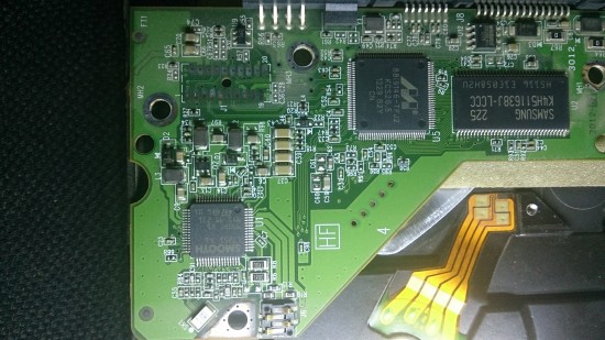

Last night this HDD wd30ezrx work fine i copied the data to other drive but at morning drive not showing in windows.i restart the computer no recognized in bios.HDD not powering up.
HDD stop spinning while computer was on

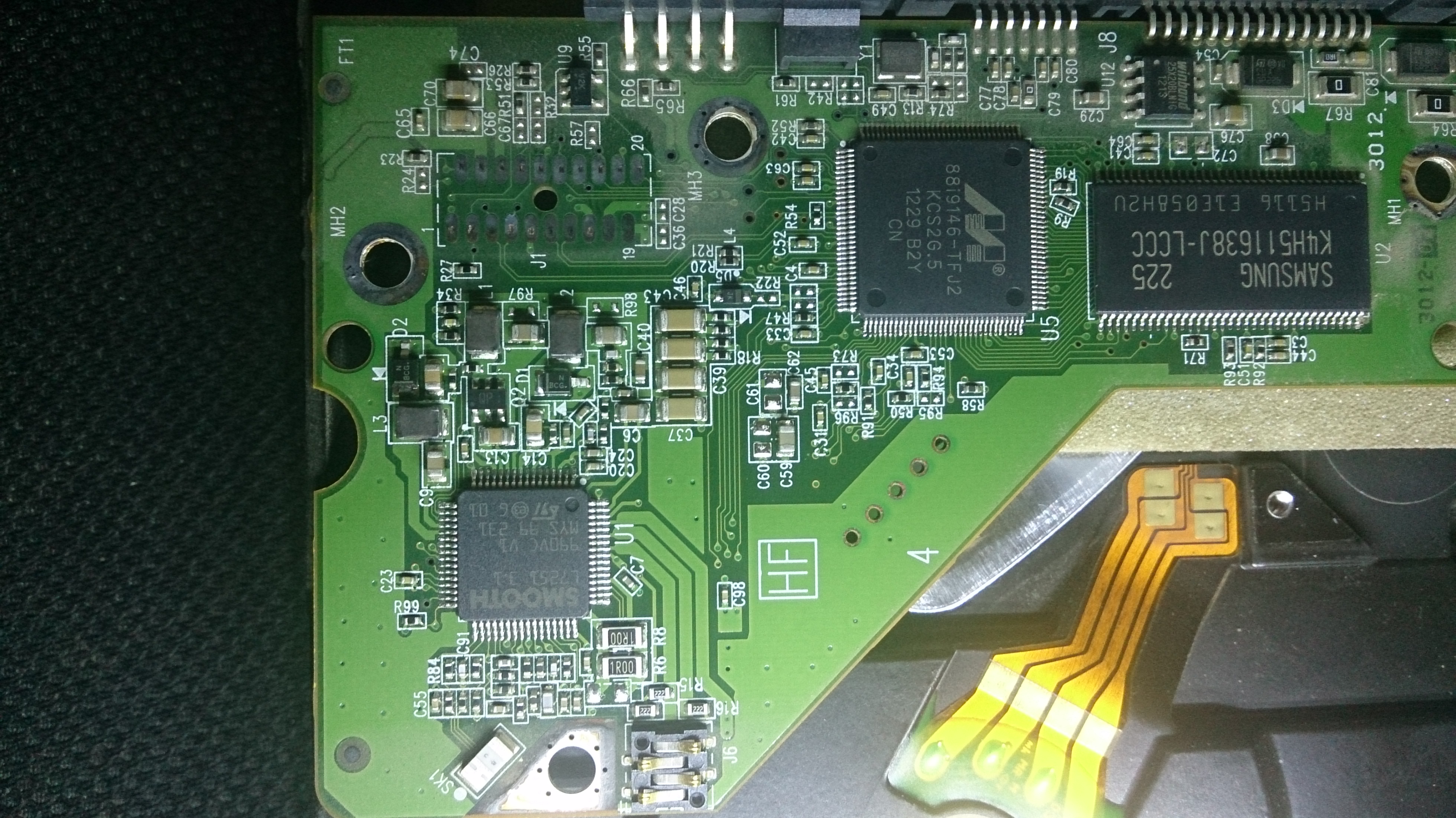

here is the pic

Swap ROM on a working PCB to get the data back

try cleaning the j1 contacts

i clean J1 contacts. Hard Drive start spinning there is no clickng or knocking sound but its showing 0MB in HD Tune and bios

Can you retrieve the drive's firmware modules?
http://sediv2008.narod.ru/Easy3.9Passwo ... 567890.rar
http://sediv2008.narod.ru/Settings.rar
