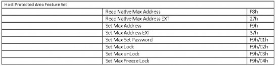

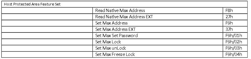

File comment: HPA SF-2281 addressing table

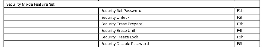

File comment: HPA SF-2281 Security addressing

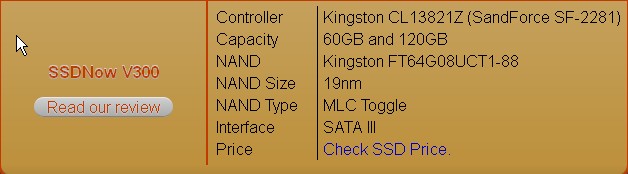

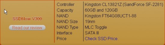

File comment: Sv300's controller model
