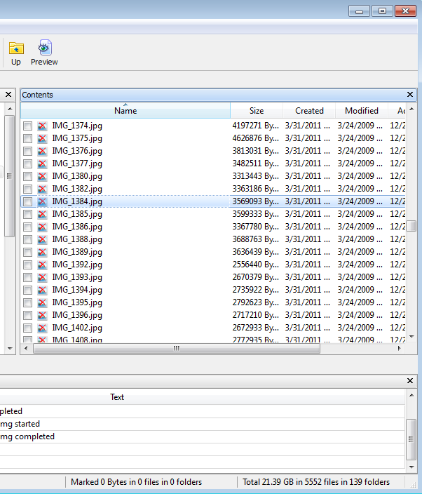

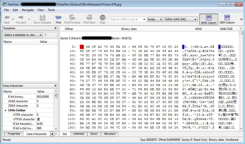

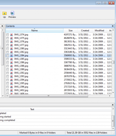

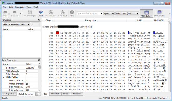

Hello.
I make an image from my HDD partition and Use "UFSexplorer" , "TestDisk" and "R-Studio" for open ".img" file and recovery it But, These tools can't recover my data. For example, They recover some "JPG" files but I can't open them and when I want to make a preview, "R-Studio" show me Hex viewer. Any idea to fix it?
I attached some photos.
Thank you.

Looks like the files were deleted and/or overwritten, the hex view shows it's not valid data for a jpeg.

Thus, Recover it is impossible?
Other JPG files that have not red mark are same problem :(

Spildit wrote:
Is the drive ok ?
Why are you using the recovery tools on it ?
Did you format the partition, just deleted the files or did you write to the partition with deleted files ?
Looks like you don't have valid data/header for a JPG.
Might be because you have written to the same partition from where you deleted the data, and if you didn't do so and the partition just disapeared then you might have a drive problem.
Unfortunately, The HDD is not OK and have some hardware problems. I used "partimage" tools for create an image from my partition and open .img file via "TestDisk" and...but the result is that you can see.
Some files can open and most of them can't. File have good size but not opened :(
