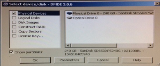

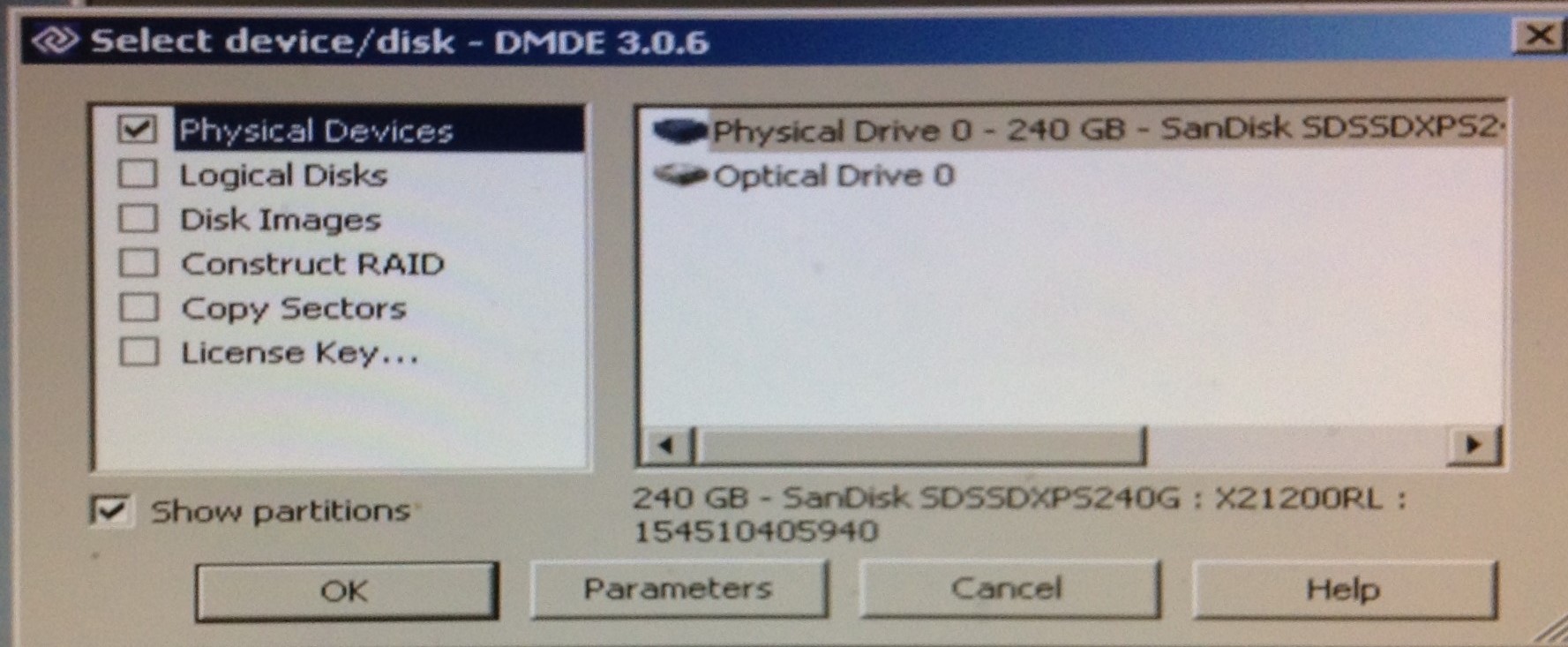

I installed Windows 7 Ultimate, the drive appears in the UEFI BIOS but Gparted (Linux), DMDE, PC Inspector (Windows) does not see it. I tried Ultimate Boot CD & SystemRescueCd but find them difficult to use, :?

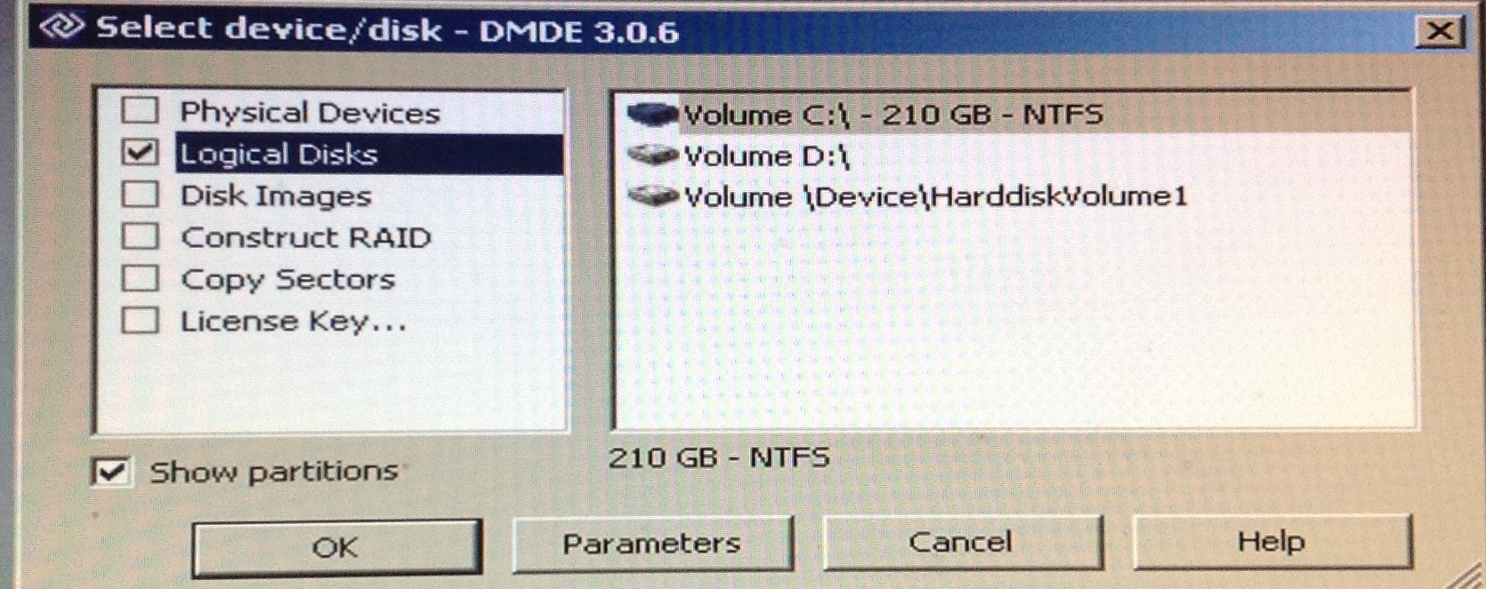

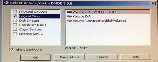

DMDE Screenshots:

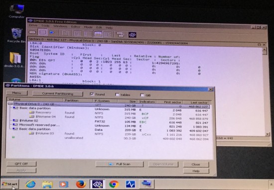

Re-inserted HDD into mobile rack & it showed up! Partitions window:

The partition layout is not what I was expecting. I was hoping that your original partitions would all have "BCF" indicators.
    B = boot sector at beginning of partition
    C = copy of boot sector at end of partition
    F = MFT (NTFS file system)

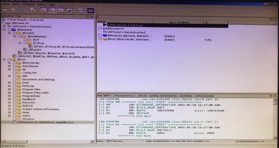

If you double-click "$Noname 04" and expand the Root, do you see your original file/folder structure? Or is this a remnant of an earlier build?

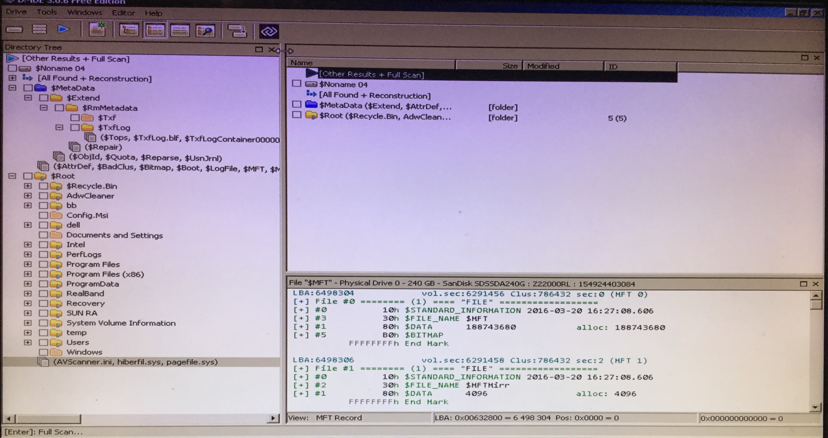

Wow! you guys are good, I can see my directory tree :D :

Select any folder, r-click it and select Recover the Object. Test the recovered files for integrity.
The freeware edition of DMDE will only recover a limited number of files. The full edition sells for US$20.
I think it may be possible to reconstruct the original logical volumes with a few mouse clicks, assuming that only the boot sector is missing. However, it would be safer to do this on the clone. BTW, DMDE can clone your drive, assuming it has no physical problems.
