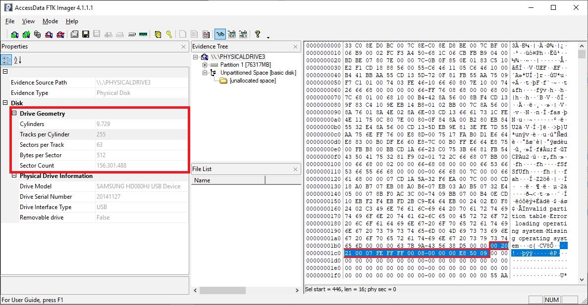

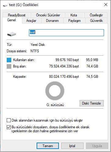

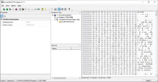

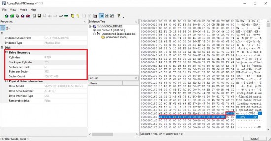

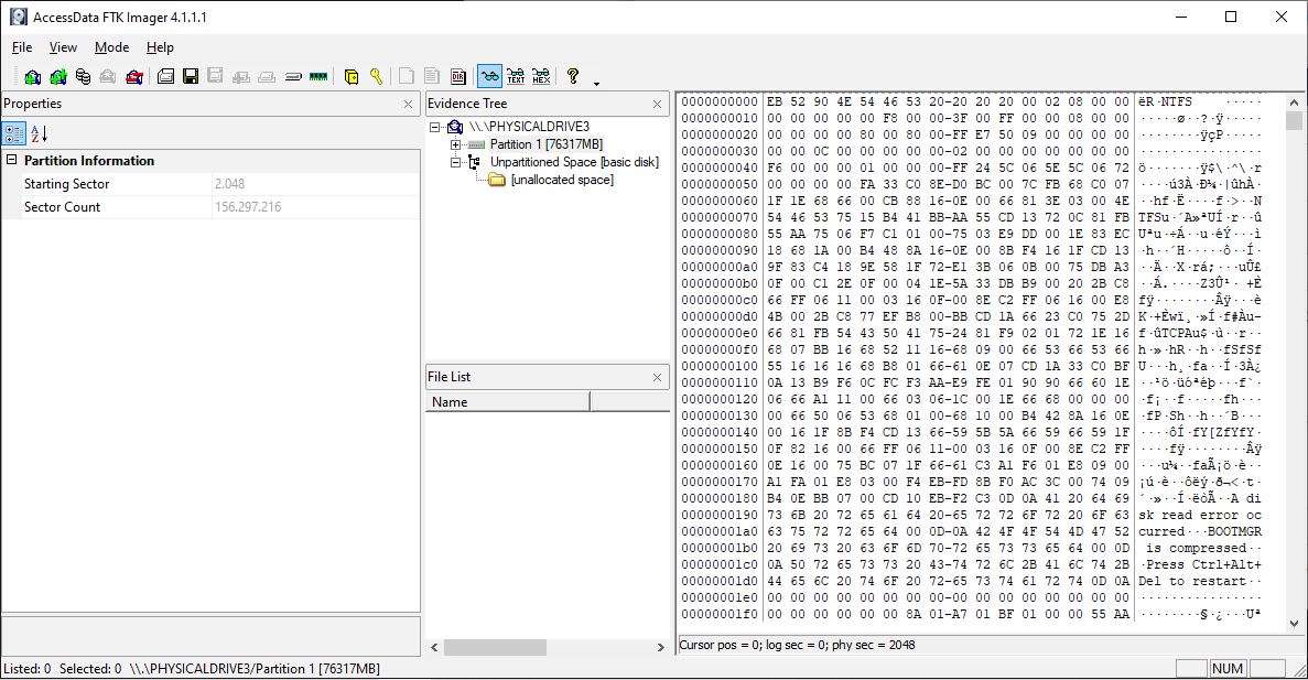

Drive LBA Count is: 156301488 (like fzabkar said)
I have formatted disk and there is just one partition. And when I look at the first sector on FTK Imager it says partition begins at sector 2048 and it is 156297216 sector length.
But when I look at the properties of drive on windows it says 80024170496 byte which equals to 156297208 sector.
I send screenshots. So why there is difference between FTK and windows?
