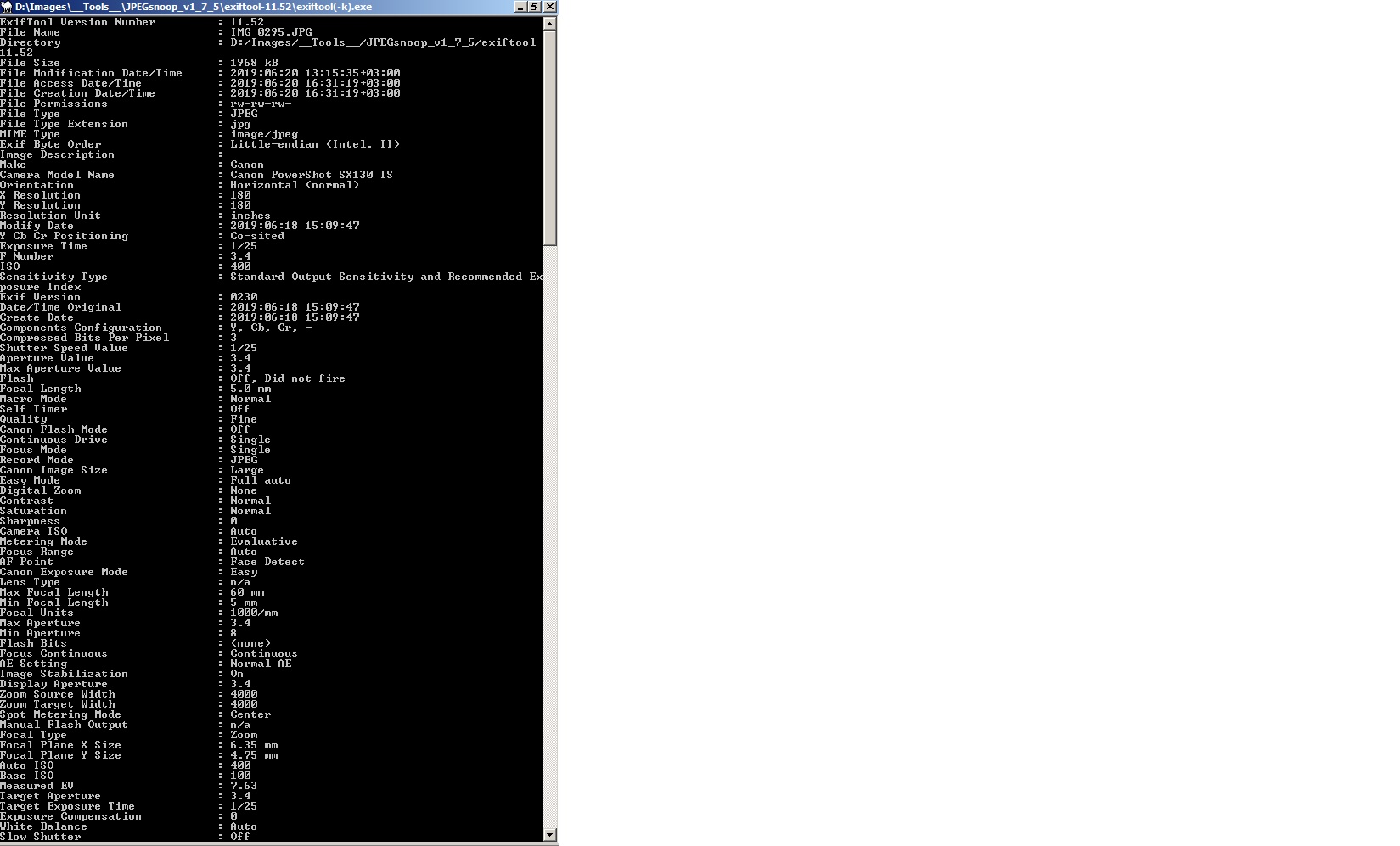

Hello guys,,
I was wondering if anyone knows if i have TWO identical Camera Models taking the same photo (some how)
is there any way to know if Photo-A been taken by Camera-A?
like a Lens Signature or something? (Image Exif)
thank you

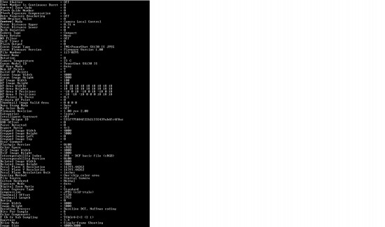

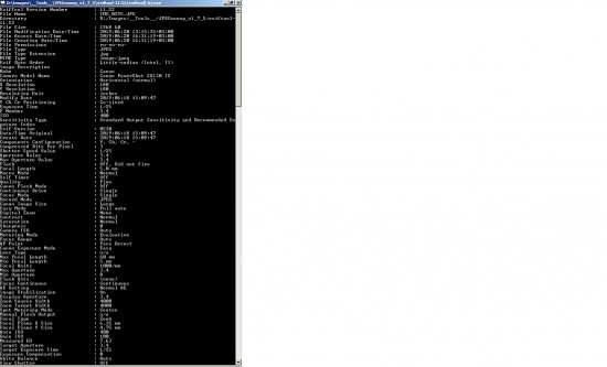

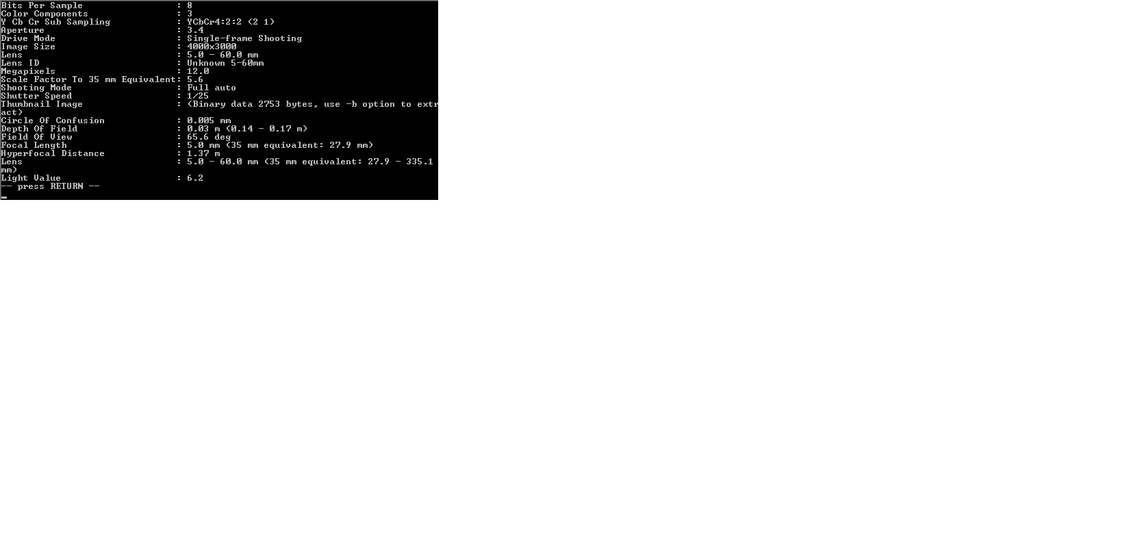

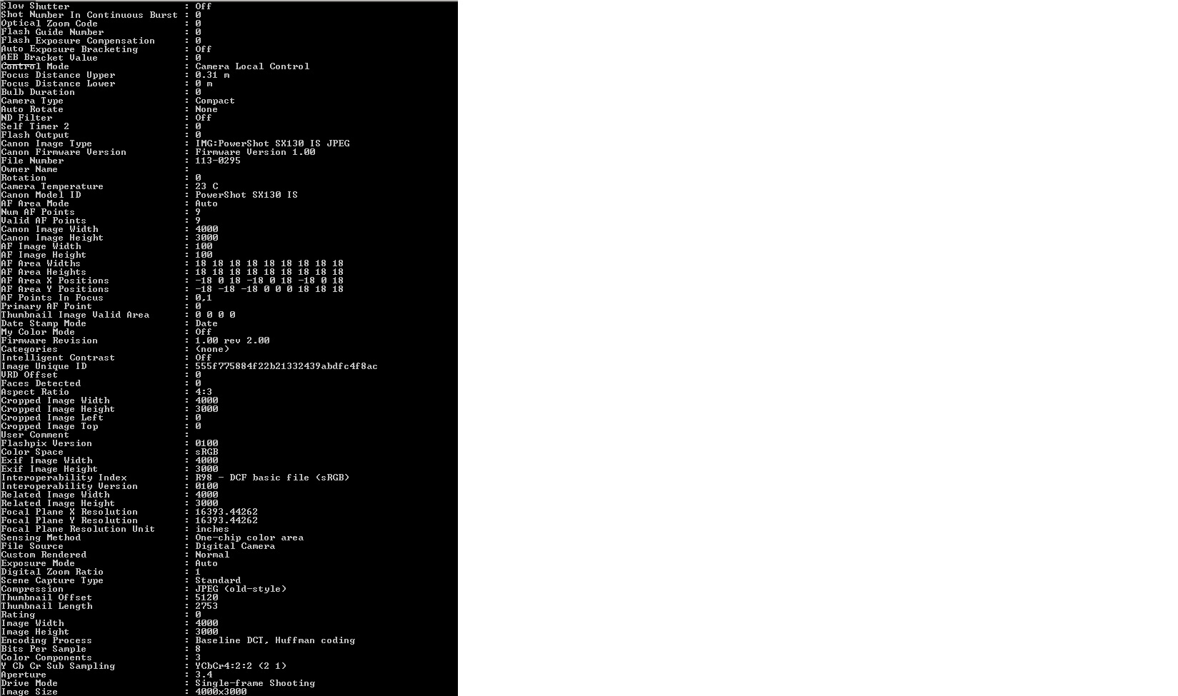

https://www.scantips.com/lights/exif.html
 Post subject: Re: Two Cams & Two Photos - Compare
PostPosted: June 20th, 2019, 10:39
Posts: 2857
HaQue wrote:
already tried that (aware of this tool)
but where is the Lens SN??? am i blind or just cant see it????????
:shock:

according to your pic. this is canon powershot sx130 amateur camera. this camera has NO LENS ID. bec. this has inbuilt lens.
this ID only for interchangeable LENS. it means separate lenses. interchangeable lenses have ROM. which hold LENS ID.
if you using canon interchangeable lens for canon camera it takes LENS ID.
but if you using Nikon lens via canon adaptor, this ID won't work and camera fill 00 00 hex code for that field. sometimes this 00 get as unknown ID.
this kind of all ameture camera using same firmware DATA. all DATA is same.
but interchangeable proffesionl camera needs to align and calliber.like CMOS,lens focal distance for CMOS. if you get 10 cameras which colours are same.so every firmware has defferant values. like hard drive firmware. and they insert the serial number one by one. so about armature camera, they won't waste their time. they use common firmware and same data.
but there is one thing for this kind of ameture camera. normally there are one or two fields inside the menu called "Customer name or custome ID". and another field called "user comment".you can use owner name or customer comment as a unique ID. i think if you have a luck, your camera support this.
if you need, you send the 2 pictures. i will check manually.
