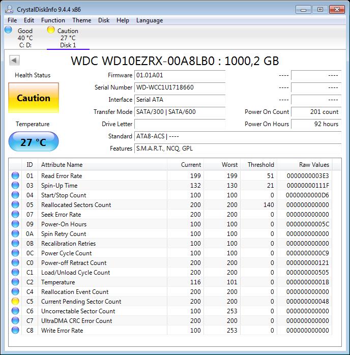

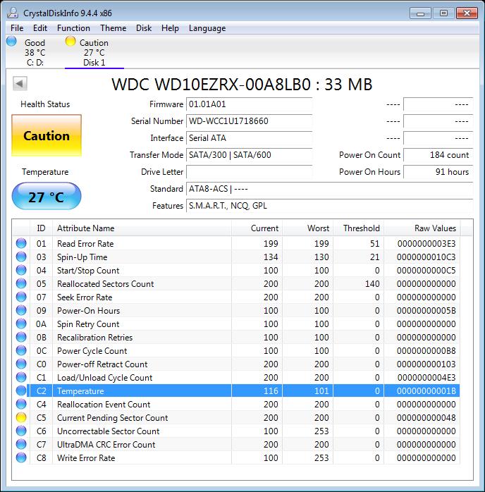

Thank you for your reply.
Yes, I can retrieve a SMART report - see the attachment.
But it says the size 33 MB only. Why?
(The disk WD10EZRX-00A8LB0 is the second one from the list in the report.)

 Post subject: Re: How to recover data?
PostPosted: November 1st, 2024, 18:33
Posts: 17228
GigaByte BIOS bug results in loss of 1TB capacity:
https://www.hddoracle.com/viewtopic.php?f=59&t=150

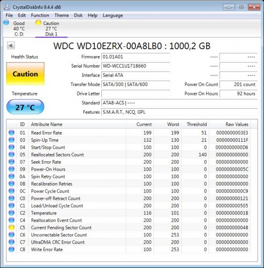

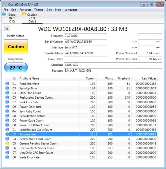

Thank you for your advice.
Now the hard drive reports the proper size.
But the Device manager still reports the hardisk is not initialized and as a result the harddisk is not available in File Explorer.
Is there a solution for data rescue?
Thank you for help

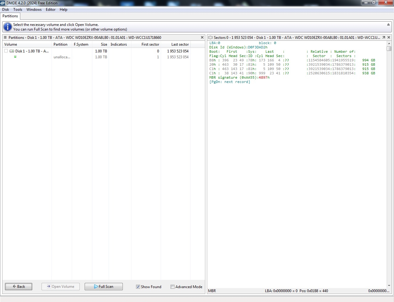

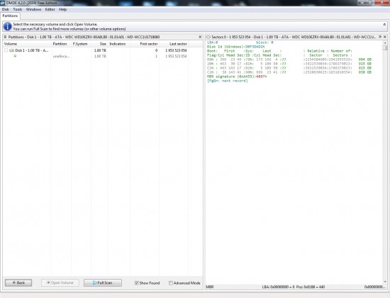

Can you show us the Partitions tab in DMDE?
https://dmde.com/
Did this drive come out of a My Book enclosure?

Please find enclosed the Partition tab.
Is there any chance to rescue the files?
PostPosted: November 11th, 2024, 5:15
Posts: 17228

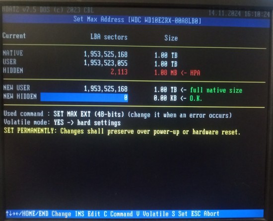

Your drive appears to be encrypted.
Well, you didn't answer my question, but it does appear that the drive was from a My Book.
Be aware that its capacity has now been reduced by 2113 sectors (= 1953525168 - 1953523055). This is Gigabyte's BIOS at work. If you now return the drive to its enclosure, the USB-SATA bridge firmware won't be able to decrypt the data because the encryption key is stored at the end of the drive, and the bridge will be looking for it at the wrong location. You need to restore the full capacity of the drive and hope that the BIOS has not overwritten the key.

1953525168 sectors is the IDEMA standard capacity for a 1TB storage device.
    97696368 + (1953504 x (capacity in GB – 50)) = 97696368 + (1953504 x (1000 – 50)) = 1953525168
Yes, the data is still present, but it has been encrypted by the firmware in the My Book enclosure using a key at the end of the drive. The bridge firmware hides this key from the OS by reserving a hidden area of 65K sectors. Hopefully your motherboard's BIOS has not damaged the important metadata in this area.
Ideally, you should use the original enclosure to decrypt the data. Failing that, there are freeware decryption tools such as "reallymine".

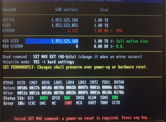

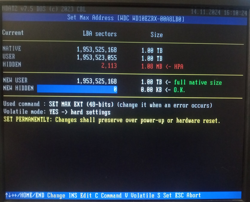

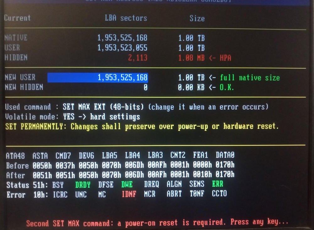

Location: Europe
Thank you for the explanation.
Please find enclosed pictures of my harddrive.
Picture Before.jpg is is before I used S command from Hdat2 program.
After.jpg is after that S command was used.
So, if I understand correctly, HPA must be removed and the files should be renewed.
Is is so?
Does it mean , HPA is still present, because the Diskeditor reports smaller size of the harddrive?
Thank you for reply
PostPosted: November 14th, 2024, 17:54
Posts: 17228
Maybe your BIOS is reverting the drive? Can you disable Express Recovery in your BIOS setup?
