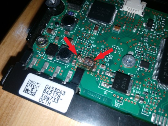

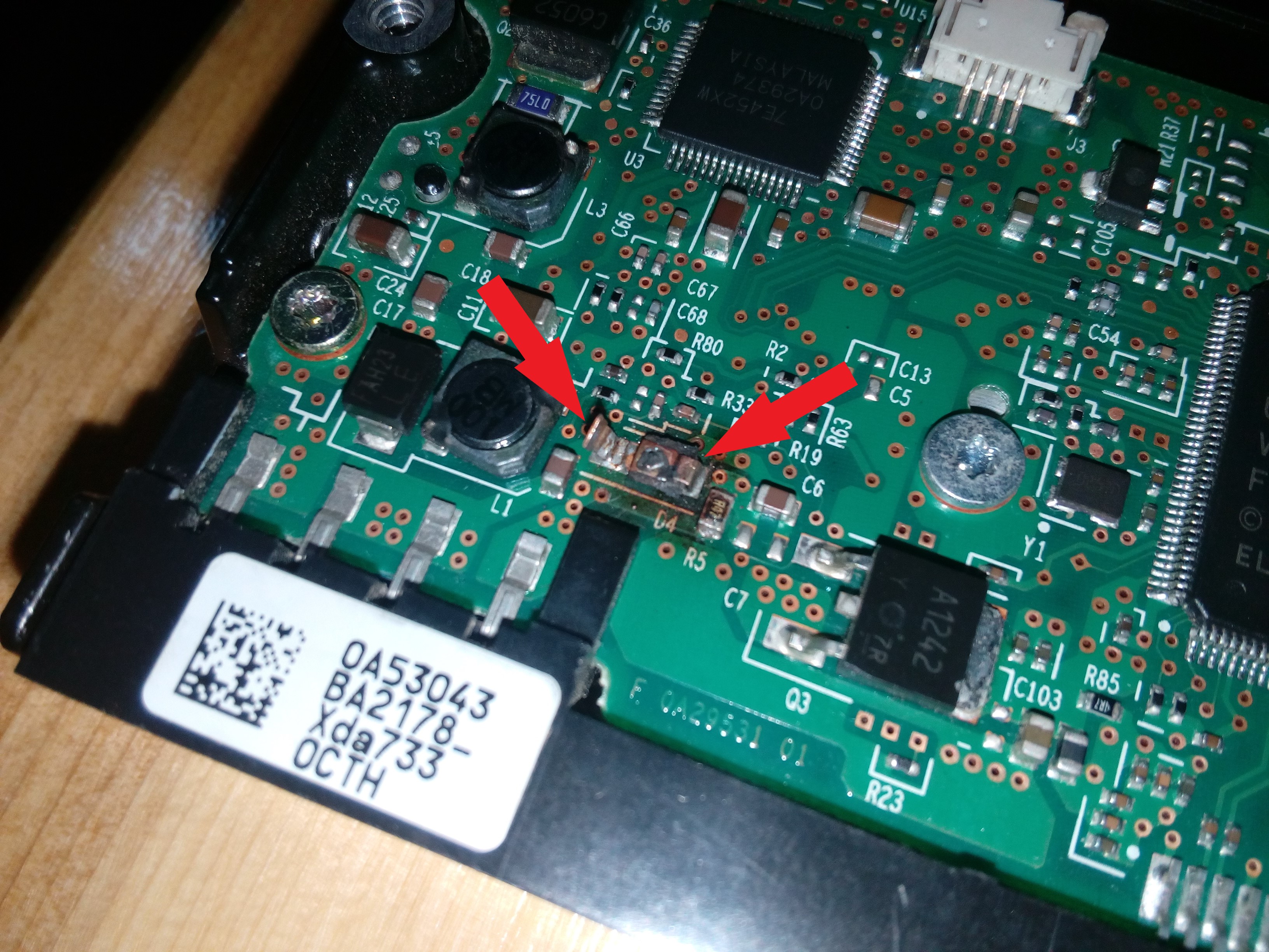

What's wrong with the original PCB?
 Post subject: Re: Replacing PCB on Hitachi HDT725025VLA380
PostPosted: May 30th, 2020, 15:32
Joined: May 30th, 2020, 14:18
Posts: 10
Location: Serbia
PostPosted: May 30th, 2020, 15:53
Posts: 17314
That's the 5V TVS diode. It appears that your drive sustained an overvoltage on the 5V input. Hitachi drives aren't very well protected, so there is a risk that the preamp is damaged.
Do you have a multimeter? Can you measure the resistance of the diode, D4, and the adjacent resistor, R5?

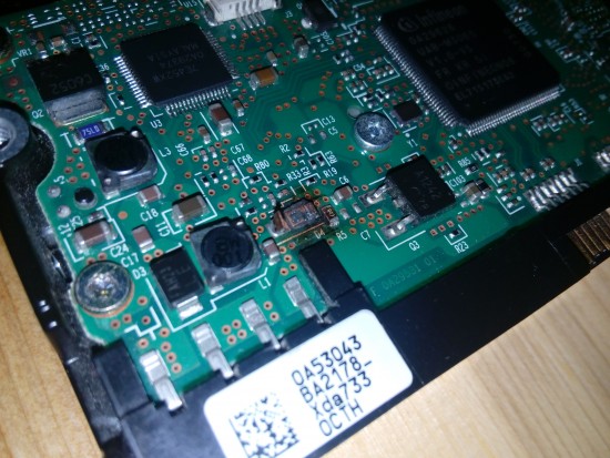

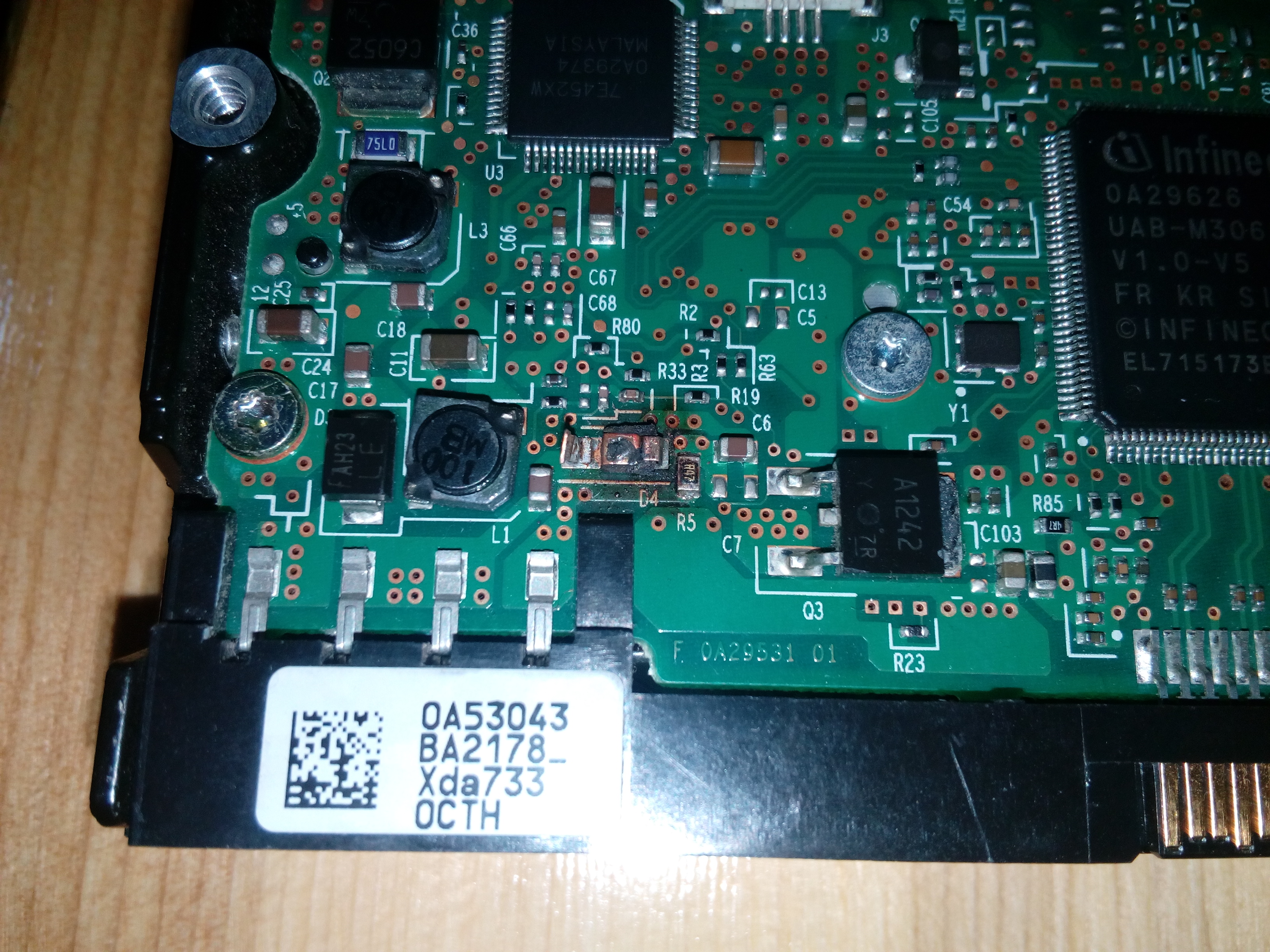

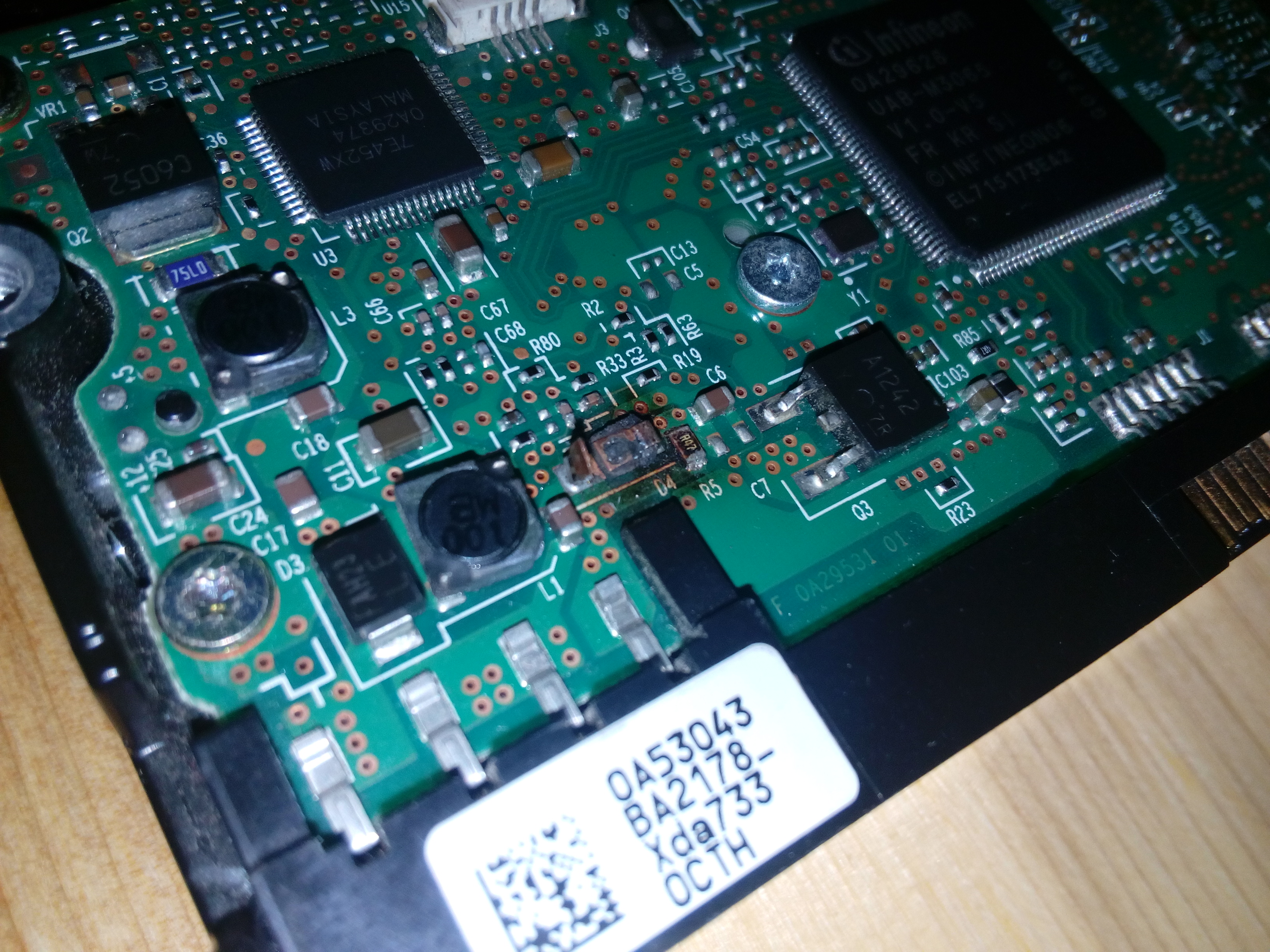

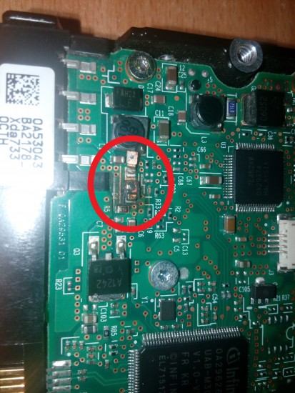

What i meant when i said:
stefax2001 wrote:
Yes PSU shuts down when i connect contacts of broken diode.
Was this:
File comment: Top plastic part of D4 is melted.
PostPosted: June 1st, 2020, 19:53
Posts: 17314

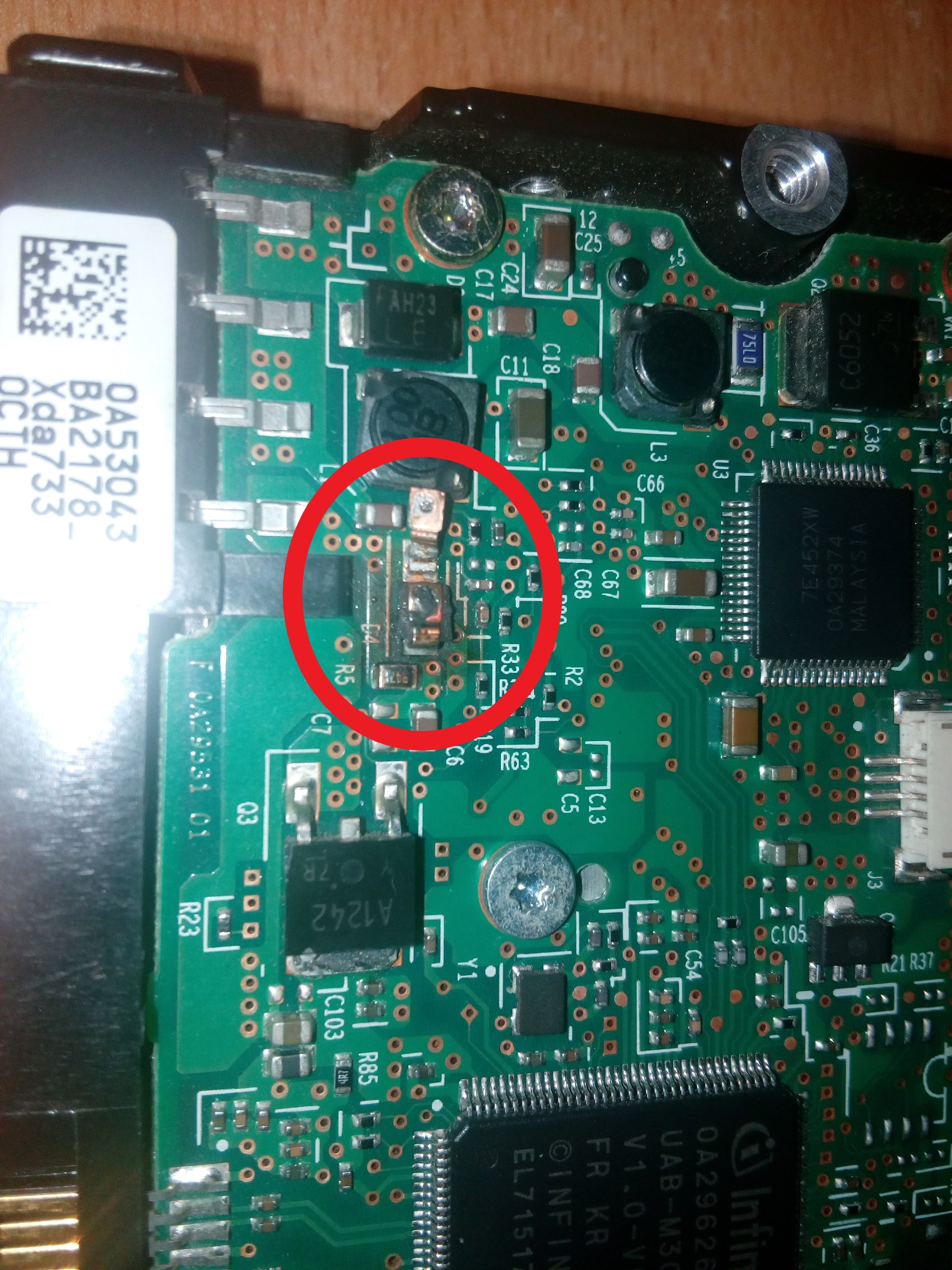

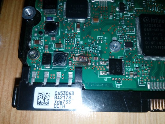

Your statement implies that you connected a PSU to the diode rather than to the HDD, in which case it makes no sense. Or do you mean that you "reassembled" the broken diode and then reconnected the HDD to the PSU???
Whatever you did, your latest measurements indicate that the diode has gone open circuit, and resistor R5 is now also open. IIUC, this resistor is in series with the 5V supply to the preamp, so there is a real possibility that your preamp is shorted. You can test for this possibility by measuring the resistance between ground and R5, and then comparing the result with the PCB on and off the drive.
It goes without saying that you should check the 5V and 12V outputs of your PSU. Obviously there was an overvoltage on the 5V output, so either the PSU is faulty, or you have used the wrong modular cable.
PostPosted: June 2nd, 2020, 10:43
Posts: 10
Location: Serbia
I normally connected PSU to HDD with molex and then "reassembled" diode.
When you said "PCB on and off the drive" you mean literally disassembling PCB from HDD?
Anyway i got -1003Ω for both measurements on and off.
I already checked PSU and got: 5.27v and 11.70v
PostPosted: June 2nd, 2020, 15:33
Posts: 17314

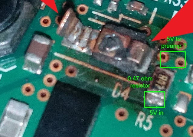

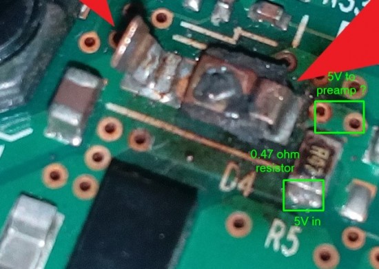

The resistor should have a value of 0.47 ohms.
I would measure the resistance to ground at the preamp end, if you haven't done so already.

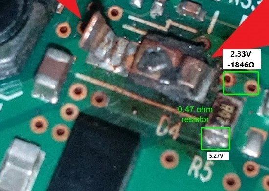

I got this.
PostPosted: June 2nd, 2020, 19:44
Posts: 17314
You can try a donor PCB, but be prepared for a bad preamp, in which case you may be wasting your money.
