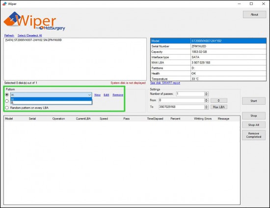

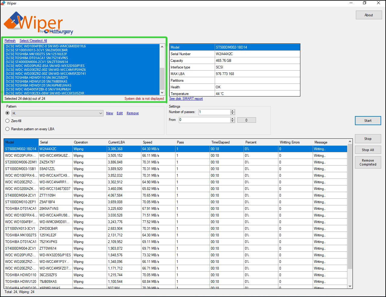

We decided to support the data recovery community by providing a free version of Wiper by HddSurgery (V2.0).
Wiper V2.0 is designed for fast, controlled, and secure data erasure across HDDs and SSDs. It performs full overwriting of all user-accessible areas using zeros, random data, or custom patterns, ensuring complete and irreversible data removal. The software is optimized for speed and reliability, with support for simultaneous operation on multiple devices, making it ideal for batch workflows in professional data recovery labs.
In addition to secure wiping, Wiper can write custom patterns that integrate with File Lister, allowing problematic sectors to be clearly identified during file list generation. This helps recovery labs review results more efficiently and enables customers to validate extracted data with greater confidence.
Wiper also provides detailed technical insights for each connected device, including model, serial number, interface type, maximum LBA, drive health status, partition layout, temperature, and S.M.A.R.T. data (for ATA drives). During operation, real-time status information such as progress, current LBA, write speed, number of passes, and total duration is displayed, ensuring full transparency and precise control.
You can download it from our website here:
https://hddsurgery.com/wiper
We’d love to see how Wiper V2.0 can support and streamline your workflows in professional data recovery labs. If you have any feedback or questions, please don’t hesitate to reach out. We look forward to supporting your work!
