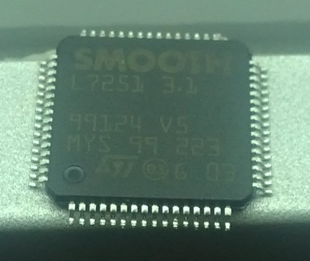

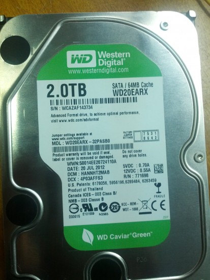

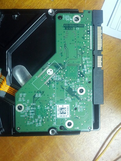

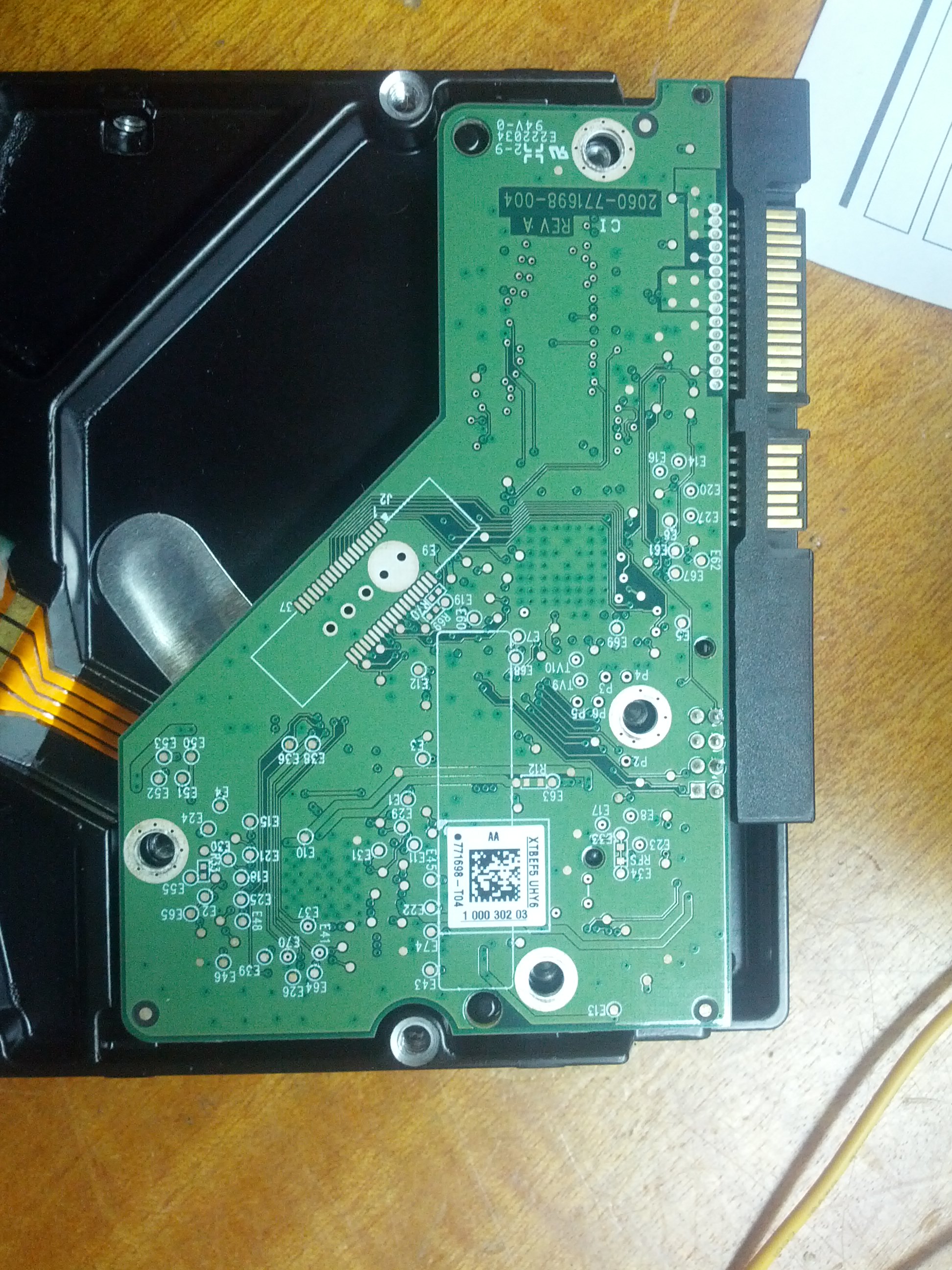

My HDD just died and I checked that the motor controller was burning hot so i order a new one that was the same model and replace it but after that I have no partition.
I did not change the pcb, only the chip.
Can anybody please help?

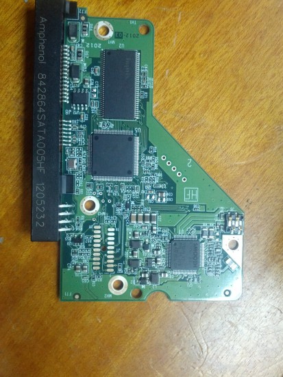

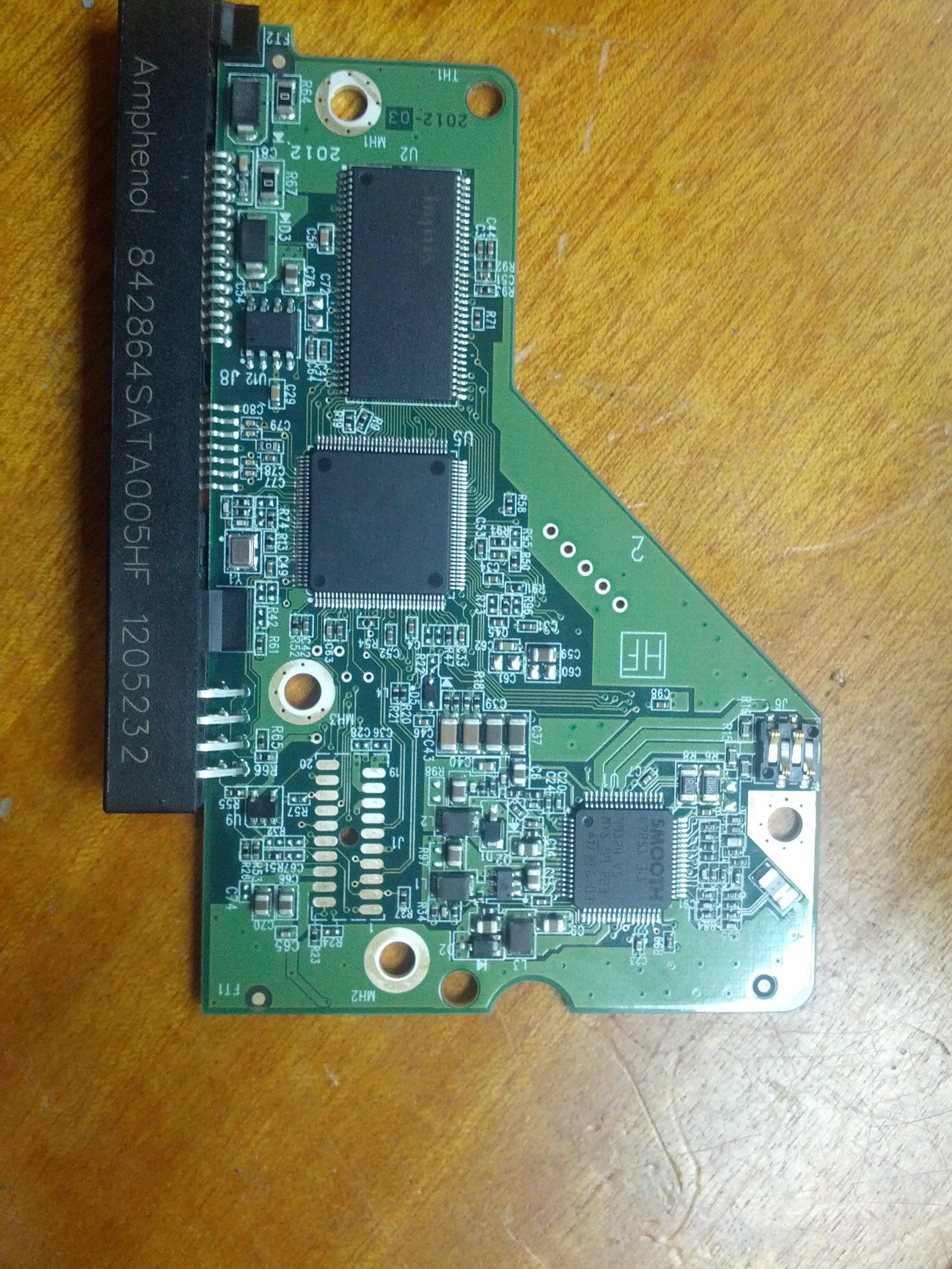

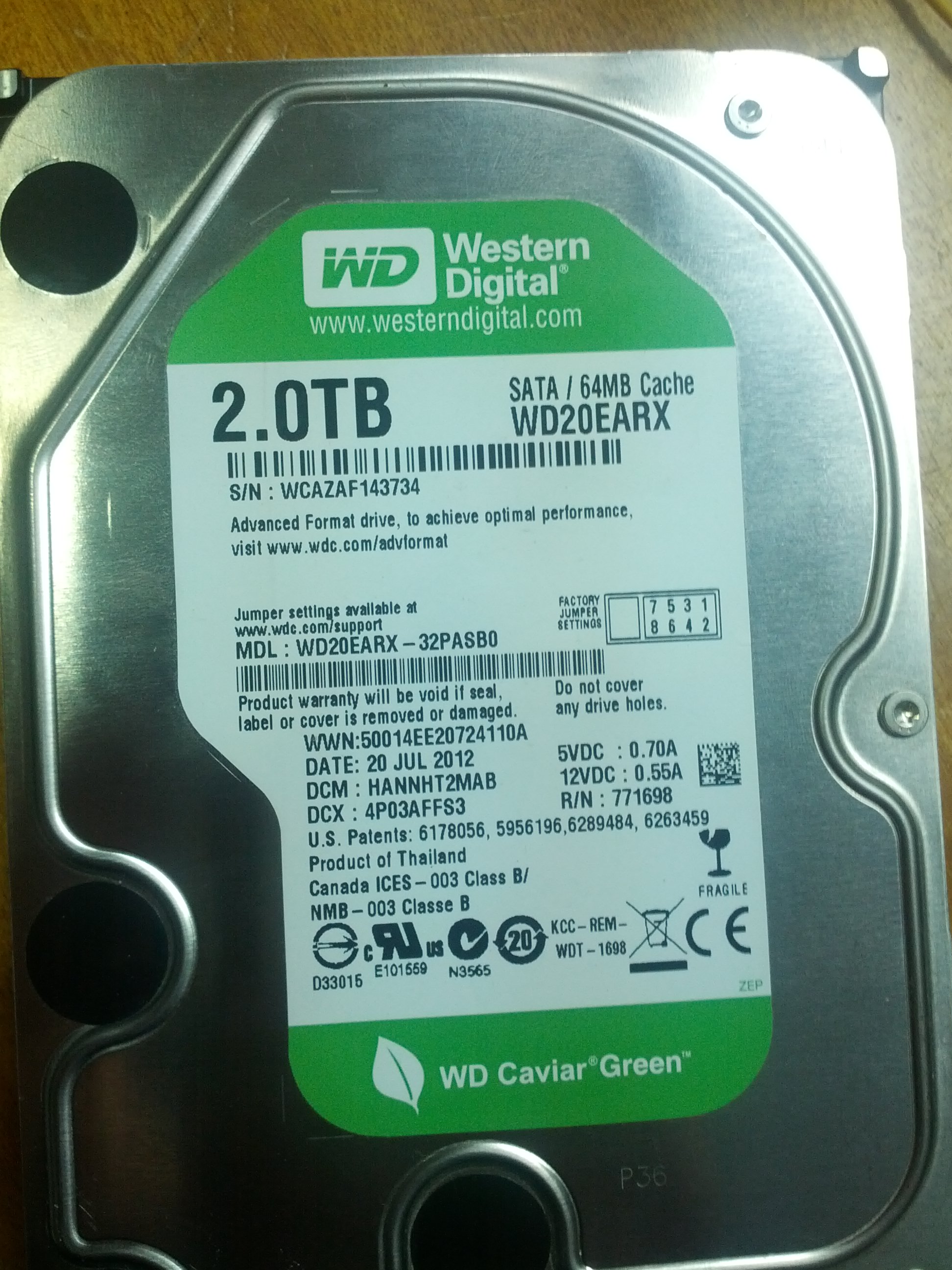

Which chip was it? post pics of the PCB both sides and specify model numbers of the drive.

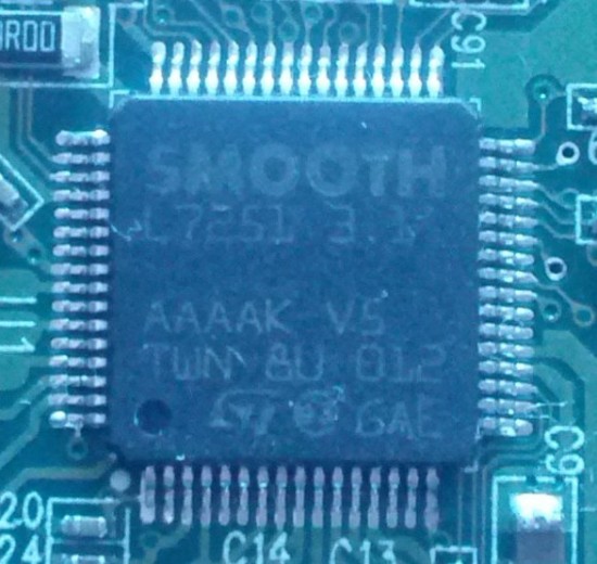

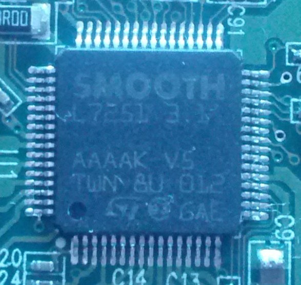

The chip was a smooth l7251 3.1
The disk spins and identifys but says unknown partition

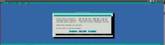

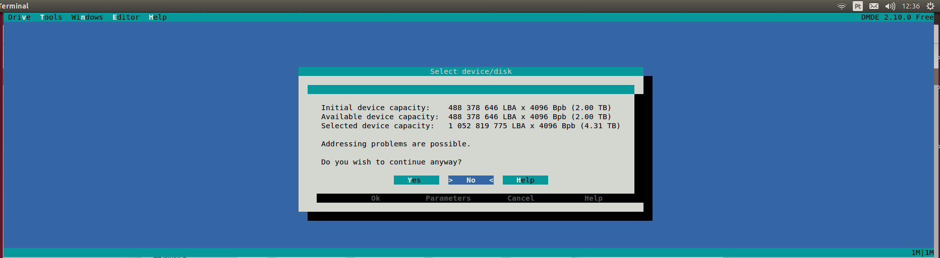

Does the drive identify itself with its full capacity?
Can you show us the contents of sector 0 with a disc editor (eg DMDE freeware)?

shows this...

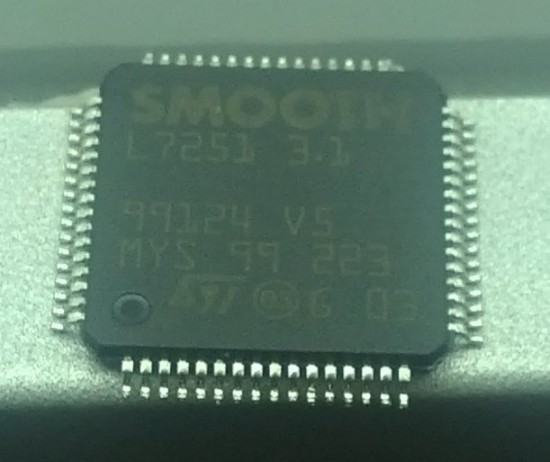

New and old chip

It appears that the drive is OK and that you have installed it in a USB enclosure that is configured with a 4KB sector size. However, the serial number of your drive doesn't bring up a My Book product at WD's warranty verification URL. Therefore I'm wondering what kind of enclosure you are using, and whether the drive was originally installed inside your computer.
Could we also see the hexadecimal data in sector 0? (Select Mode -> Hexadecimal).

It's Working
Thanks a lot for your tips
I was using a usb adapter to connect to PC
I connected via SATA and voulá, everything was working again.
