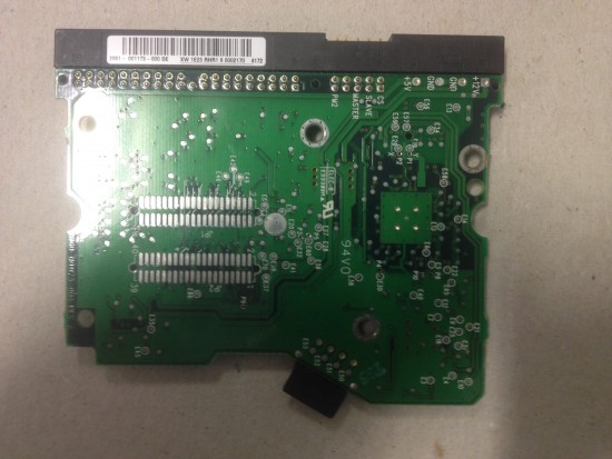

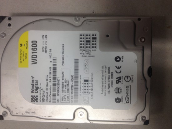

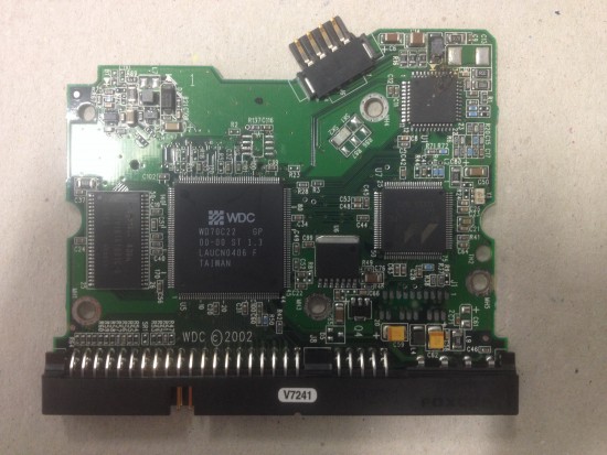

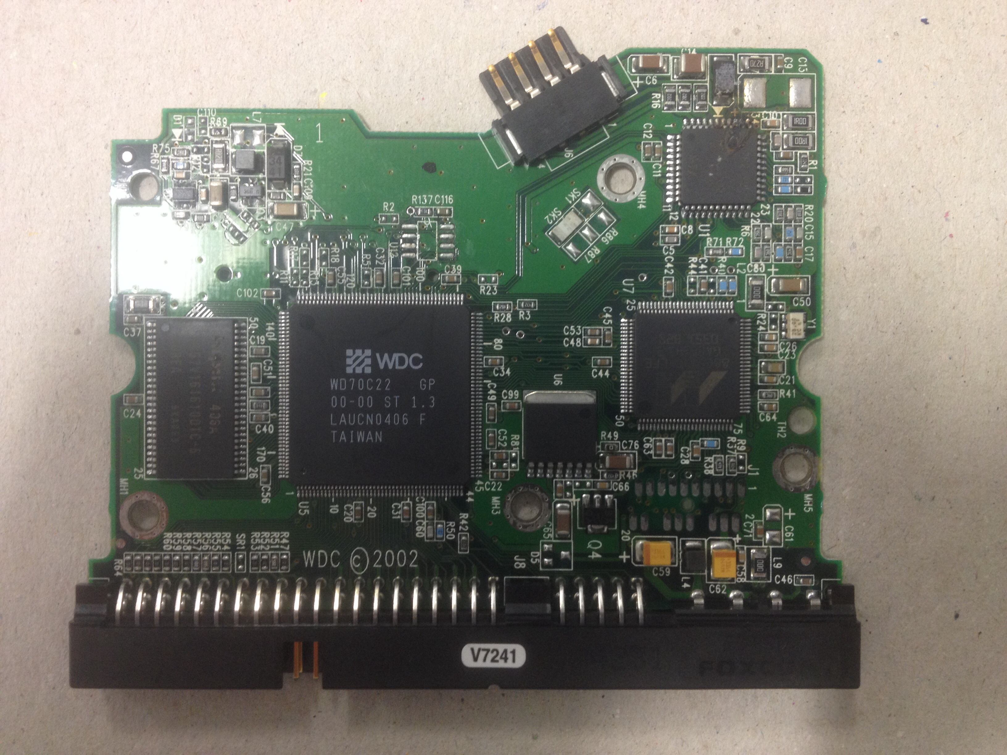

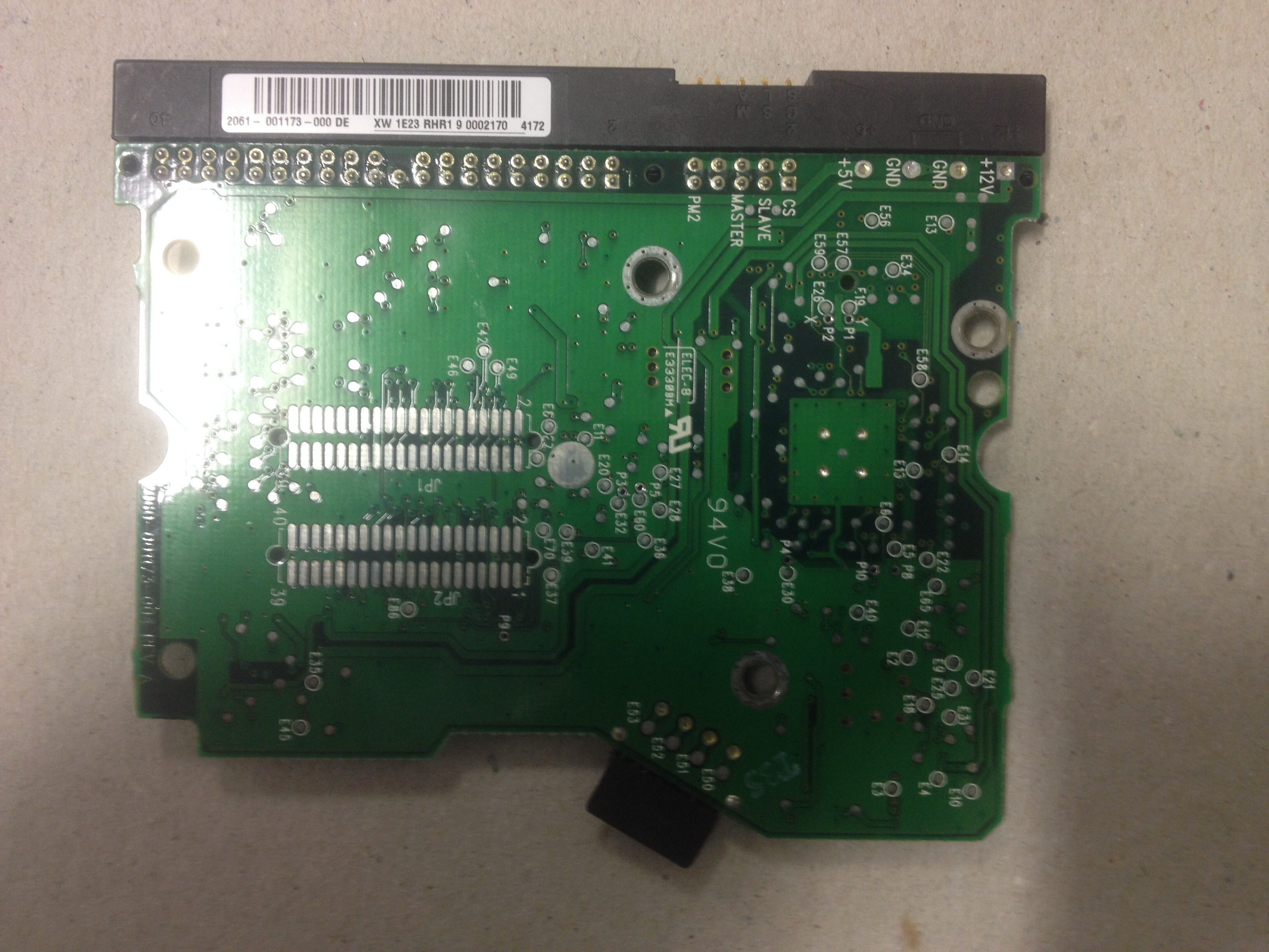

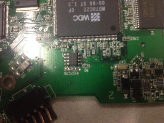

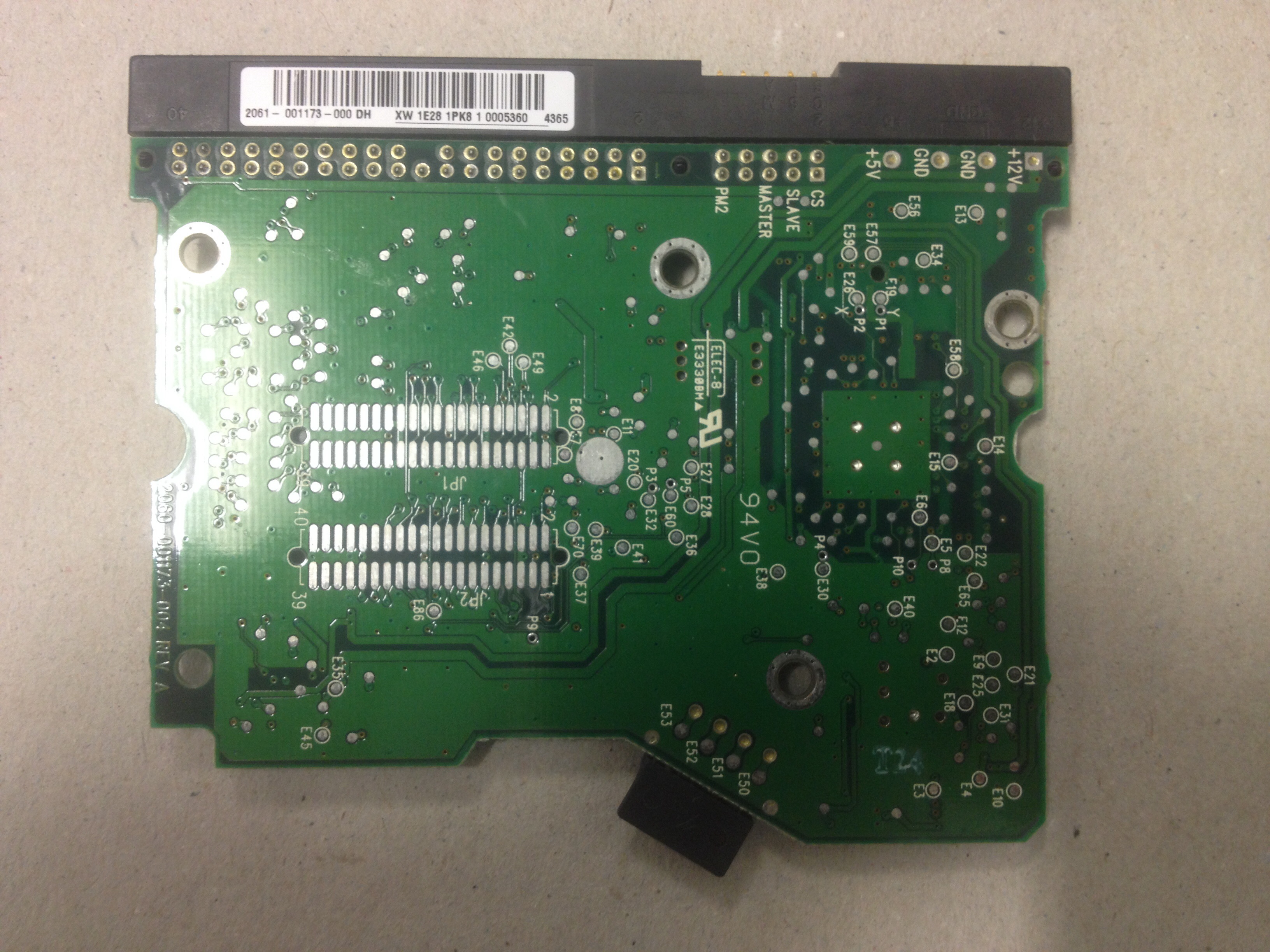

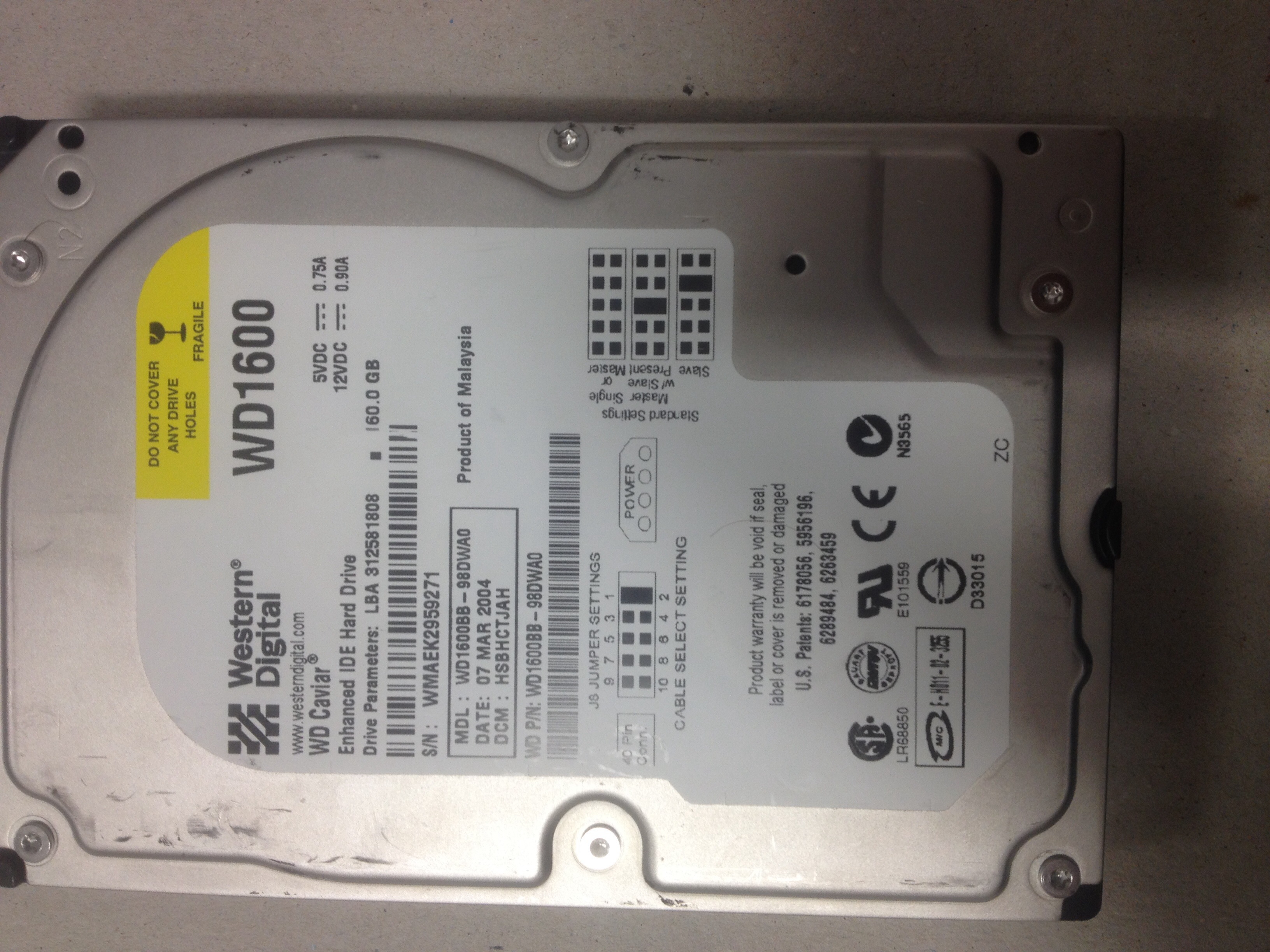

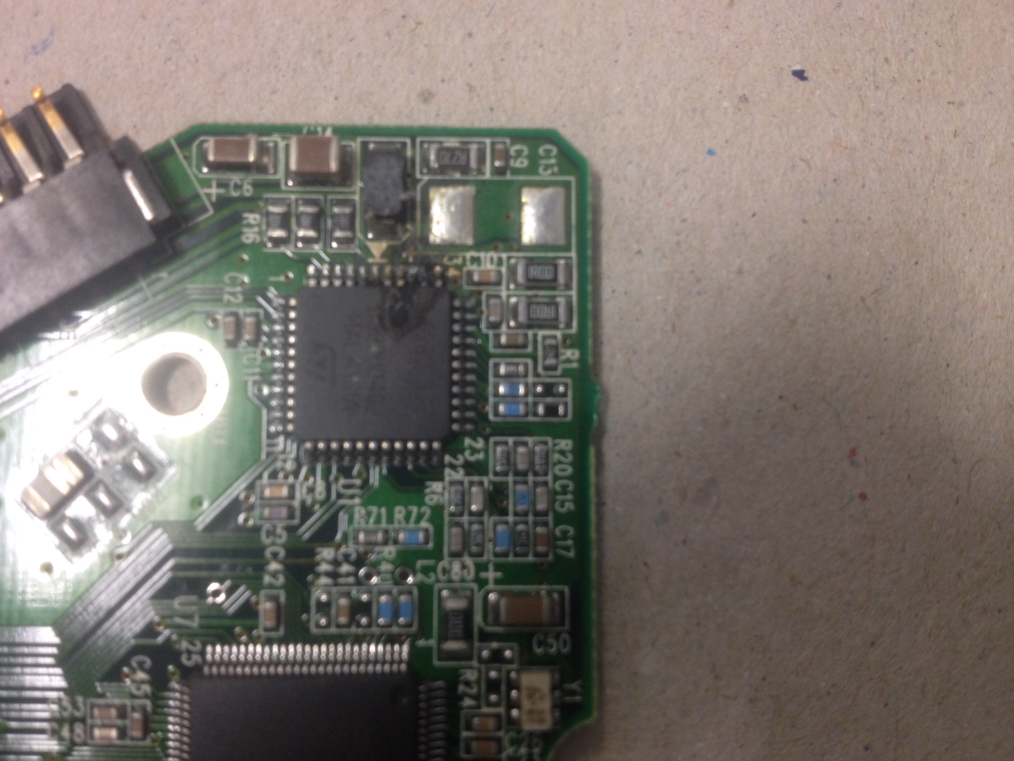

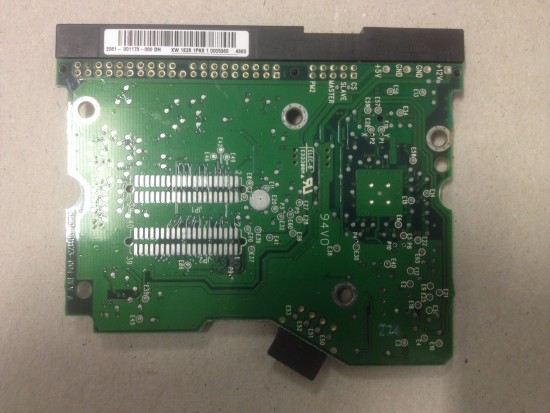

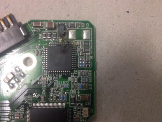

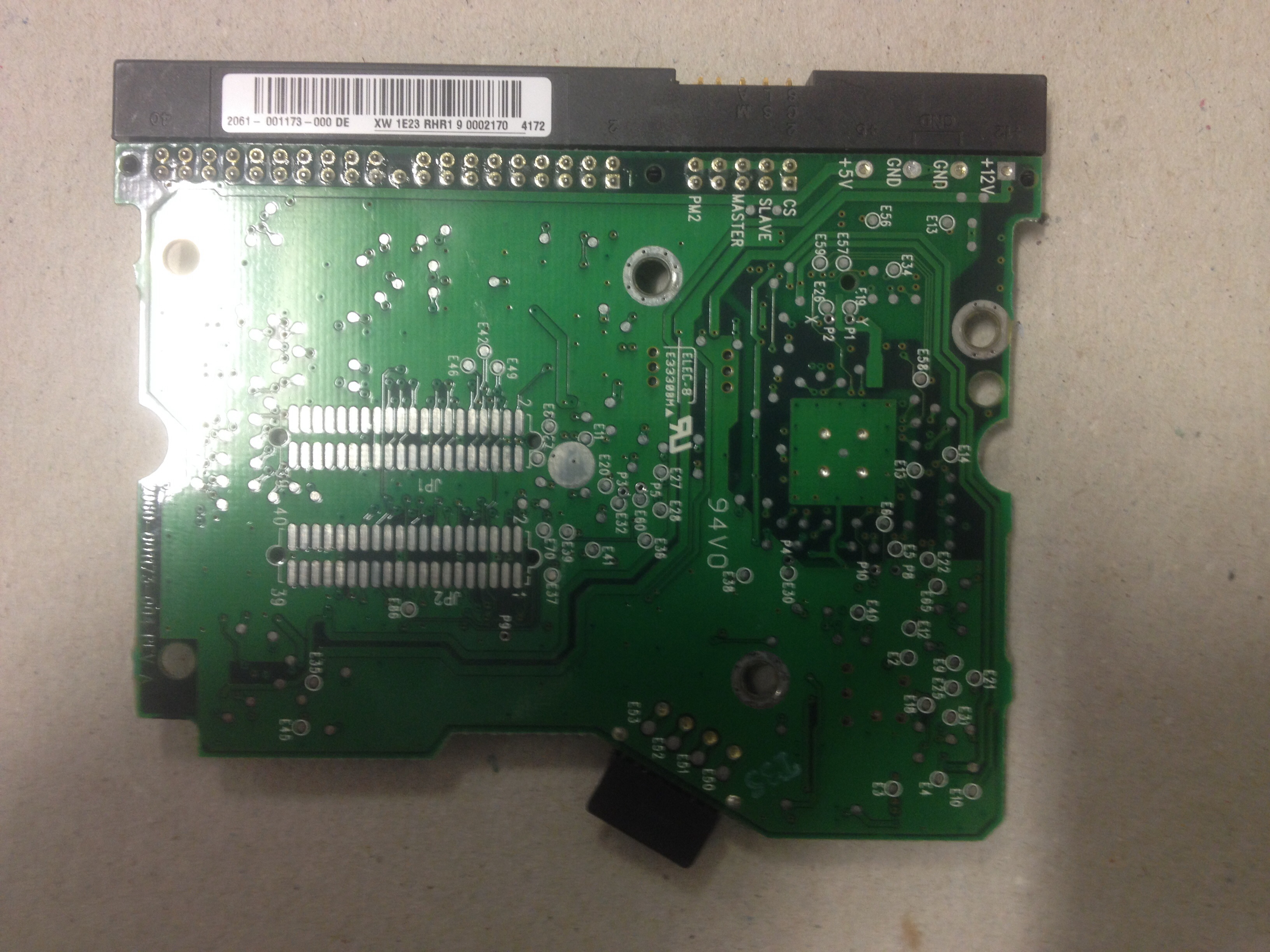

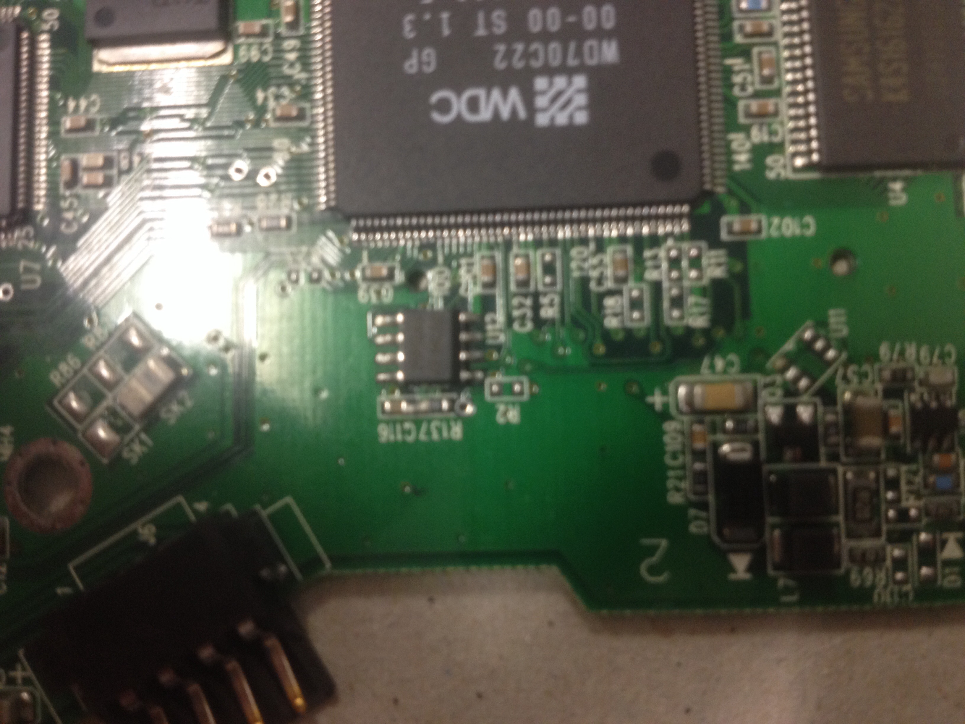

I'm hoping someone can help me. I think I may be at the data recovery company stage but I may be missing something. The hard drive was in an external enclosure and after a pc move to another room I must have accidentally hooked it up to the wrong power supply as I could smell burning and the drive wasn't spinning up. I quickly switched it off and after removing the pcb seen that the u1 chip was fried. After doing some research I purchased a replacement pcb online and I'm sure that all the numbers that need to match do. I then had an electronics shop do the u12 swap. I fitted the new pcb, connected it to the external enclosure and fired it up. Nothing happened, no spin up or noises of any kind. The drive wasn't recognised in windows. I connected it directly to the pc internally but exactly the same outcome. If I hold my ear really close to the drive when it's powered up I can hear a faint buzzing sound and the u6 chip gets really warm very quickly. I have attached pictures of the hard drive, old burnt pcb, new pcb etc. Any help would be greatly appreciated. Thanks

 Post subject: Re: Wd caviar wd1600 not spinning up after pcb and u12 swap
PostPosted: December 5th, 2014, 13:50
Use search function with keyword "preamp".
PostPosted: December 5th, 2014, 17:31
Posts: 17314
Measure the resistances between each pair of motor terminals.
PostPosted: December 5th, 2014, 19:23
I agree. I think what Fzabkar is saying is that the drive likely has internal issues, possibly heads stuck to the platters.

Cribbyrhymes wrote:
I can work a multimeter but where are the motor terminals?
There are 4 pins connecting the motor to the PCB. The resistance between each pair of terminals on the motor (not on the PCB) should be of the order of 1 - 2 ohms.

If the motor is OK, then you may have a stiction fault.

Ive measured the resistance across the motor terminals on the HDD with the following results
1-2 = .001
1-3 = .001
1-4 = .001
2-3 = .002
2-4 = .002
3-4 = .002
Does this mean that the motor is broken?
